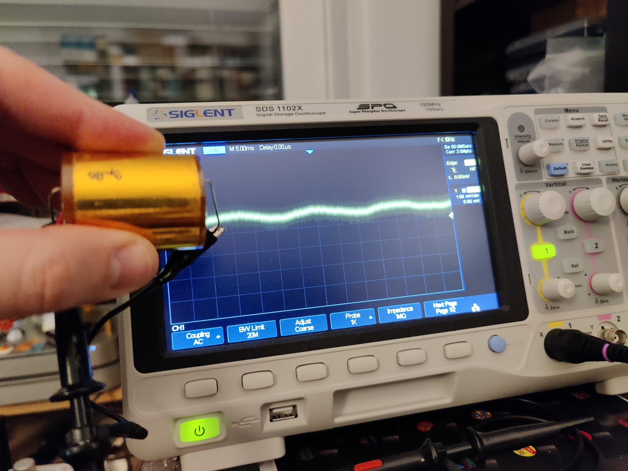

Alright, time for an update.
I determined the orientation of the outer foil by hooking up a scope across each cap and observing the AC pickup from adjacent mains powered equipment. The pics below are taken with identical scope settings, they're just different in how the probe is placed across the cap.
With these caps the effect is quite small, but consistent and repeatable. With the outer foil grounded the signal stays flat, and that's how I determine the lead going to the outer foil.
In circuit, the outer foil connection should go to the point of lower impedance. Used as a coupling cap between stages, that's usually the output of the preceding stage. Used as a decoupling cap, it's usually ground.

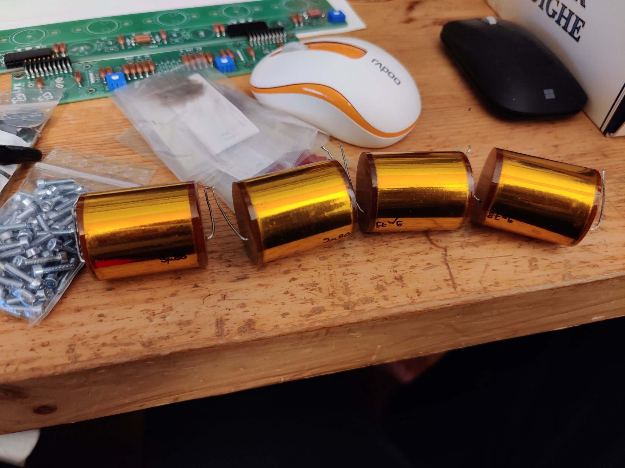

With the caps placed like shown below, the edge of the insulating tape can be felt with a fingernail coming from above (like when trying to find the start of a tape roll), and the outer foil leads are all to the right. In other words, with these four caps, when looking at the side connecting to the outer foil, the insulating tape is wound around the cap clockwise. Small sample size, but still...
Do any of you have similar observations? Y'all think that the outer foil connection can be determined by identifying the winding direction of the insulating tape?
