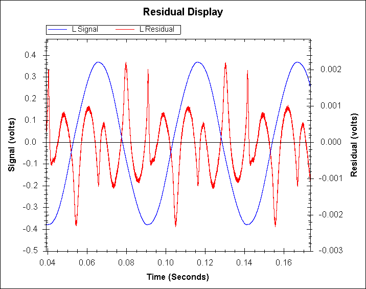

If you don't realize just how awful type II ceramics are, here's a residual plot for one:

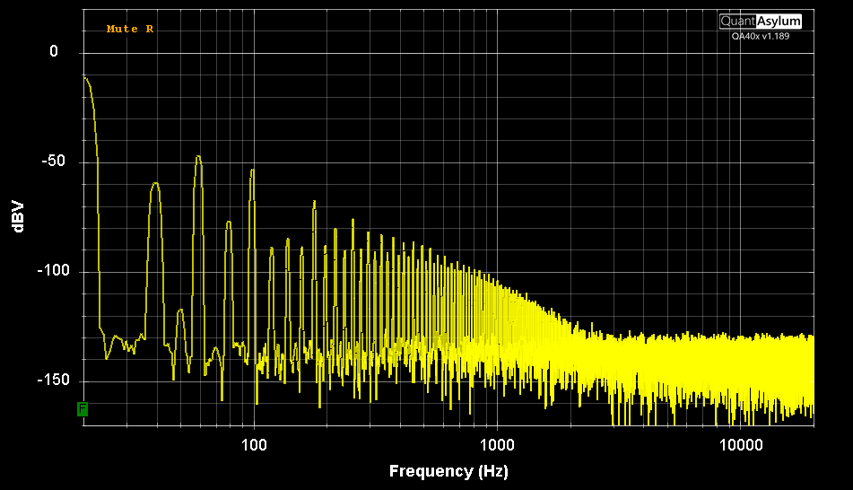

And spectrum for 20Hz excitation:

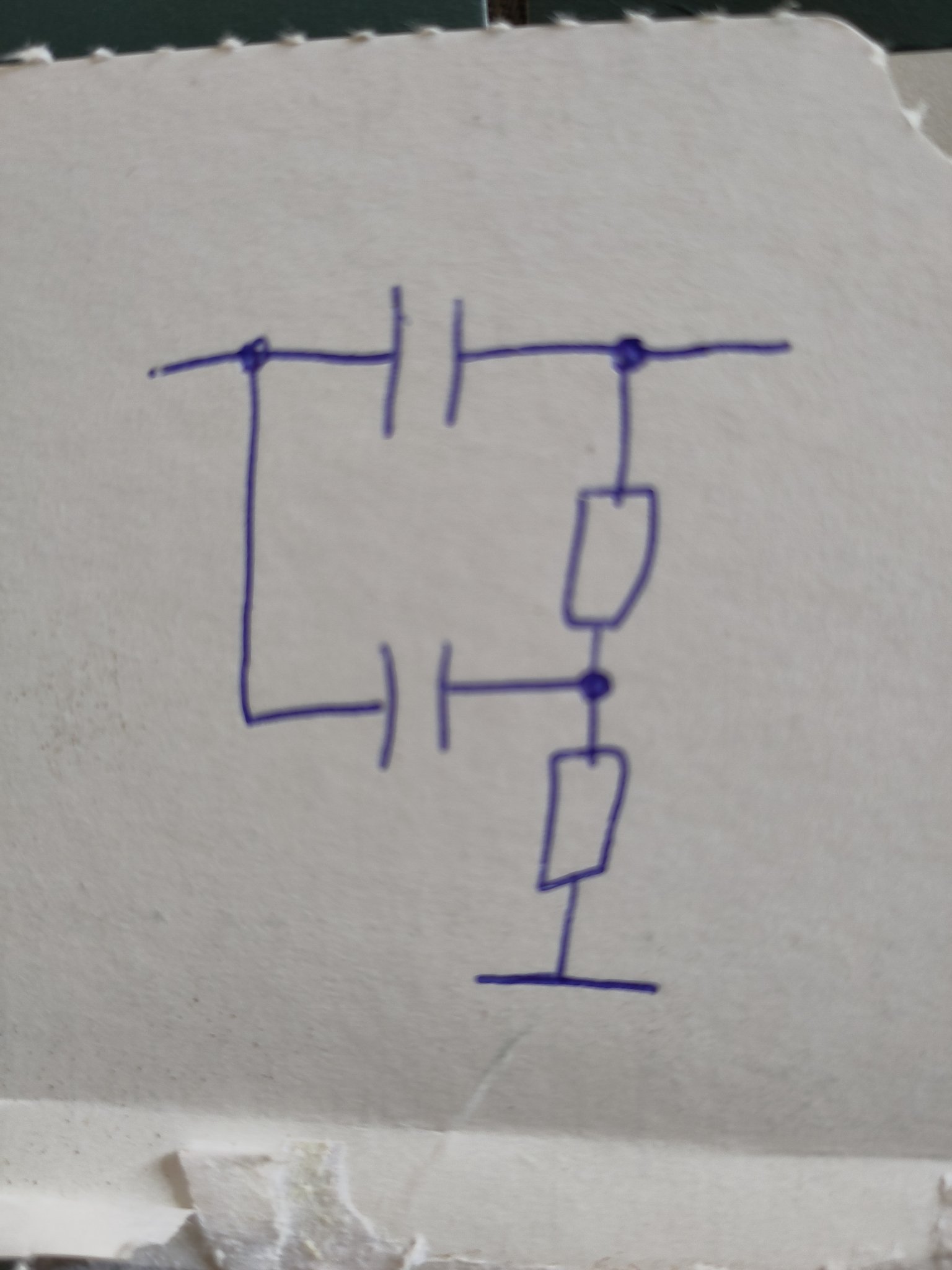

If you have to use class-2 capacitors, you could consider trying something like this.
The AC voltage across the upper capacitor drops with 40 dB/decade rather than 20 dB/decade, which may help to keep the signal small without needing very large time constants. A disadvantage is that you get a subsonic response bump.

Well you can read the residual amplitude as being about 45dB below the signal, that's compared to perhaps 100dB for electrolytic in same situation, i.e. very gross. You don't need to do detailed measurements for very gross! Anyone with a distortion meter will see similar results, but the must important detail is the nature of the distortion is not just 2nd order or 3rd order, but includes something more like cross-over or hysteresis distortion.What I was trying to describe was that it all must be in context and with details. An unqualified distortion residual means nothing. It's nowhere near enough information to be scientific.

Do you force a sinusoidal current through the capacitor and measure the voltage across it?
