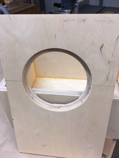

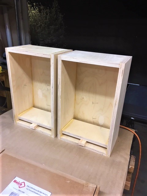

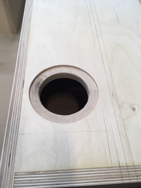

The cabs are just about finished. Have to fit a few parts and seal them up.

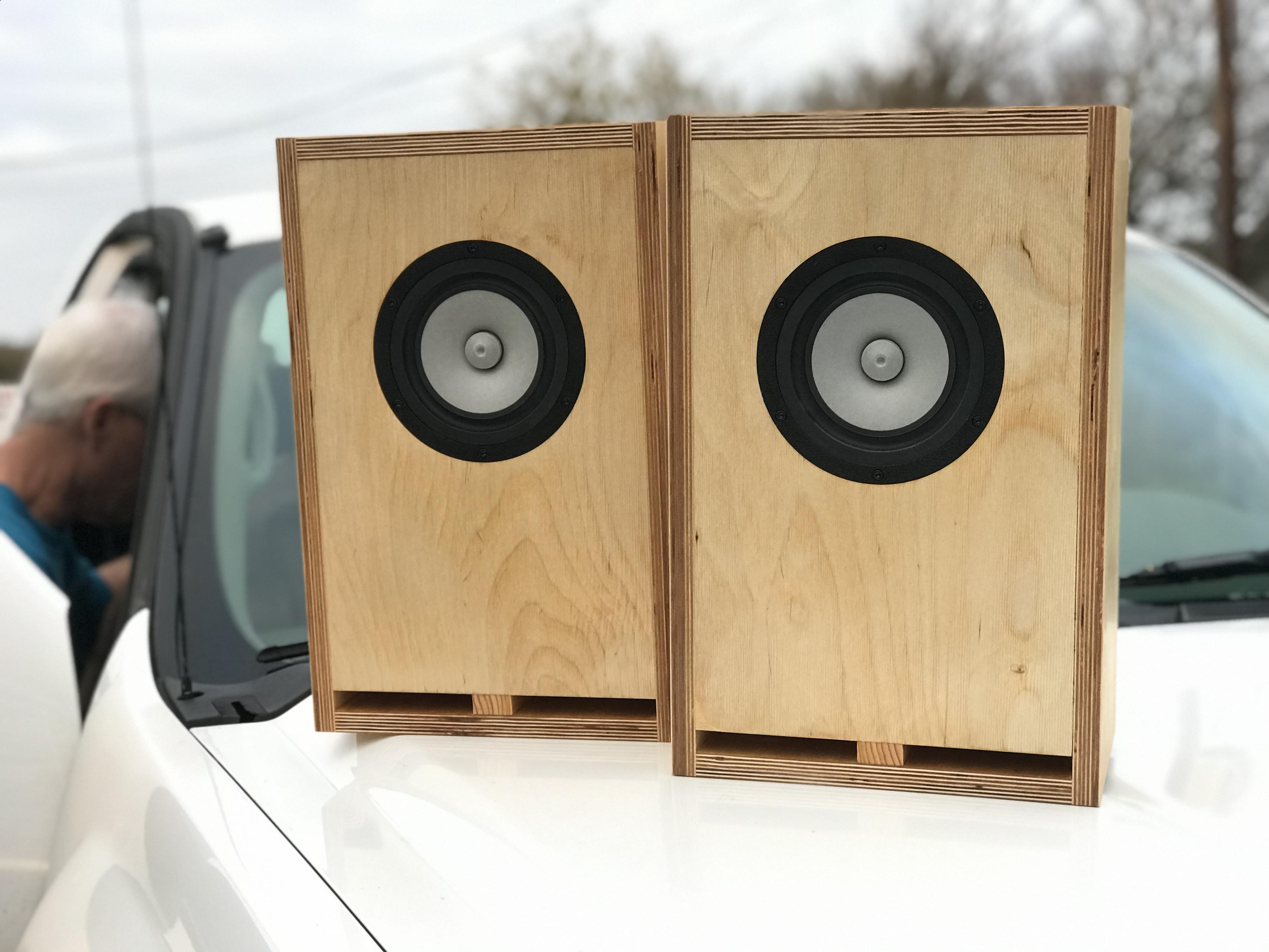

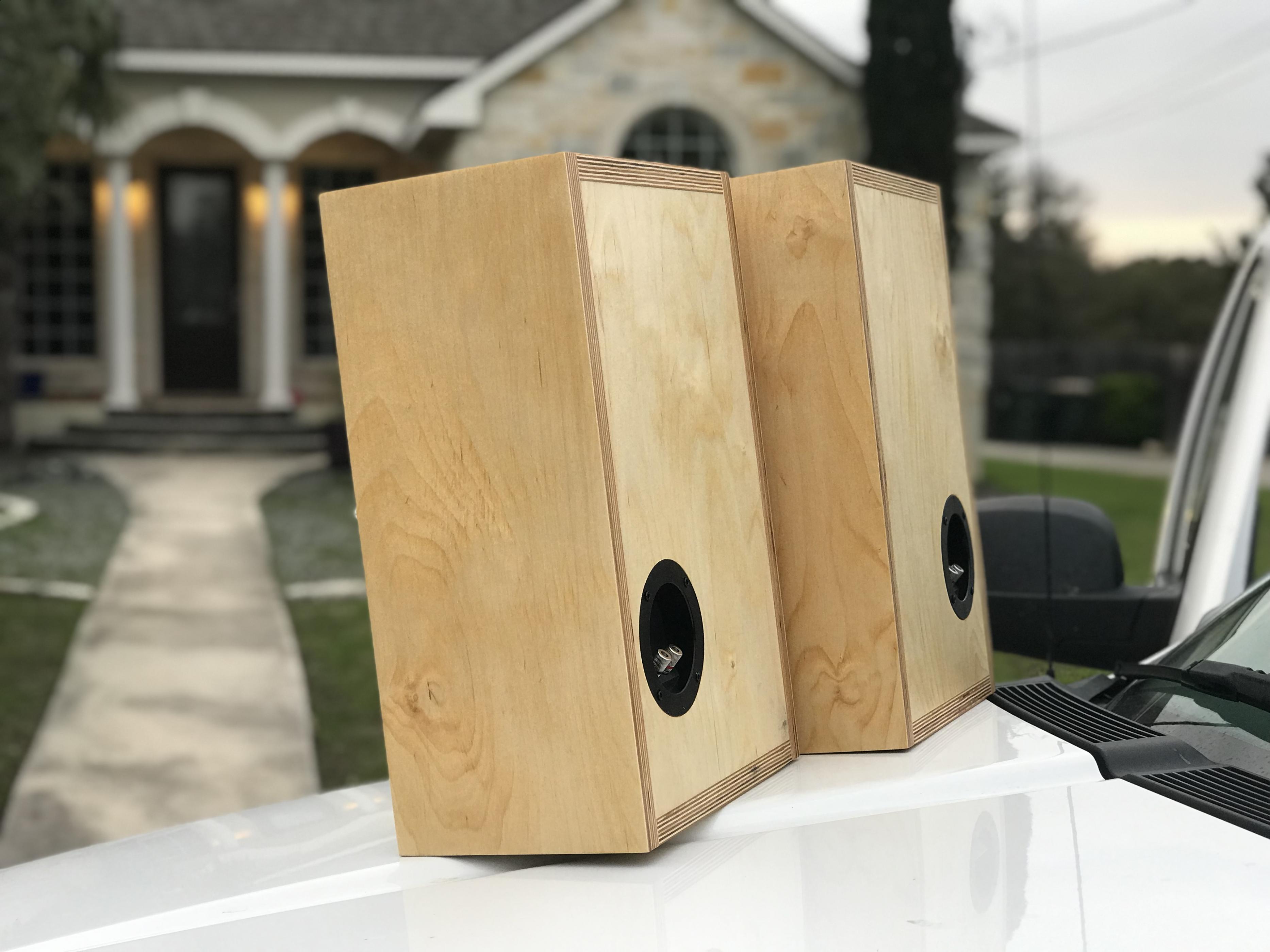

They are in the finish stage now. We did have a listen to them before finishing. They are better than I expected. The Pensil enclosures were good but, the CGR enclosures are great. We tried them in a very large room, about 7' apart and 5' from rear wall. No side walls within 15'. Using a F5/B1 combo the bass was very controlled and was good for a open room. Detail is very good. The off axis quality is really good. Giant sweet spot. You're going to love them.
Yes, nice looking build. Looks like they're made of baltic birch plywood? What did you end up doing for the finish?
My pair of CGRs is in baltic birch ply. I'm planning to finish with Watco Golden Oak Danish oil and a coat of satin polyurethane. Need to figure out how to get the color to absorb more evenly, though.

We used watco danish oil, natural. Sanded them 220,320,400, then applied the oil, 3-4 coats, then wiped before they go tacky. A few days later I rubbed them a bit with soft cloth, then added a few more light coats, again wiped before they go tacky.
Adding poly will make them more durable, if that's needed where you are going to use them. Give the danish oil plenty of time to cure before the poly and I bet it will look great.
I've noticed baltic birch takes finish well after the sanding process I outlined. I will say the first coat or two gets absorbed quickly. I try to flush the surfaces with oil as quickly as I can, keep it wet for the first 15-30 minutes, depending on weather, and it will usually take pretty evenly.
Sometimes I'll even do a coat or two of finish before I make my final cuts and assembly. It can be easier to get them quickly coated and even initially this way. I let them cure for a day or so, then make the cuts and assemble. Just be careful to not get finish on glue edges, or ensure you sand it off well.
This can help face veneer tear-out as well, which baltic birch can tend to do, especially with cross cuts.
