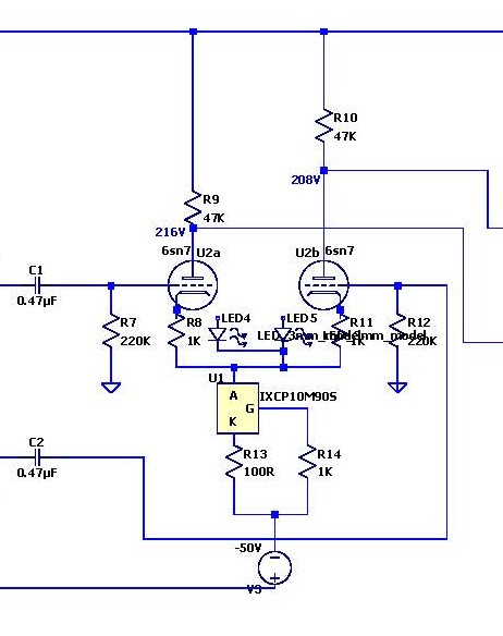

Now with schematic diagram!
Hi everyone,
This is part of the diagram I'm working on right now. I can choose either a resistor or a LED to the CCS from each cathode. Time and science will tell what's best.
Regards, Gerrit

With 1k cathode resistor and CCS you have mixed bias.
The CCS half current flows through the 1k resistor and produces negative voltage on cathode (if the current is enough large).
The 10M90 with 100R bias resistor produces 23.3mA current, IMO is too much.
With 300R the current is 10.2mA.
Try a 10 ohm series resistor right at the drain of the 10M90S.
Adding a ferrite bead right on the drain lead is not a bad idea.
How close is that 1K resistor to the gate lead?
Decoupling on the -50V rail near the CCS?
Can you provide a picture and also measurement of oscillation frequency?

Best audio results when the circuit parameters are set correctly, not the other way round. What frequency is the oscillation?
If the CCS is set for 10 mA each triode will have to pass ~5 mA. Drop across the 47K plate resisters is then 235V. The B+ would need to be 235 + 216, or 451V. What is the plate voltage supply at that point?
Setting the CCS to 20 mA is an impossible situation in this amp.

I know. I noticed some differences in the 3-4-5-6 mA area (per tube half). B+ is 400 VDC (MOSFET regulated and stable within 1V). I tend to use around 4 to 5 mA as optimum.
I don’t know the exact frequency of the oscillations, but some were in the hundreds of Khz. range, causing strange buzz and noise sounds in the audio output.
