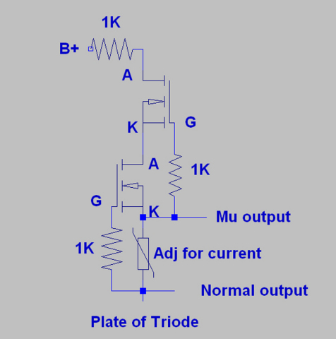

I cannot get my cascoded 10M45S to work. The problem is, whatever the resistor value I put (80-300R), the current stays nearly the same (5-6mA). The circuit is used as CCS for a D3A tube and the target is 25-30mA.
Probably I could have screwed something by putting the two packages on the same heat sink without insulation (drain to drain)? When I did so, the current was quite high (50mA) and uncontrollable by the resistor value. Now when I isolated the 10m45s s, the current dropped to 5-6mA and is still uncontrollable by the current value resistor.
I use 1k for grid stoppers.
I have no problem with 10M45S cascodes. I make sure I have lots of headroom, though, on the order of 90-100V.
By the way, I'm using the "mu output" of the CCS in my 26 preamp and it sounds excellent, in addition to giving an output impedance of ~1500ohms. I don't hear any degradation versus the plate output - if anything it sounds better. The lower impedance allows me to run the tubes directly into the autoformer volume controls and avoid a separate output transformer. Combined with lossy parafeed the low end extension is -3dB at 4-5Hz.

Datasheet for the Supertex part indicates capacitance drops significantly once you get about 20-25V of headroom. In my uses in about 5 different amps, they run just fine with 20V. I would not suggest running them below 10 if you want decent performance. The lower the capacitance, the higher the output impedance at high frequencies.
