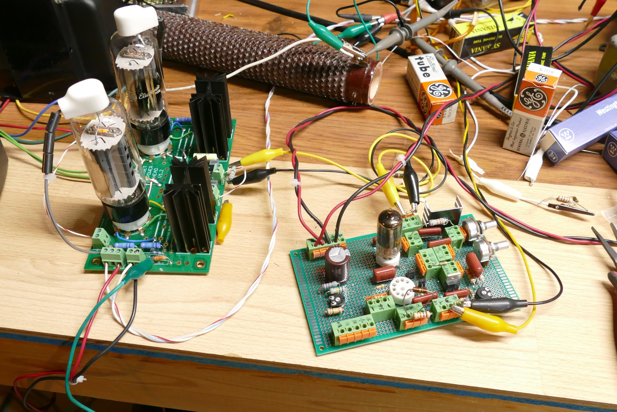

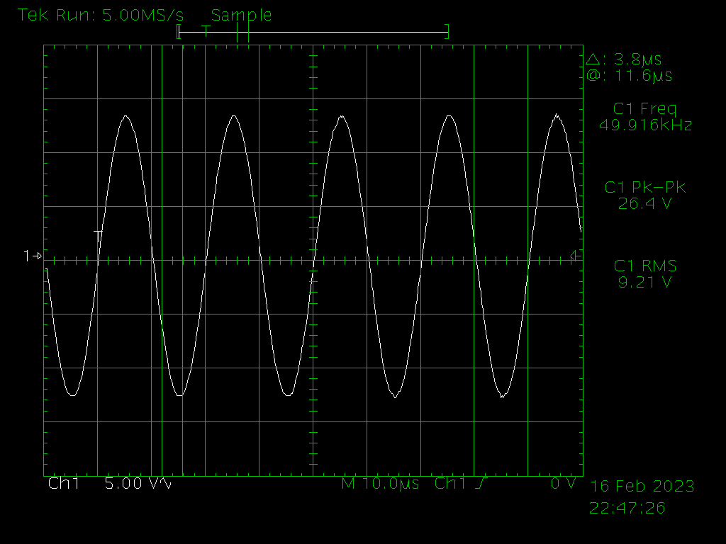

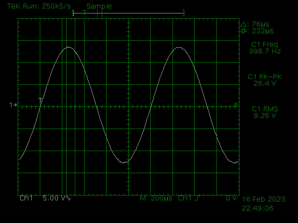

It's been a long time since I had any experiments on the bench and I decided it would be interesting to see what a type 30 could do. So I wired up a simple gain stage with a 10M45 as a plate load and captured a few numbers. Nothing really surprising except for the poor HF frequency response. Later on I plan to use a plate resistor and see how it behaves. Anyhow here's a basic schematic. The filament is lit with DC.

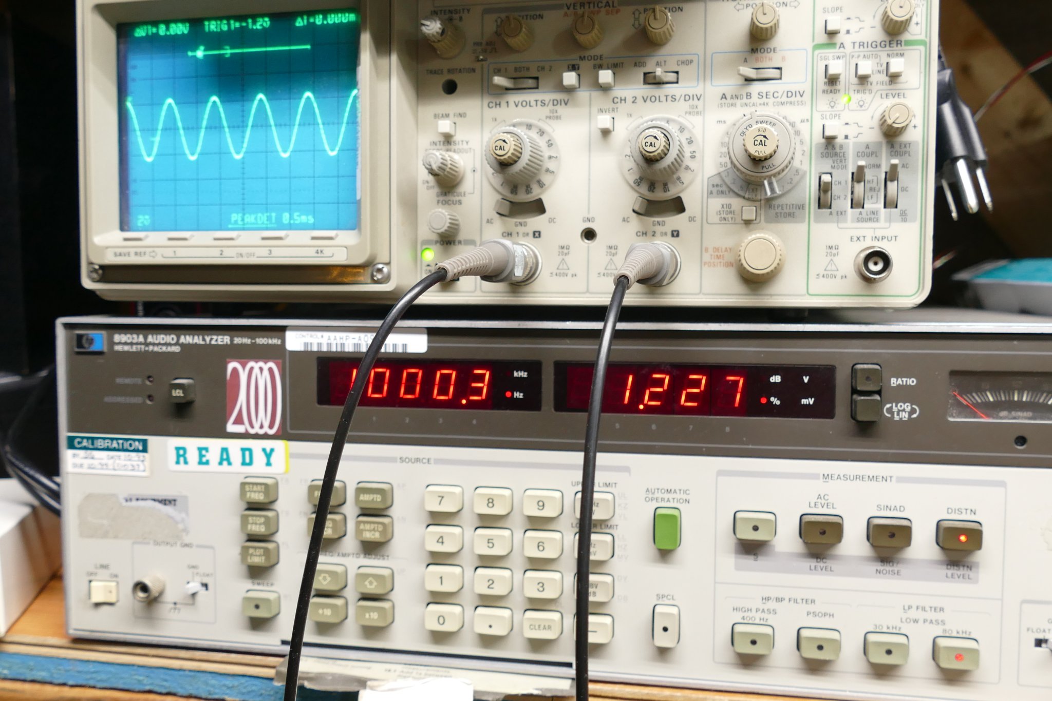

1 volt RMS input
1KHz0.30% THD8.4 Vo
10KHz0.39% THD8.1 Vo
20KHz0.66% THD7.5 Vo

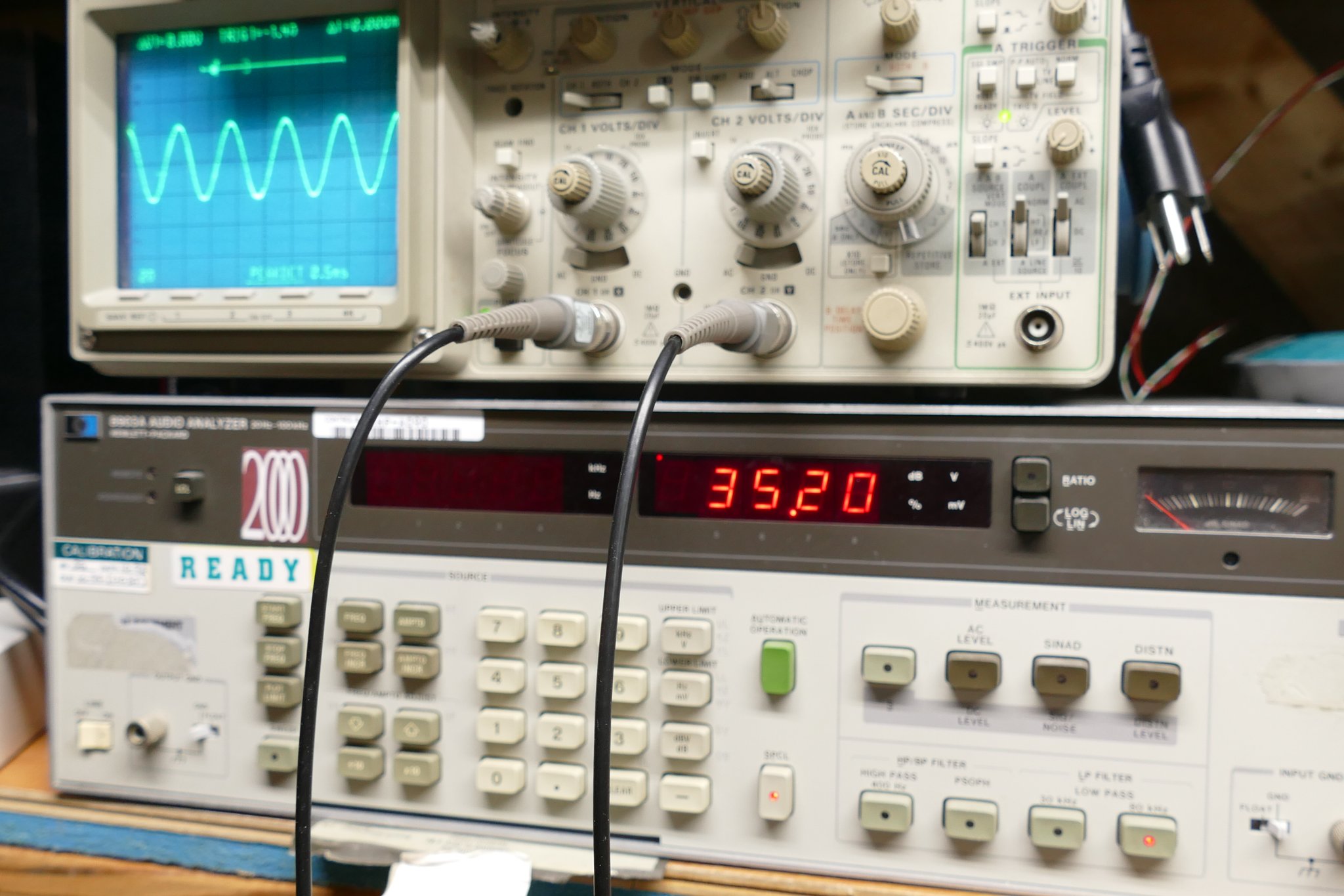

50KHz1.7% THD5.5 Vo
I'm starting to suspect the 100k input impedance of my analyzer is causing the rolloff. While verifying the 50KHz reading I put my bench meter in parallel and it loaded it down further to 5 volts.

Its not the Zin of your analyzer. The Hi Z of your circuit, and the interconnect cable and the input capacitance of the analyzer forms a first order low pass filter, rolling off the HF response.
Just insert the source or cathode follower between the output of your circuit and the input of your analyzer to isolate the hi Zout from the capacitances.
Art
The 50kHz roll-off means cca. 3μs time constant. The 10kohm internal resistance of tube and 300pF load capacitance create this 3μs. Where is the 300pF in this circuit? I don't think CCS (it seems too much). If you take a 47kohm resistance instead CCS, you can see (or not) the change of hi-freq. roll off. If the loading capacitance is too big (for example shielded cable of analyser), the roll-off's freq. rises only a little bit. If the roll-off freq. rises dramatically, the CCS is the guilty.

I don't have any immediate plans for using these tubes but the recent thread about high frequency heating and the modest current requirements gave me an idea. The filament only draws 60mA at 2v. Plenty of opamps will output enough current to drive the filament directly. It would be pretty easy to make a little phase shift oscillator circuit running at 200Khz, or more interesting the subsonic frequency of 4Hz as someone had mentioned.
