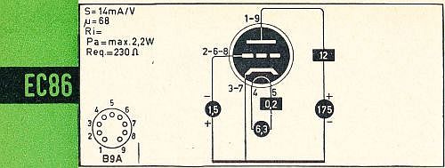

However, despite the realistic objections, it would be very nice to see the EC86 made to work properly with the CCS. Question to OP - how are you physically connecting to the control grid? Are you using all three of the pins together (2, 5 & 8) with grid stopper, or just one.
as suggested by Rod i am only using one grid pin, the #6, while the #2 and #8 pins are not connected and i removed their clips from the socket.

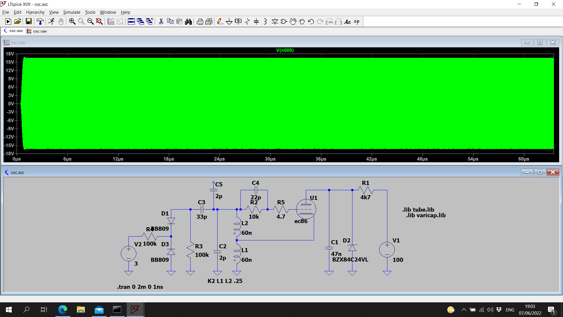

EC86 makes good UHF oscillator. Probably going off in the VHF range maybe even up to 400MHz. Suggest you swap it for something more audio.

I have used the valve as a VHF culprits oscillator and oddly enough it would go off at UHF. The solution was a 4R7 carbon resistor to the grid and right on the pin. If I used 33R the oscillator would not run. In the end I went for an ECC86.
