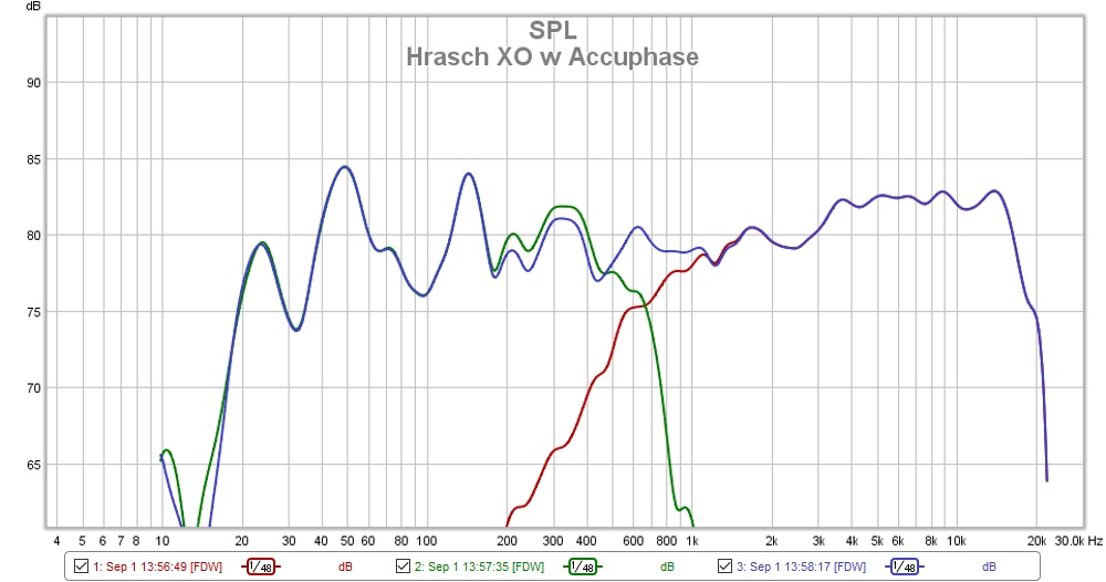

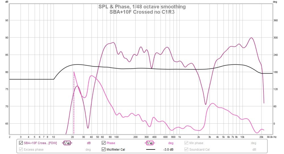

Thanks for the replies,
The speaker actually does not sound as bad as it looks in Frequency Response, I thought I would notice such dip but maybe I m loosing my ear, but that makes me suspicious of my equipment or that I m doing something wrong, I have two audio interfaces (will use the other one this time), the mic is umik-1 and I did test both speakers separately.
The FR Driver has a dagger enclosure, it is sealed off but it is possible that it has air leak somewhere, I will look into this.
I will do the test outside the cabinet on an open baffle setup as wesayso suggested and will report back.

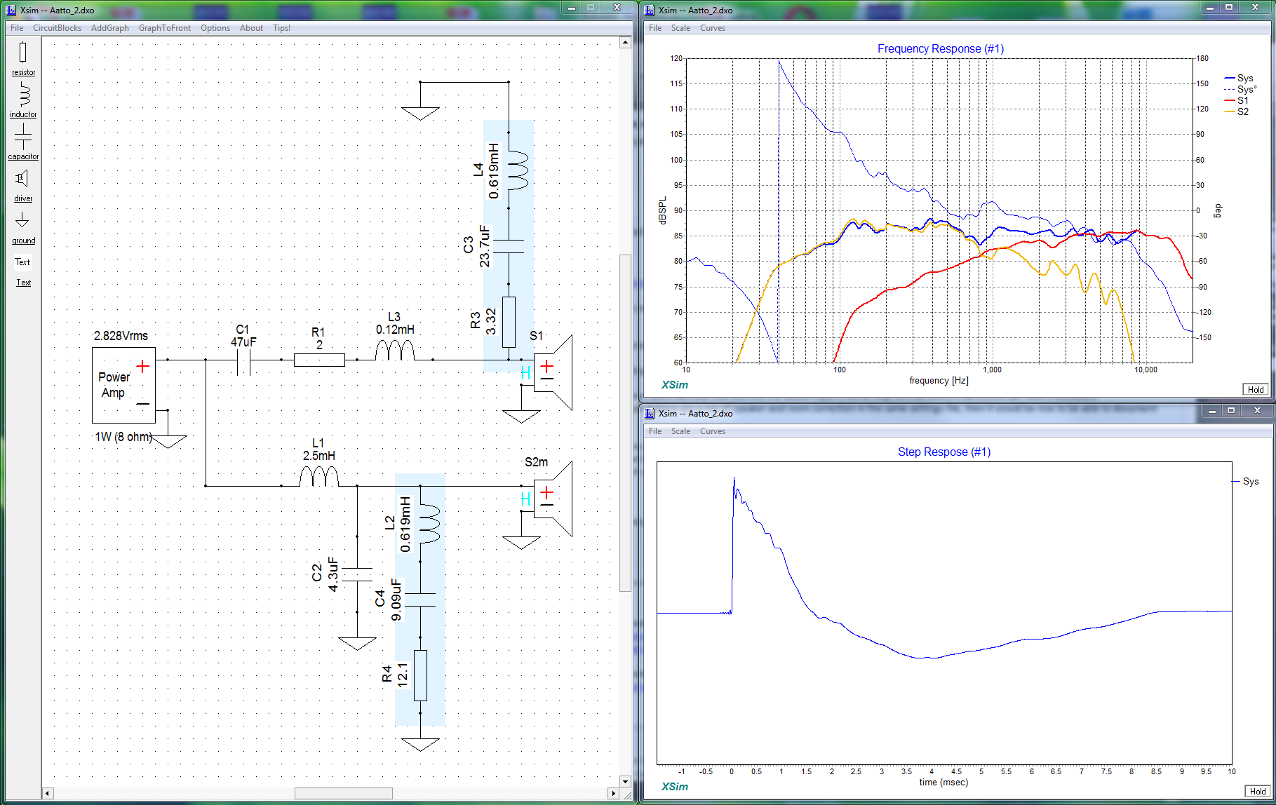

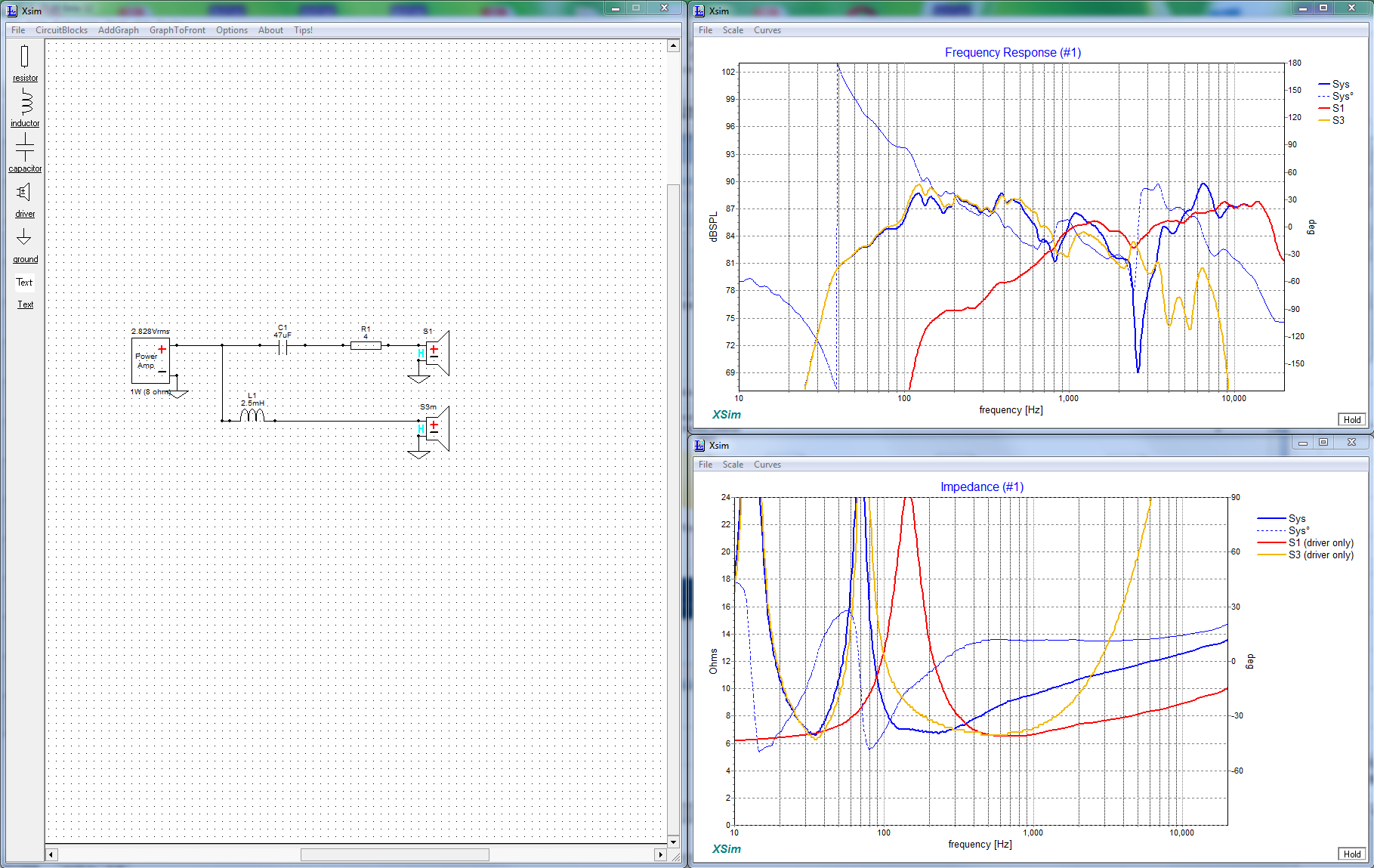

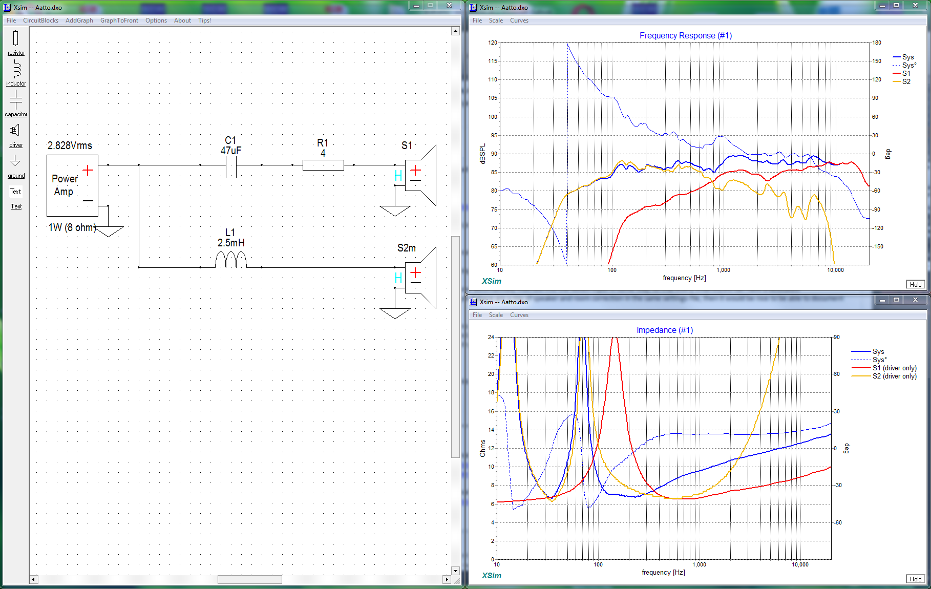

Theoretical into simulation it looks what is Aatto's real world case can be possible is the truth, in below XSim simulation traced amplitude responses from each published data sheet for SBA23NRX and 10F/8424 and did the math in REW (datasheet times bafflestep loss and difraction for Aatto's enclosure plus a 35Hz boost and 4th order roll off for woofer), then a homemade zma-file in a dual peak 35Hz one for woofer and used one of xrk971's real world DATS measurements for his 10F dagger combination. When acoustic center for woofer is about 1 inch too close to microphone relative to 10F we get below theoretical synthetic responses to compare with Aatto's latest real worl measurement ?
O WOW, that s is some calculations alright :) I appreciate the time and effort you put into this, so i think we found the black sheep then, at least for the dip issue, it's back to DSP for me :violin:
Wow, thanks Byrtt. So it looks like the use of the RS225-8 is key to making the flat upside down woofer on top baffle work? Why does the 10F fall off so steeply at 150 MHz.
Yes its position in space of the two acoustic centers relative to microphone that is so sensible to create various interference patterns plus most woofers have a amplitude and phase havoc at breakup area because they expected used with steeper filters much lower, so the wide band covering using 1st order has a cost here when the two sources has physical spacing, in below graphs there is a 3 inch delay for 10F and worst interferense pattern looks go away. The steeply falloff at 150Hz is because when factory sheet is traced one only gets numbers for that amplitude curve into frd-file without any phase data and to repair that problem one can use "Derive" feature in XSim to get phase to follow amplitude and i probably set its HP filter at about 150Hz at that time even Aatto told his dagger was at 182Hz planning, but it should not be a big problem for stuff we here try to figure out.

Yes can imagine that was the black sheep and if you more real world curious you can probably test it measure at say 5-10 microphone heights and you will get different looking interference patterns for all of them except for one where acoustic center distance is same or lets say optimal for these simple use of few components for slopes :)
Ha ha back to DSP makes me smile a bit because 1st order is often the worst eater of expensive components because of the wide bandwidth coverage so DSP would not be bad here to get slopes alot smoother and even manipulated wider too, a few minuttes quick and dirty example is below how component numbers accelerates too fast when one try get smoother slopes for such wide coverage.
