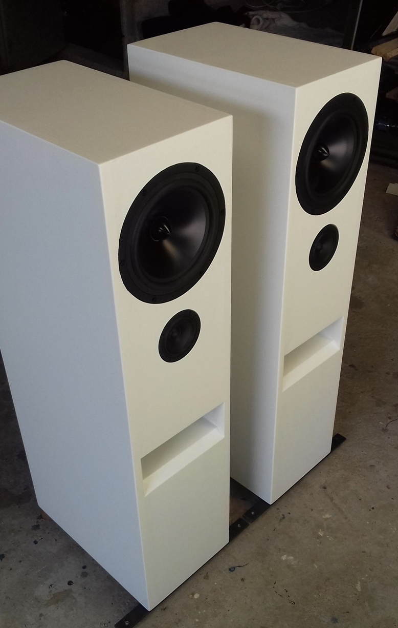

Hello!
sorry, it's summer time and i went far from home and the final painting take a lot of time....
but it's now finish and i'll take photos in my room and post them soon.
for now, i can say it's a crazy good speaker even with my poor denon avr1600 amp. it's very detailled and dynamic, crazy bass and the disappear totally when music is playing even if they're quite big.
i'm really happy with the painting which is a white satin lacquer and from listenning position, we can't see the litlle defaults on it .
i like the speakon connector as it's very easy to plug and it's solid.
now, i have many things to do before giving you a musical detailled review of it:
-trying different weight of wool inside to see what is better
-trying with a good hifi amp
-buying a good DAC too because i only have a poor cd source.
again thank you so much all of you to help me in this adventure !!!
see you soon

Hi Moutik,
This is great news to hear. Glad you are enjoying the sound from these speakers!
We look forward to more photos and listening impressions with a good DAC and amp.
