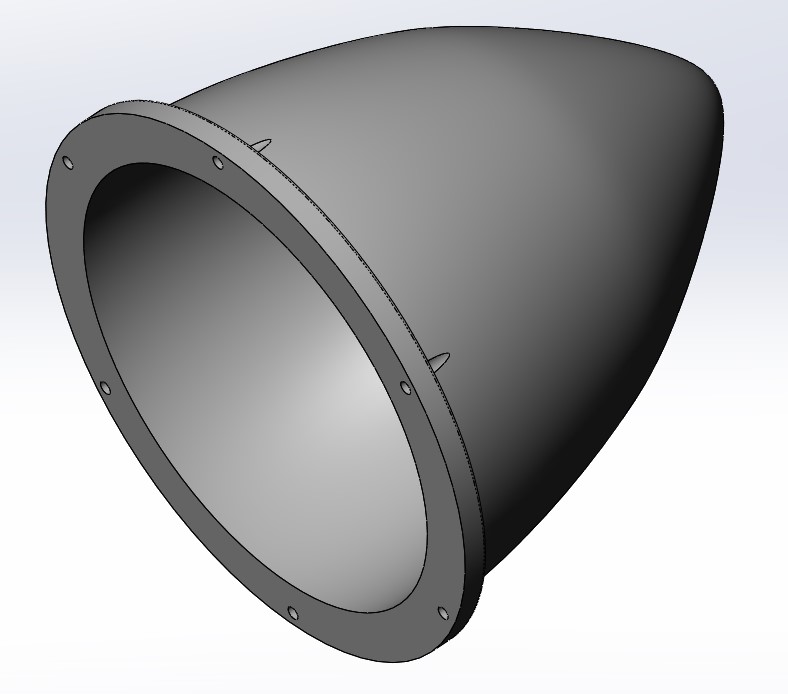

STI file for fullrange cup
I'm a bit daunted by making the fullrange enclosure described herein, so I made a 3D printable enclosure instead. If anyone wants the .stl file, let me know. I'm not sure exactly what the volume is, but it's meant to operated sealed and should be close enough. It's about a 6 hour print on my delta printer and I just started the first one.
The volume should be at least 1.2 to 1.5L or more. A longer orange cone with a shallower angle will absorb the back reflection better. The material on the cone is nice as it is slightly compliant for good damping. It is not hard. A 5 sided wooden or foam core pyramid is not that hard to make. Make a mock up out of cardboard first for a pattern and to test fit. Then glue wooden triangles with wood glue and seal with caulking or hot melt. Use take to hold together while glue dries.
