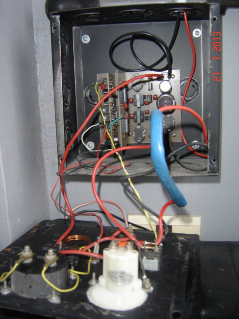

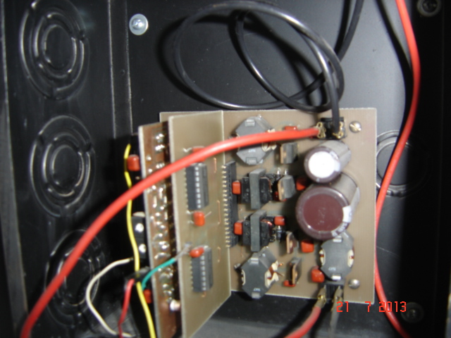

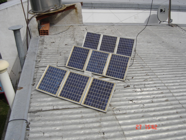

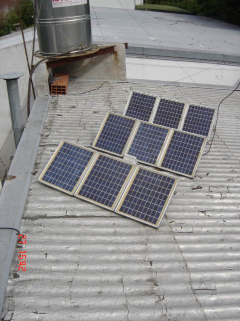

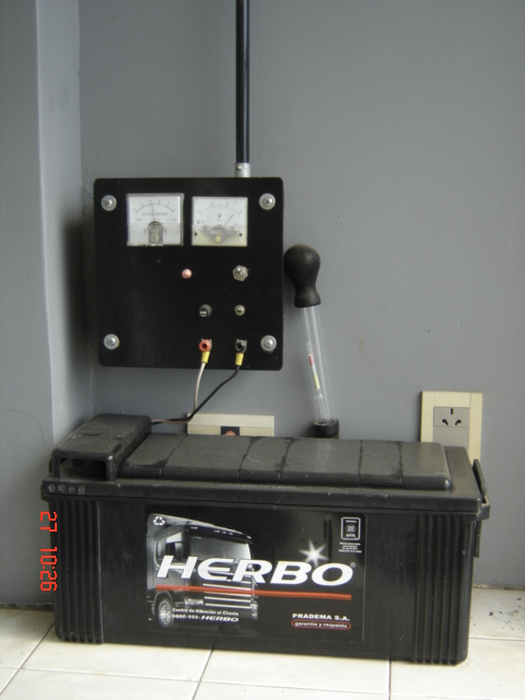

I also have solar cells, but at 12V instead of 110V. The black box at the wall is a switching regulator designed of my own.
it have 4x250watt.they were parallel until now and was producing 5kwh/day,almost all my house.but now i want to add two more because the winter is coming and the current would be huge so i changed to series connection.

Yes. To avoid this effect in my regulator, I used a window comparator: starts charging at 20V and stops at 14V at the regulator's input.
