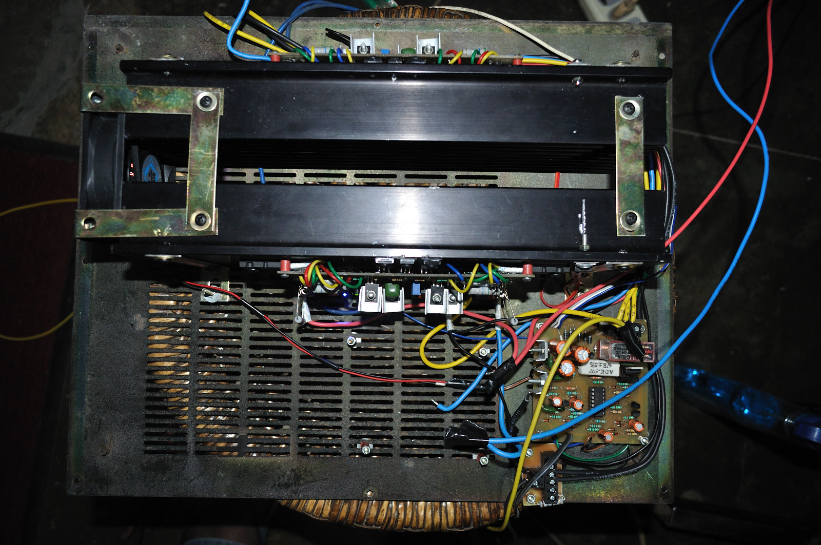

This is AX-20 extended with 5 pair, but "NOT TESTED" yet.
I will update and confirm soon once pcb is tested.
Thanks for your effortsThis is AX-20 extended with 5 pair, but "NOT TESTED" yet.

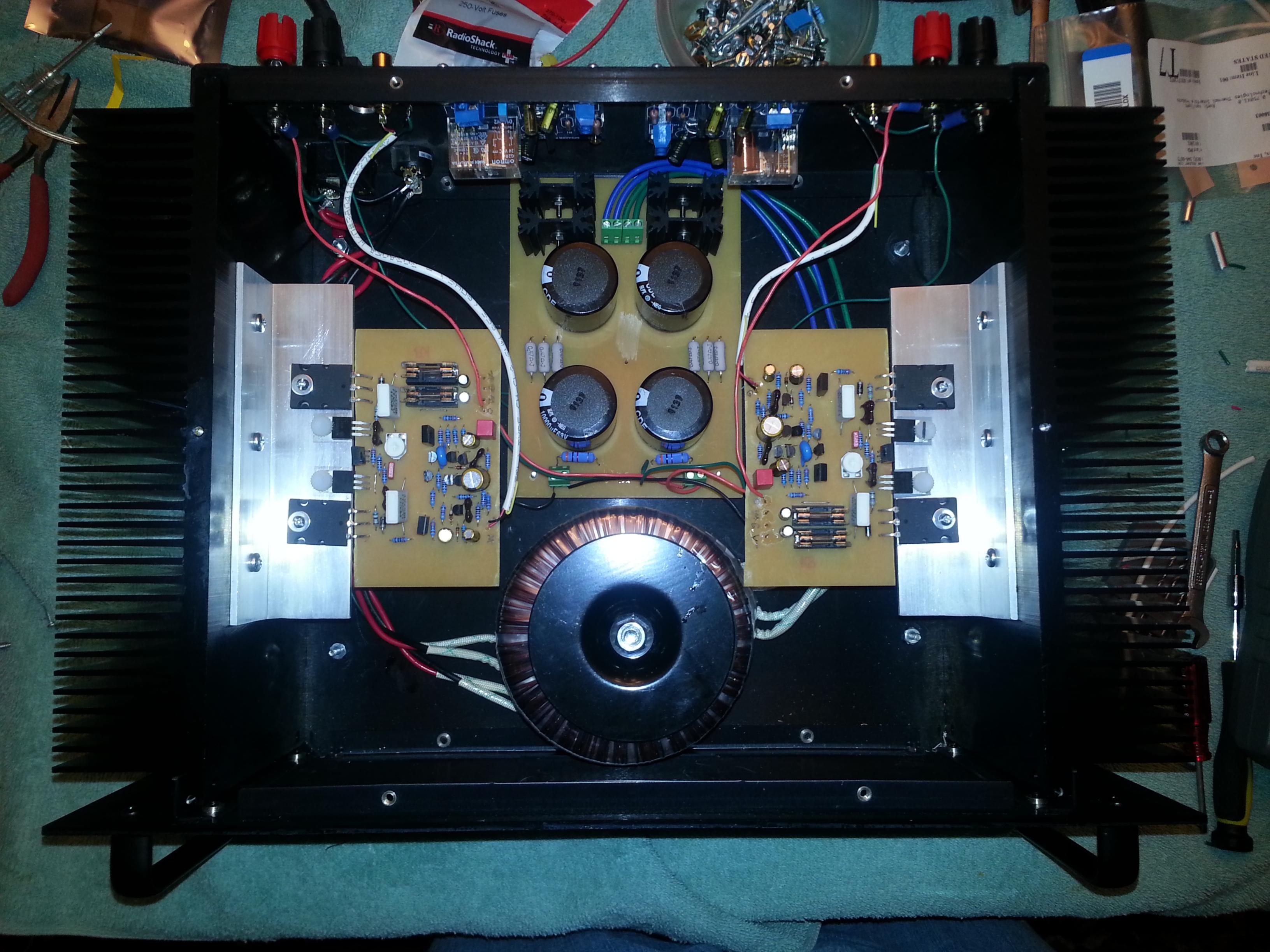

Finally figured out the problem...one of the resistors was miss valued by quite a bit.
I fixed the resistor and took the amp for a spin. Running about 65 mV across 0.22 ohm emitter resistors and the large sinks barely get warm.
I am really going to enjoy this amp...good treble...commanding bass and the amp is very quiet. I still need to clean up a little wiring and post a pic.
The amp boards and psu board are all homemade etch via toner transfer method.

Here is a pic...The speaker protects are not hooked up yet but it did not thump at all upon startup or shutdown.
Nice?! 🙂 It look´s great man! Well done!
Nice work, and nice picture. I suggest to revert positions of transformer and PSU and you have short wires instead long from AC input to the transformer and from transformer to PSU. Bias transistor (BD139) must be connect on heatsink with outputs.

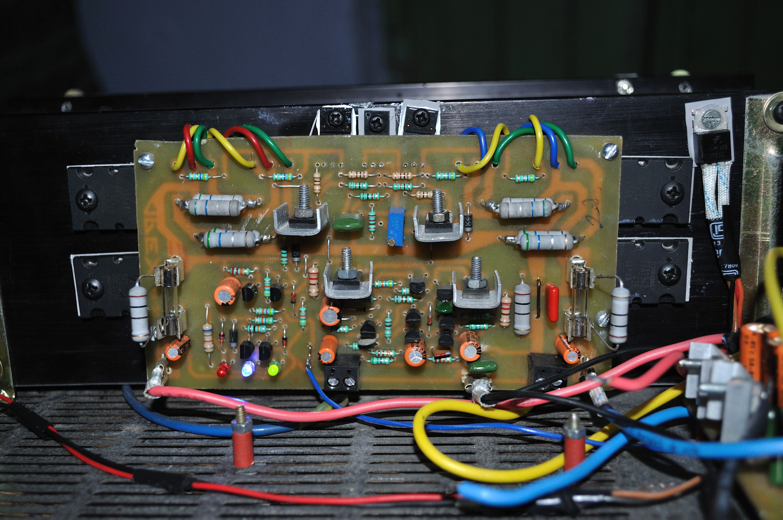

Hi miles, I assembled AX-20 amp I have attached layout. Problem with this layout is, there is no connection between Q9 - Q18 and Q8 - Q17. I easily fixed by using MJE340-50 lead as jumper at copper side. My problem is I am not able to adjust bias, amp is playing music every thing seems right.
hi, Sonal Kunal
if you look at the scheme, there will be a dc current that comes out on the speaker output, because there is one diode 'IN 4007' an inverted installation, the voltage of the diode is positive. you try to watch another scheme,
Regards
Regards
yes thats in layout but in board I have place correctly, there is only 10-15mV dc at output. I'll post picture soon.
I connected amp in series with 10Ω resistance, when nothing seems to burn I put fuse and tried to adjust bias but was not able to, even winding trim-pot to full. Amp was playing music but with crossover distortion at low volume.
