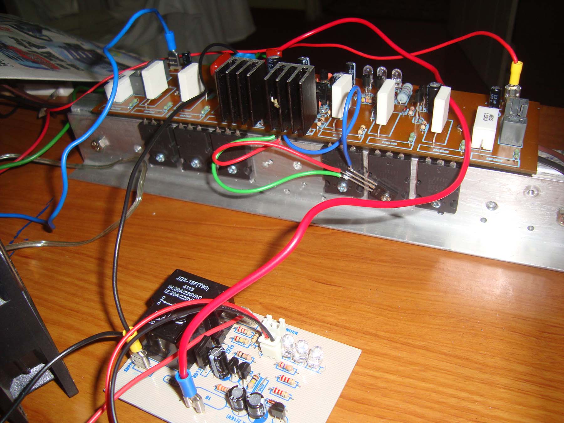

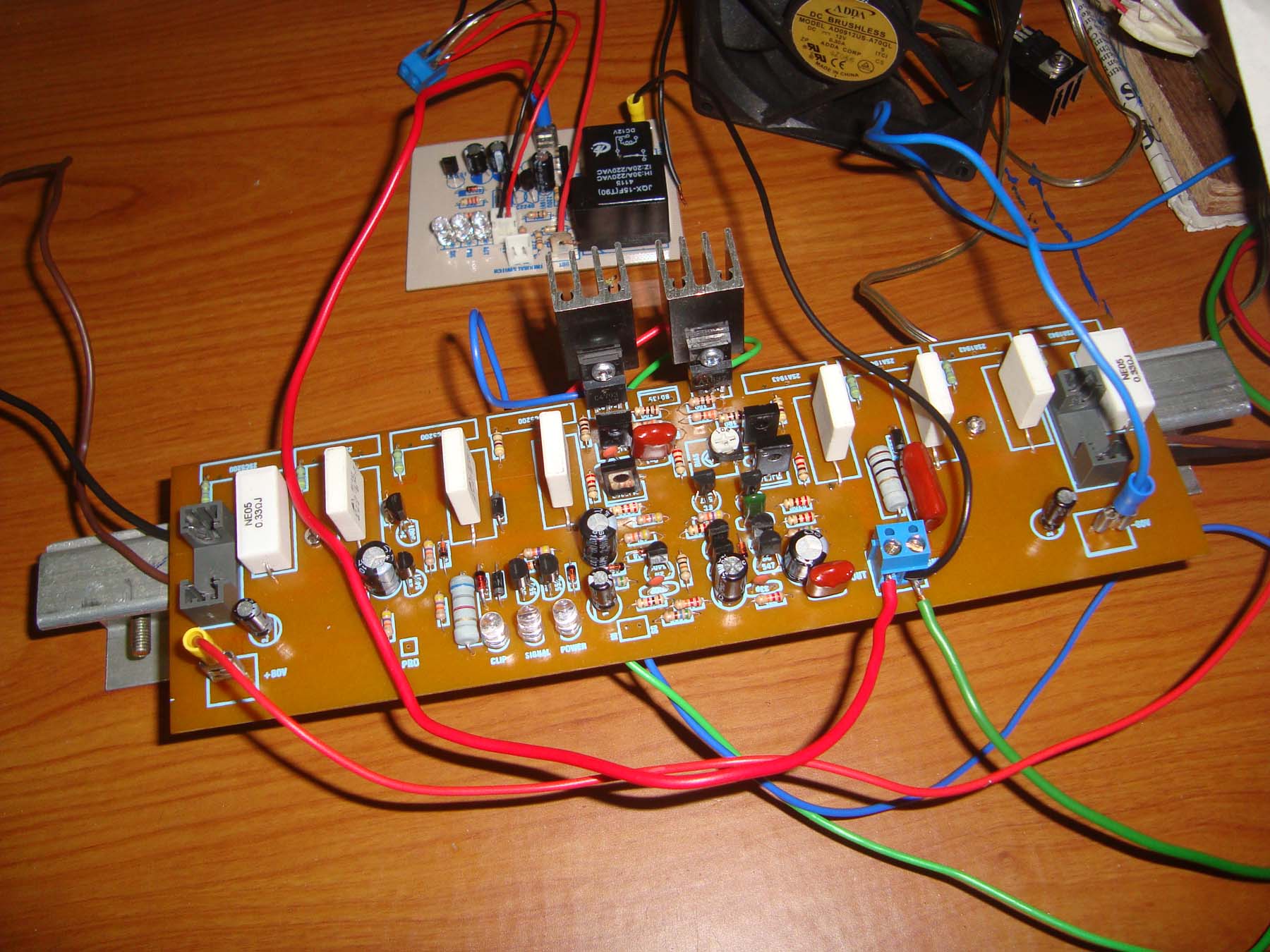

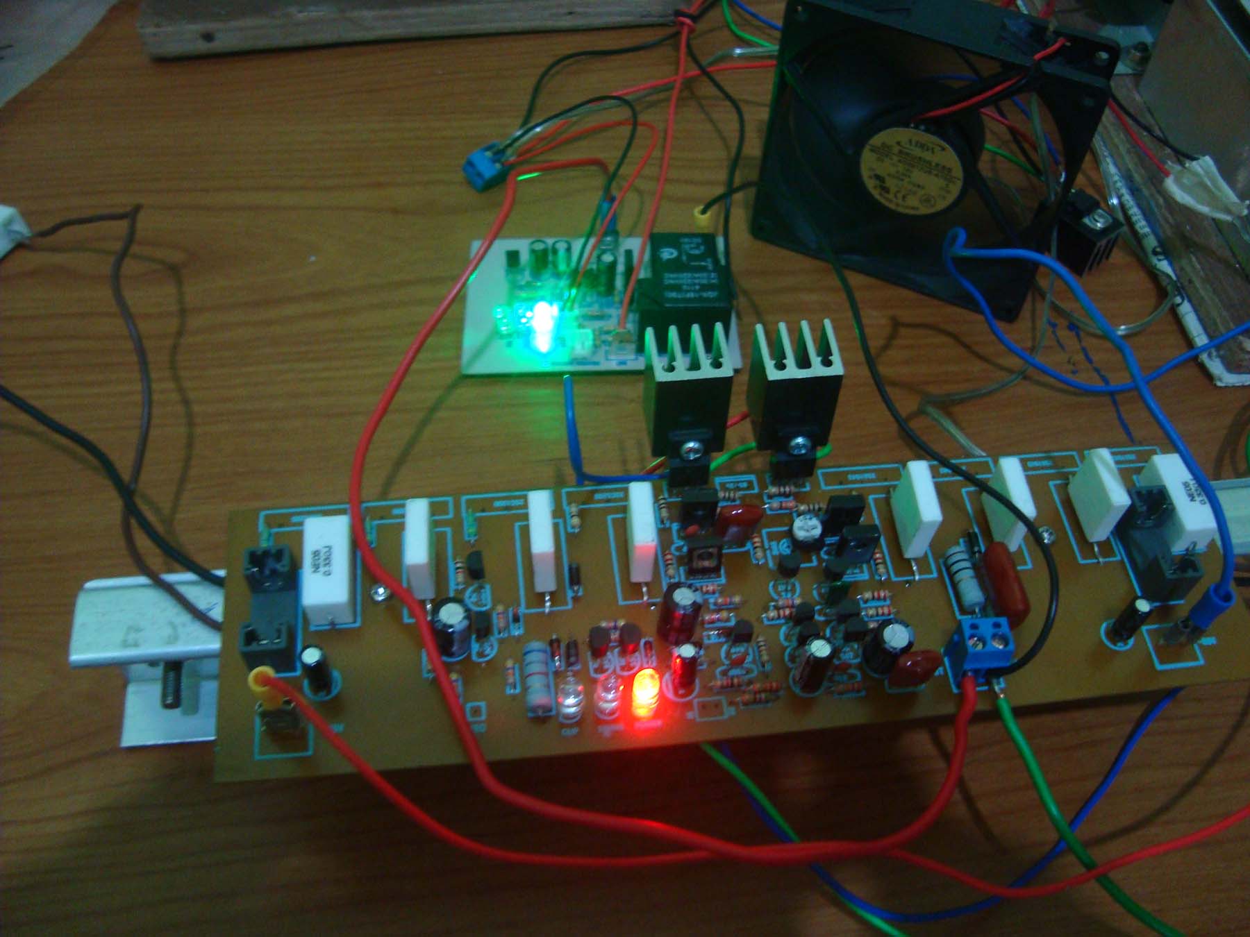

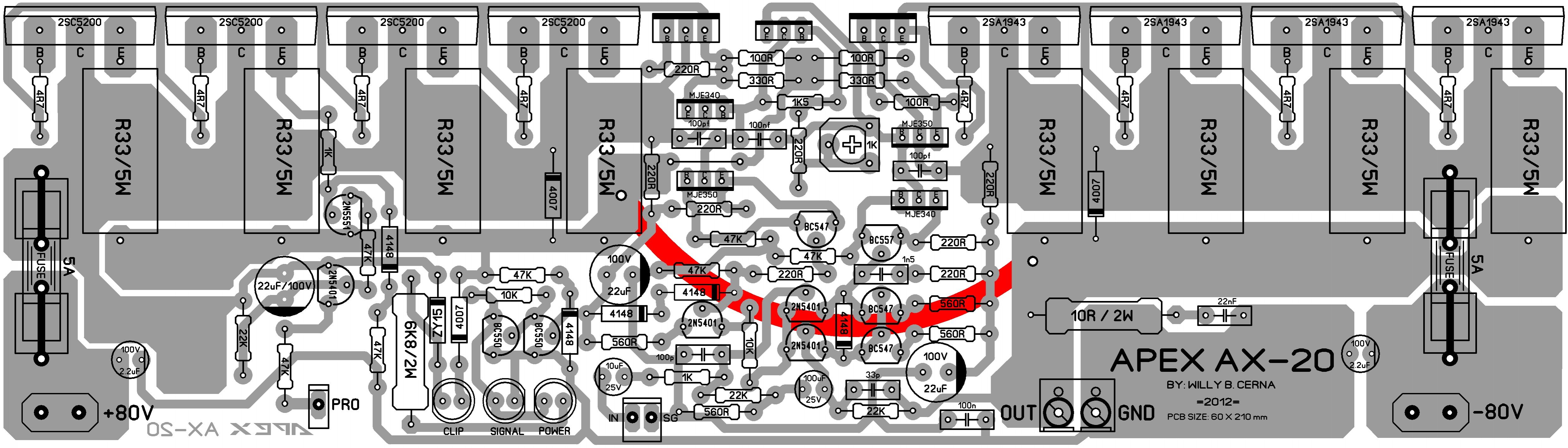

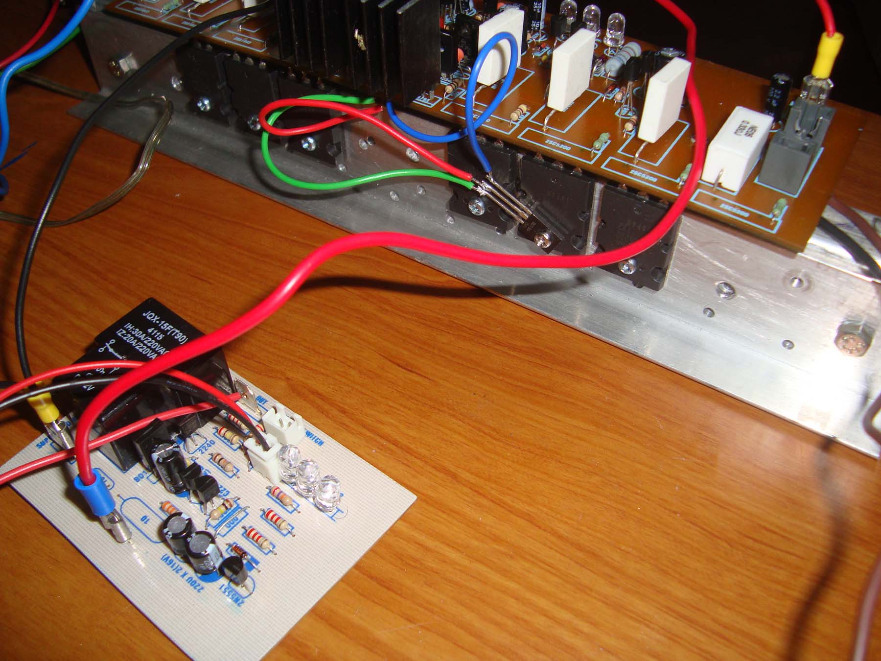

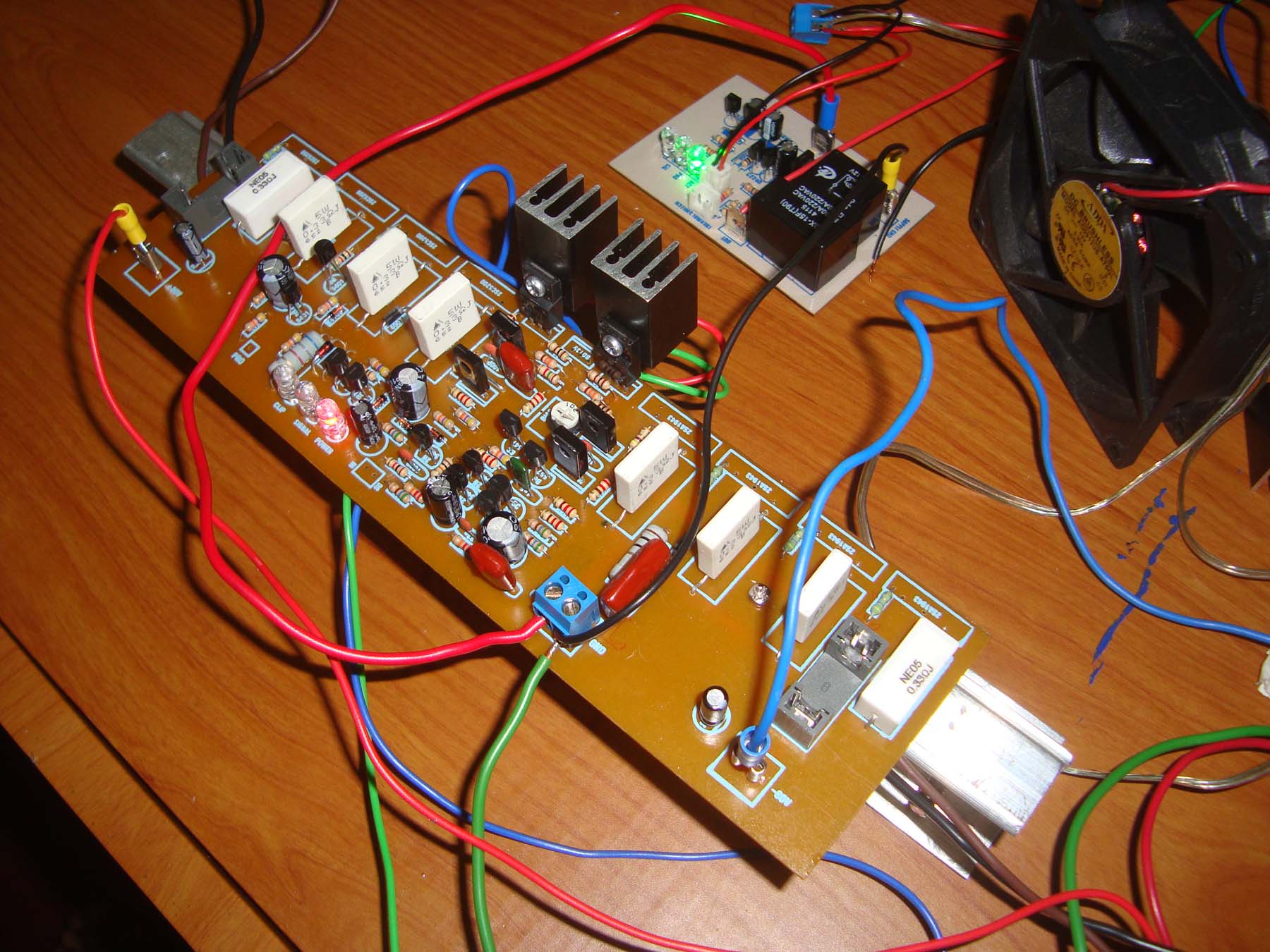

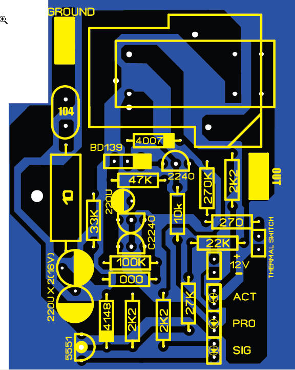

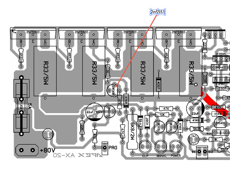

hi apex sir,
here is the ax20 ,
10mv for emitter resistor, dc offset 20mv.

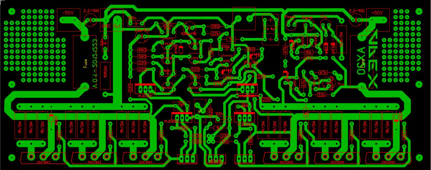

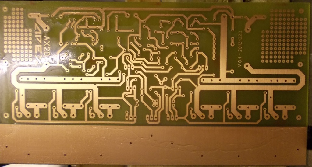

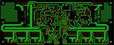

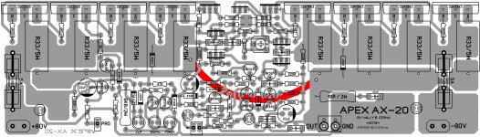

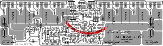

New project
Merry Christmas to all,
I have designed a new board because I want to use my own components from the shelf. I've made ​​some changes to the layout. The original layout is from Post 1740.
regards Olaf
