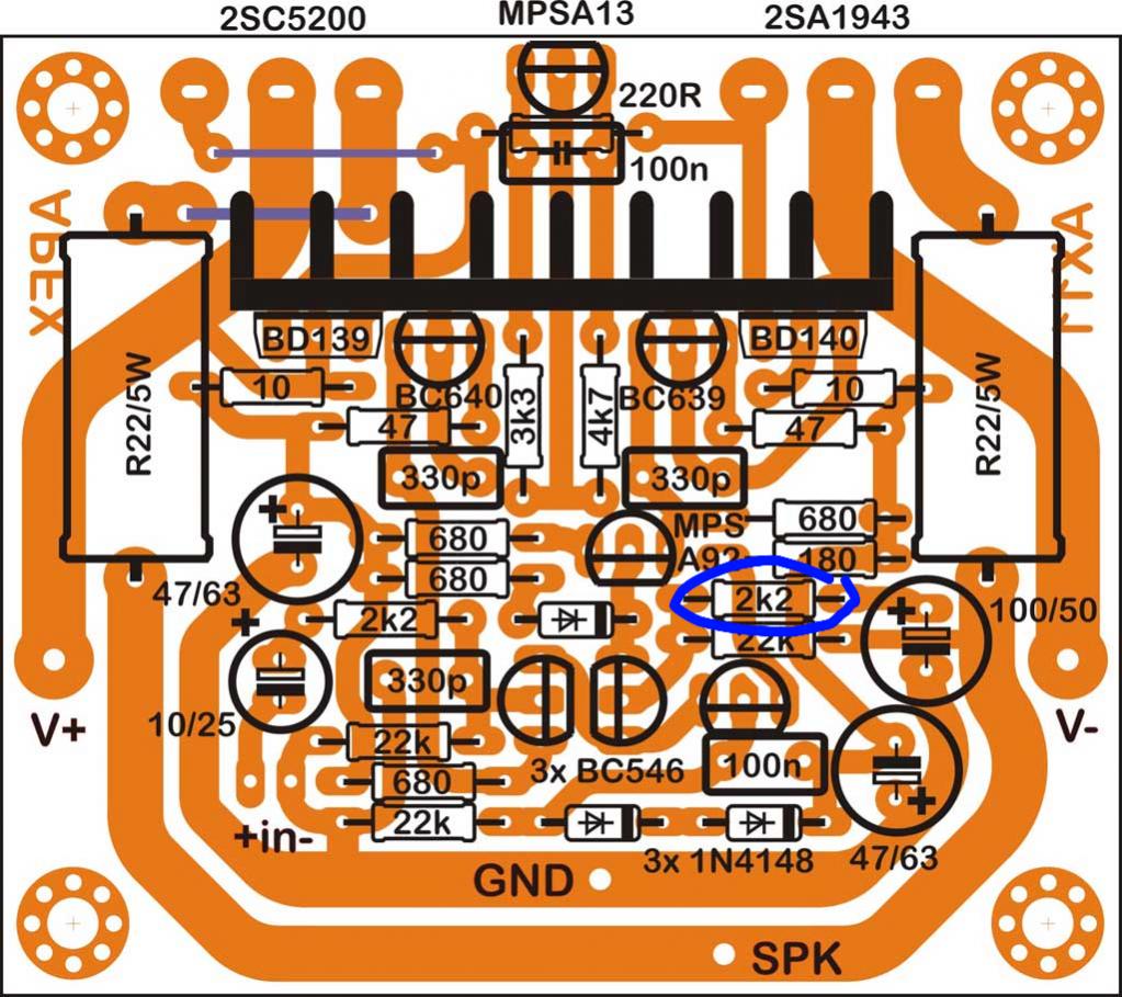

If you used 2k2 gain setting resistor, gain will be too low. Replace 2k2 with 1k or 680R.
Thanks for quick reply, you mean this one in blue circle

Yes

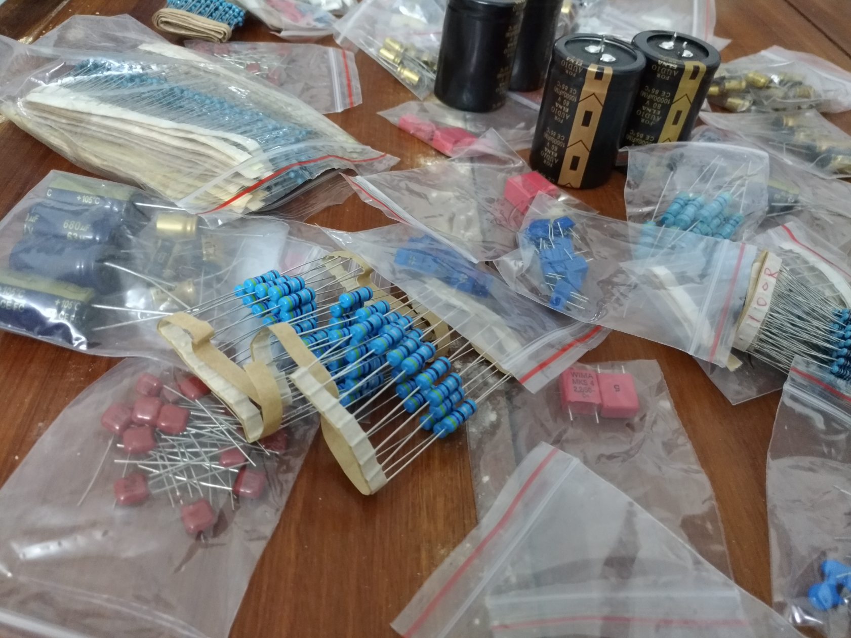

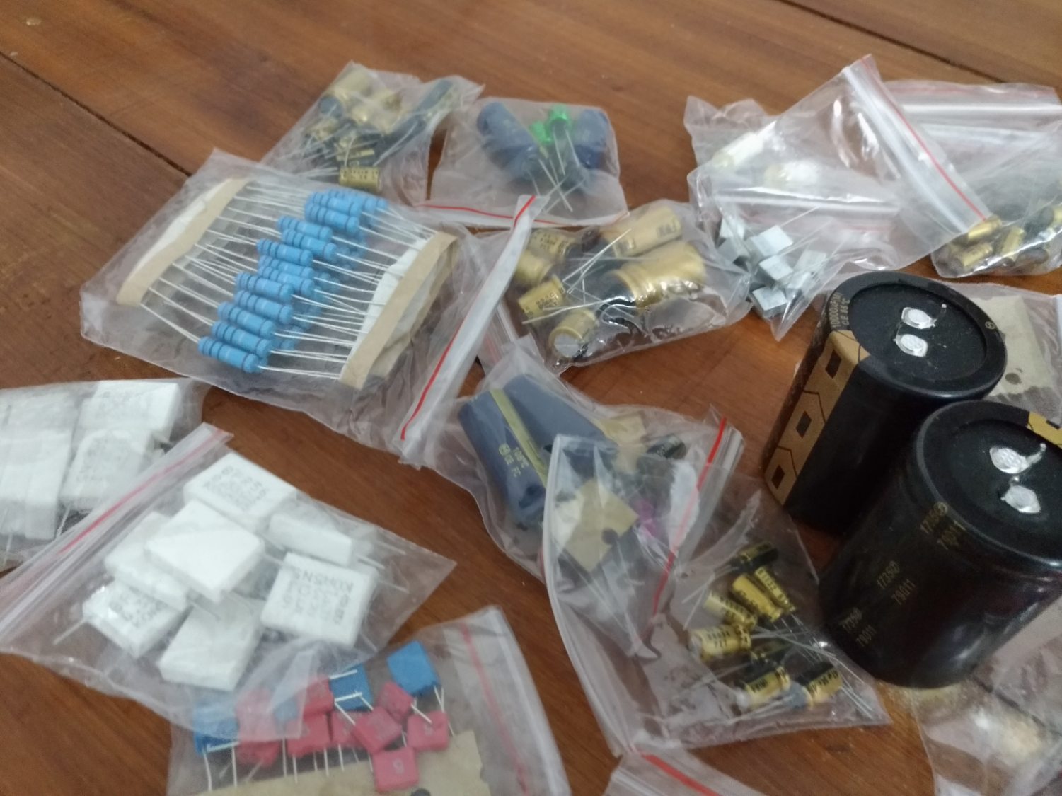

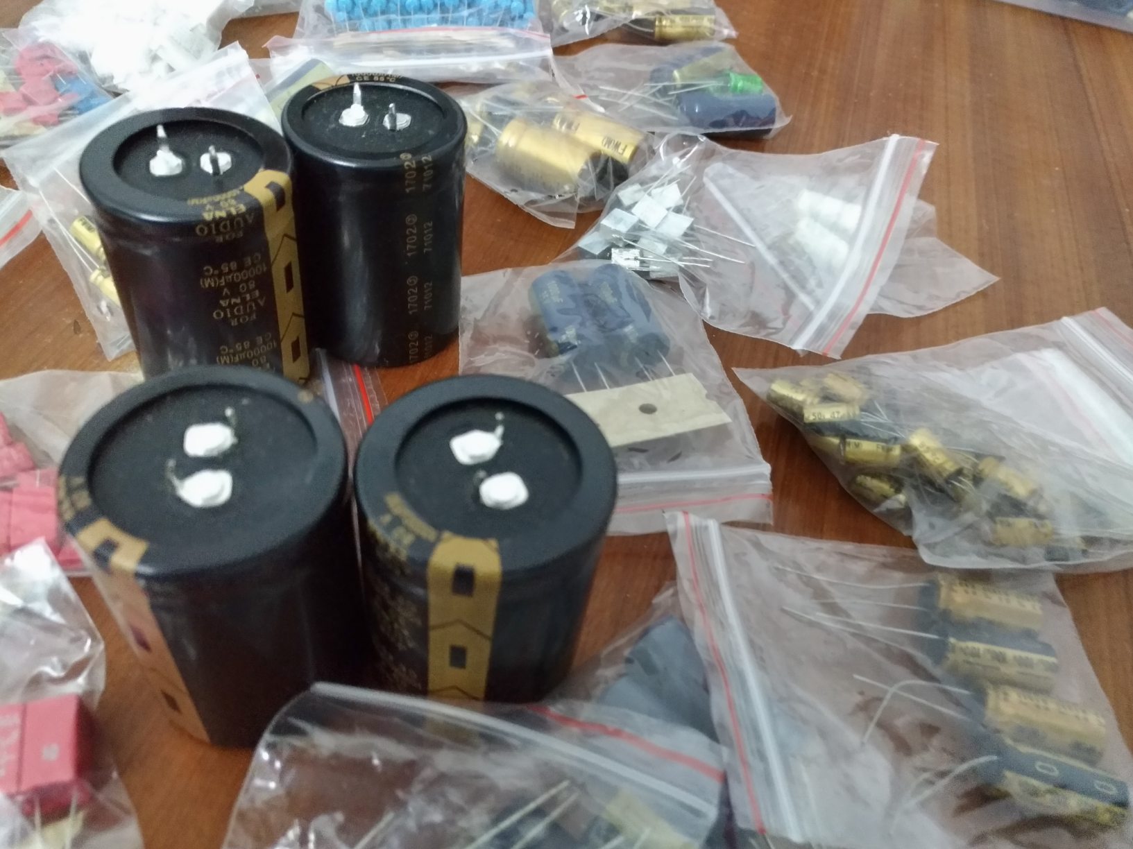

From where you bought the componentsStarted receiving parts for my Apex A40, P30 and TB3 combo. I know that the progress is very slow, but progressing 🙂

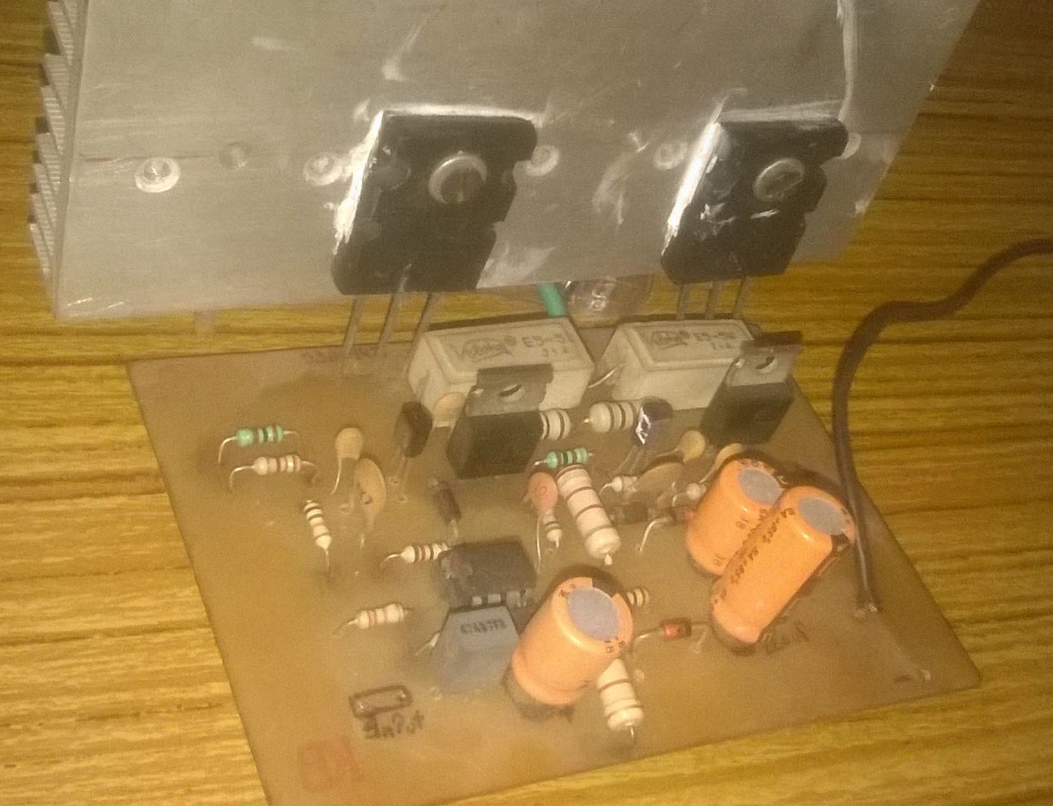

This Board is not good...Where the mpsa13 is connected?Floating?

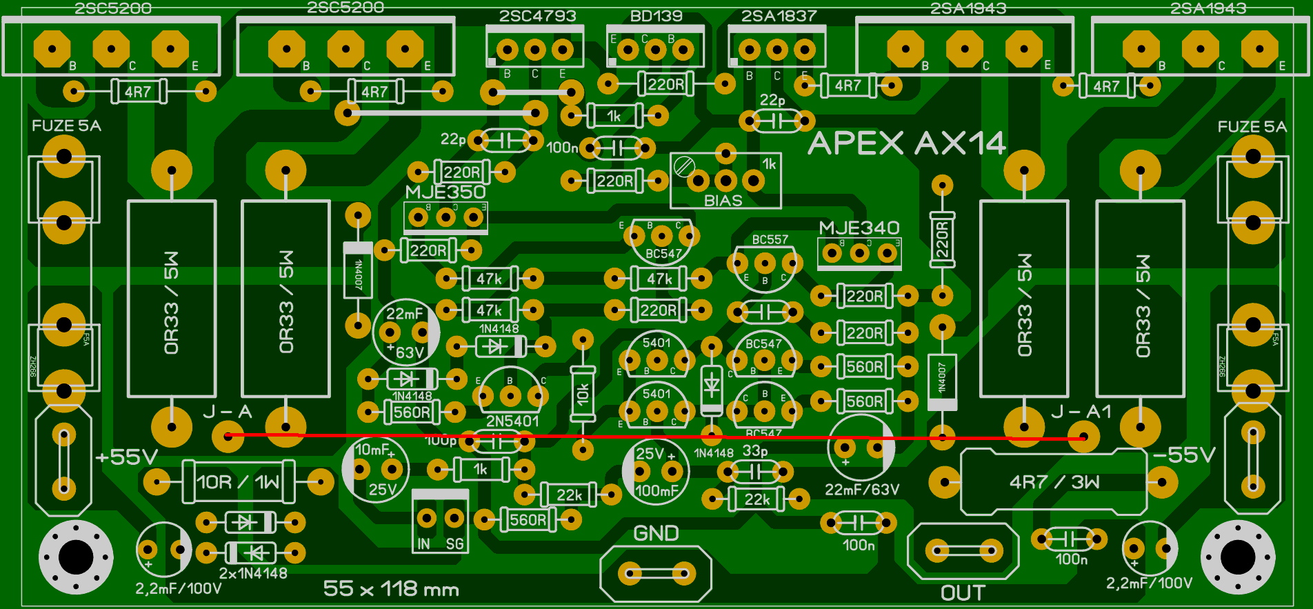

Hello everybody. Is anyone psb Apex AX14 with 2 pairs on the output?

Thanks Sir Mile for AX11 amplifier and thanks for help Mr. Kandimba, Prasi. After replace 2.2k with 680om its sing well and loudly. Now I am going to complete my 2.1 system for my computer room with AX11 and my another Amplifier board. I am making this board so many time with 1 pair to 5 pairs.
