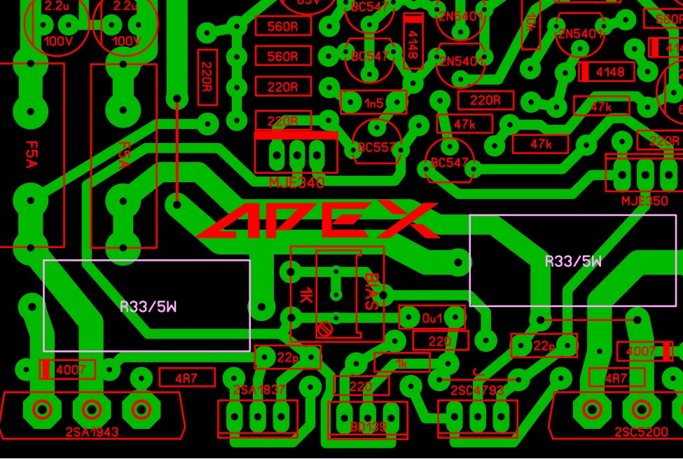

Nice little PCBs from PCBway ! also look at what a nice little free gift PCBWAY included in exchange for some accumulated coupons. It gives a very good visual perception of different devices and trace widths, which is not so apparent during PCB designing. Being loyal to boardhouses has its advantages😀.

Can we get here gerber files? Thanks
Juan,sorry but i feel that this pcb is on the wrong way!🙁
I thing that you has built a nice AX14 pcb in the past.
Prasi's AX14 pcb(post#10380) is a good example!
I understand thimios but I feel bad to ask for gerber files I know how hard is to design from scratch, the first version of the AX-14 is nice but I want to try something different yes it might not be the best layout but at least I try my own way the best I can 🙂

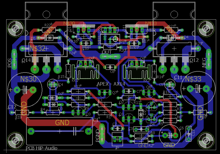

You're welcome to my version. Note that I don't have fuses on the amplifier pcb. I have my fuses on the power supply. The board is quite small this way.
See gerber files attached.

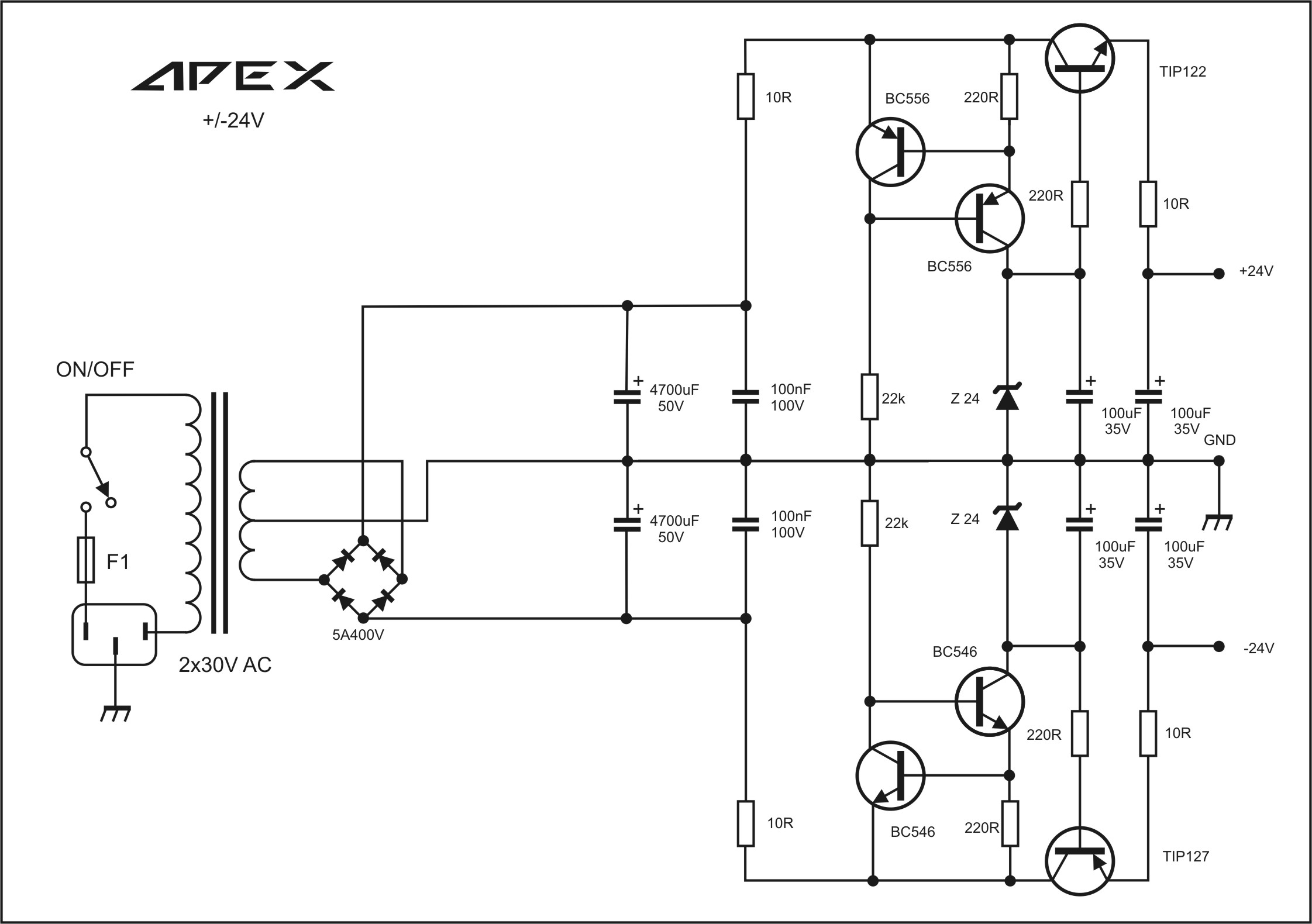

Hello.I am planning to build this series PSU but for +-18V output.I will change the 24V zeners to 18V ones.Will a 2X18V AC transformer be ok or should i use 2x24V AC?
hello maouna,
I had the same question earlier, Mr. Mile recommended to use 24VAC. I will try to find the post, as it was a long time ago.
regards
Prasi
edit: here it is 100W Ultimate Fidelity Amplifier post no. 8812
