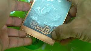

Toner Transfer Paper กระดาษสำหรับทำแผ่น PCB ด้วยวิธี Toner Transfer
สำหรับ นักสร้างแผ่นวงจร ออกแบบลายวงจร เผื่อเป็นอีกทางเลือกหนึ่งของนักทำปริ้นท์ครับ สนใจ
YouTube
YouTube
Google translate yields following text.you are going to have to translate that for us.
Toner Transfer Paper Toner Transfer Paper
For circuit builders. Circuit design This is one of the options I do."
He may be advertising the product.
BTW really nice transfer results.

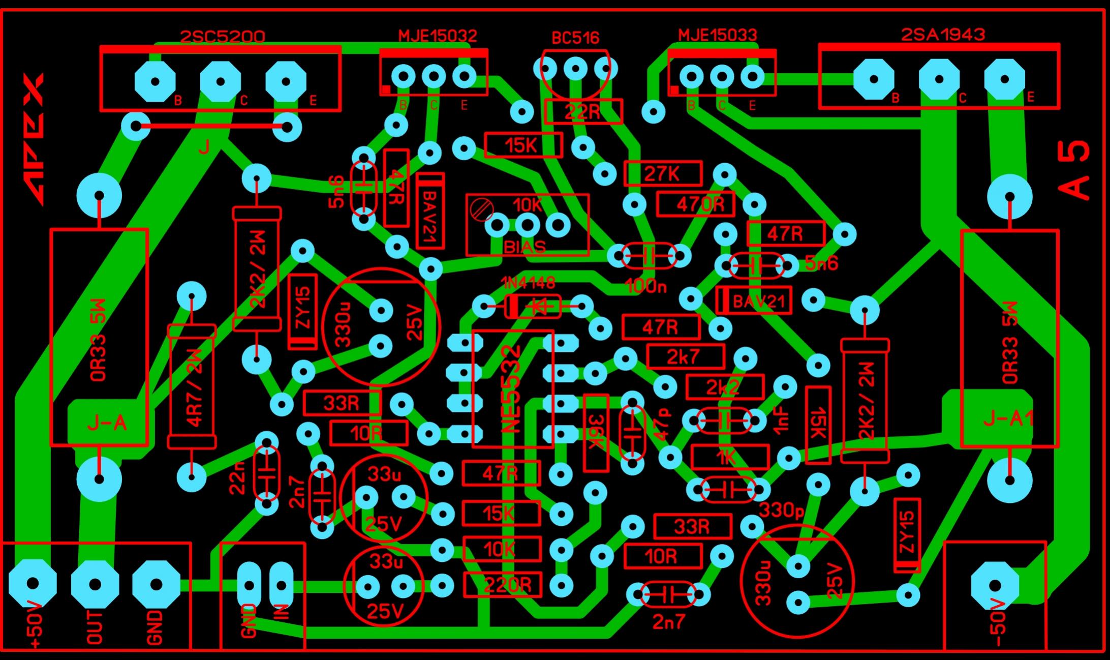

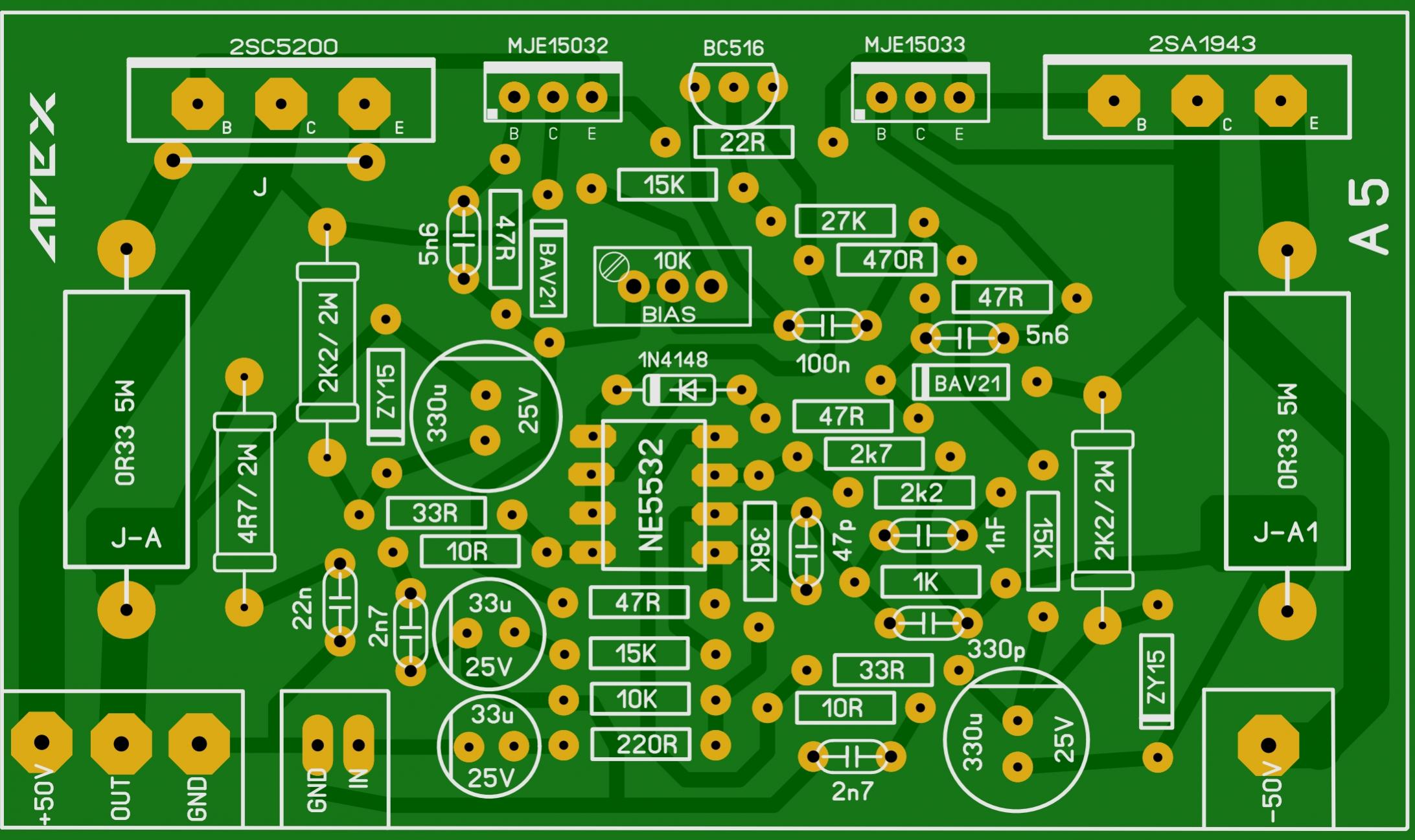

Apex a5 for who wants it
Here is.
Here is.

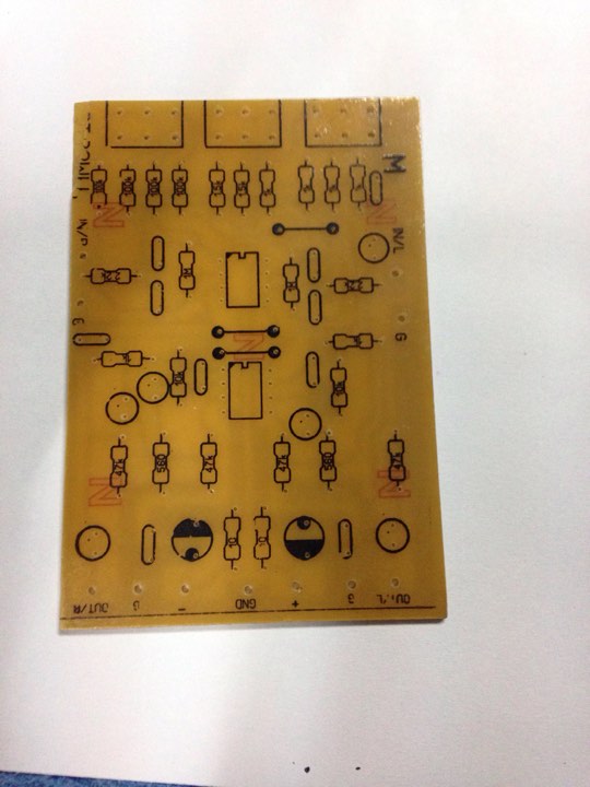

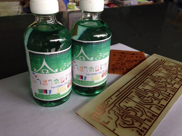

Is that toner thing something similar to this?
DIY PCB Using Liquid Photoresist : 6 Steps (with Pictures)
wfl3030.world.taobao.com
What you see is similar. If you are interested There are channels for you.

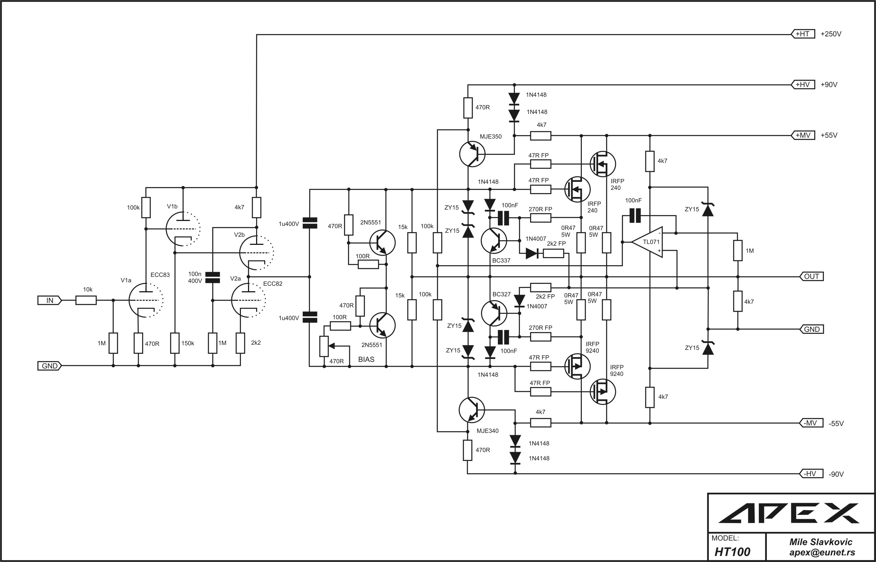

Was wondering if the circuit in post 10002 was Class A?
It is a class H sir! The first letter in model number is the class with Apex most timesWas wondering if the circuit in post 10002 was Class A?
Apex A5
Can somebody post the schematic and the correct Pcb layout together ?
Here is.
Interesting. Thank you.
