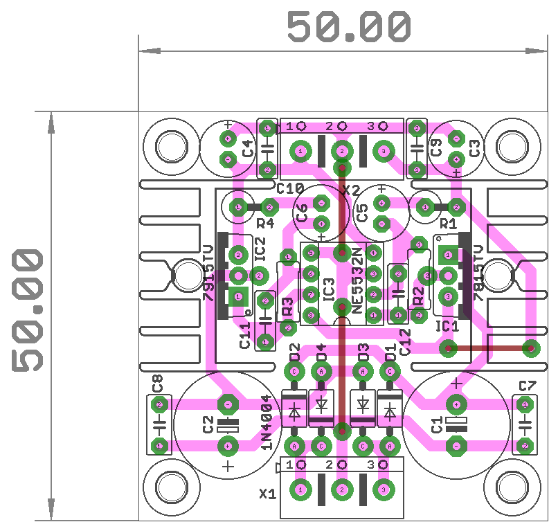

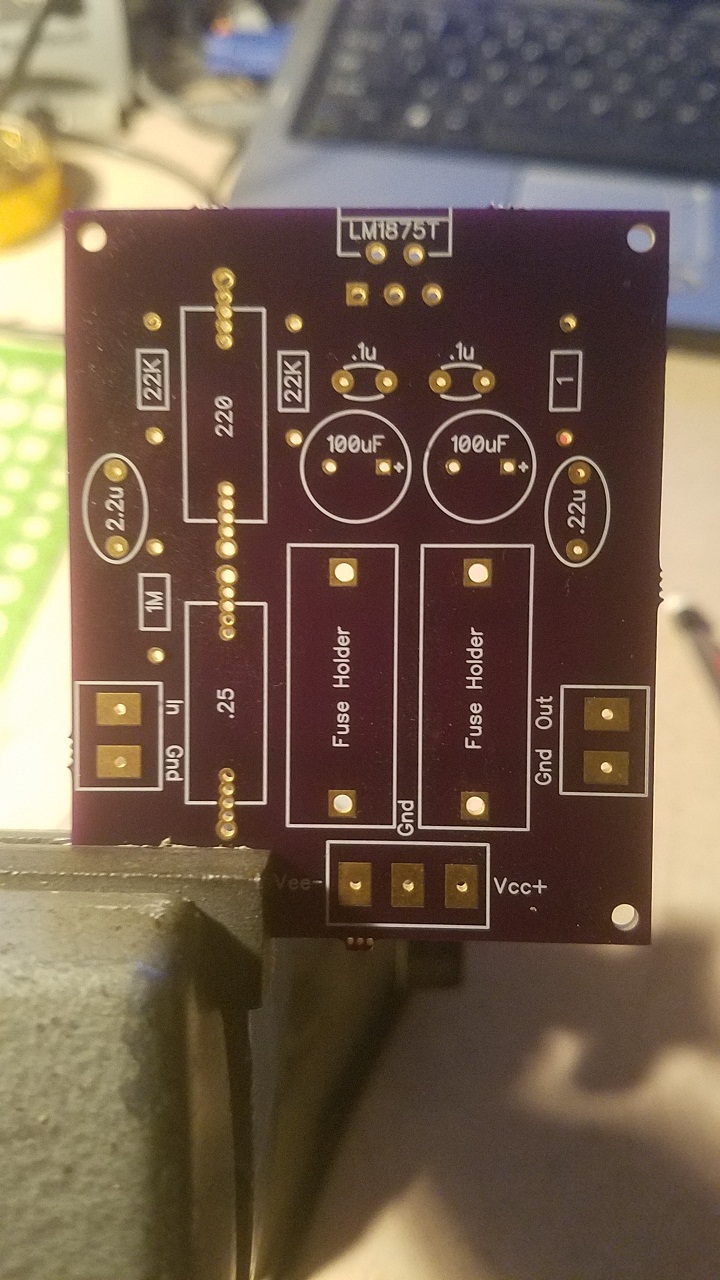

I'm actually really good with Diptrace and have produced maybe 40 to 50 pcb's, power amps, tube amps, preamps, stomp boxes, power supplies, you name it. Sometimes, with really simple circuits like this, I just do a quick layout in DIY Layout Creator and put it together in a couple of hours. I bought a case that had a strip of led's already built in that were labeled power, cable, link and message but I thought it would be cool to us them as a VU meter. Attached is a pcb I drew from a schematic I liked for this power amp build. I could use the pcb that Apex did but I would have to drill new holes and I really don't want to do that. I just want to figure out why mine doesn't work.
If you can't draw your own pcb why you don't use the original pcb by Apex?
I was looking for to help him and found this apex vu pcb, but I can't say if is the approved version.
Nice work,

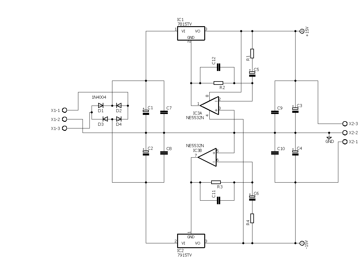

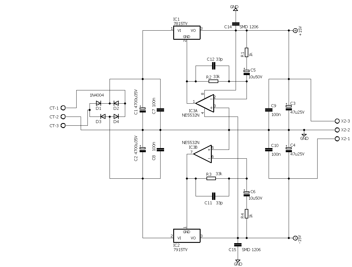

PSU for TB1, TB2, TB3...
pin 4 and 8 not connected?
It is connected pin 8 to +15V and pin 4 to -15V
Regards
Regards

Yes, nice pcb.
Regards
Thanks Mr. Mile.

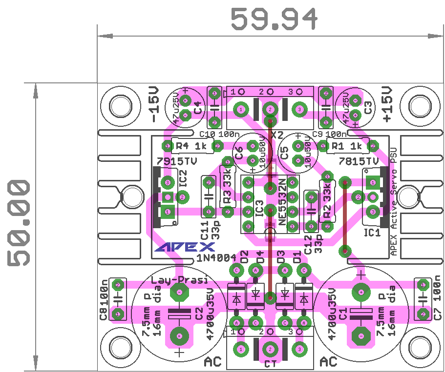

Here is the final version with 16mm caps and smd bypass for opamp.

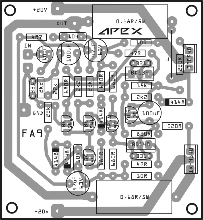

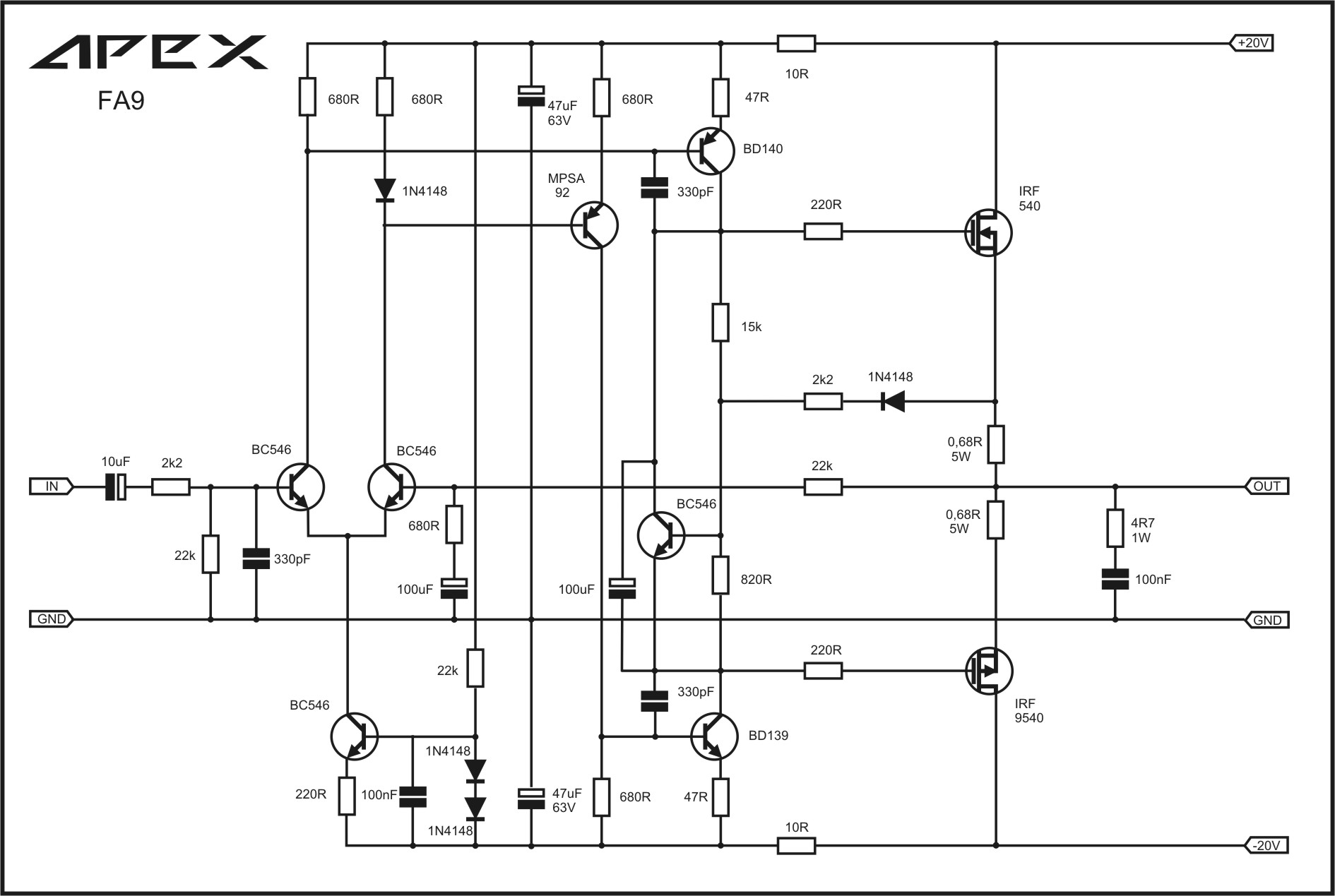

FA9 class A
Max power 8 and 4 R LOAD? Maximum power supply? Thanks
