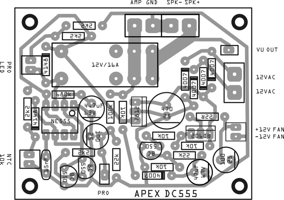

Hello Sir Mile, where i can find dc speaker protect with rellay for ax16?
Sent from my Coolpad 8297W using Tapatalk
You can use DC555 protect.

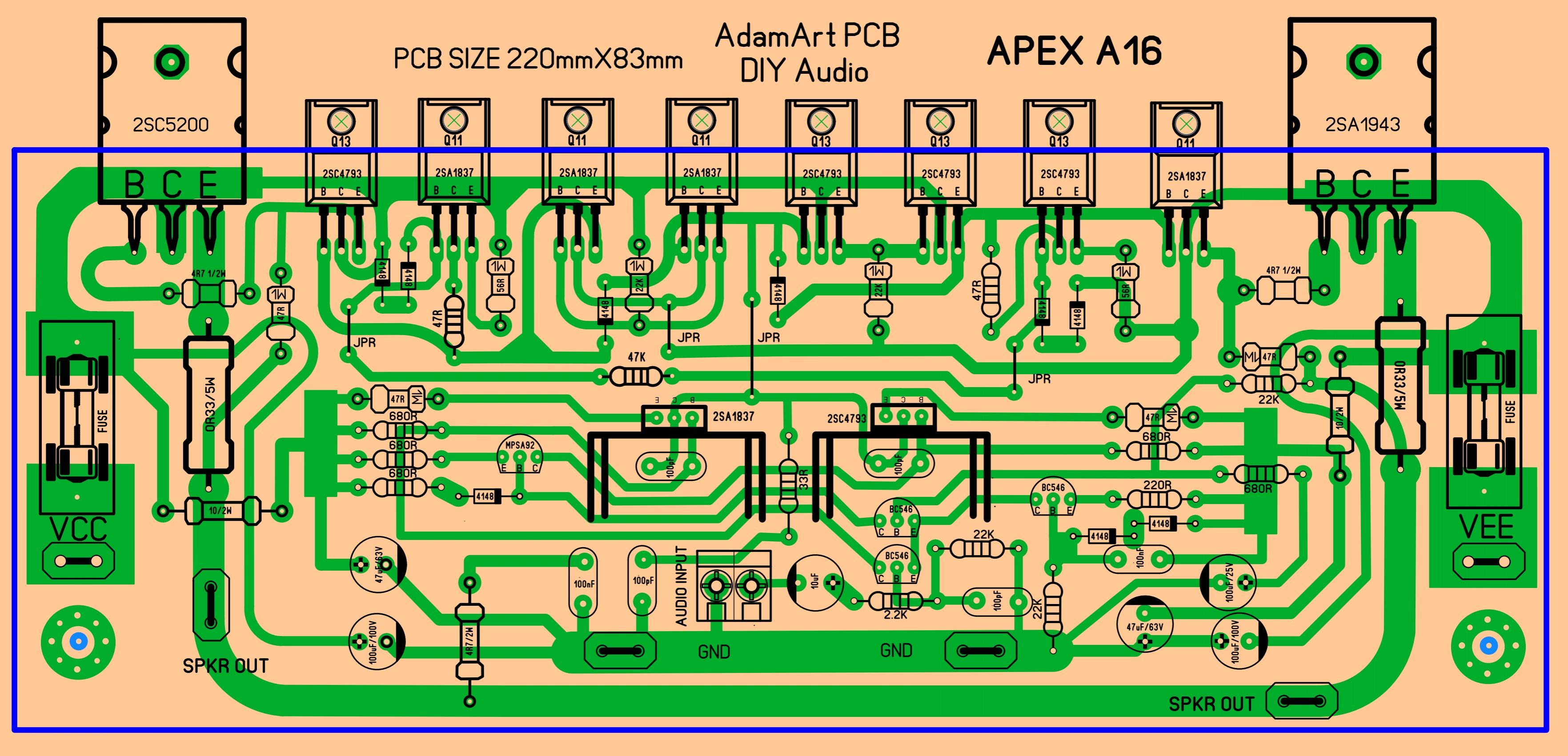

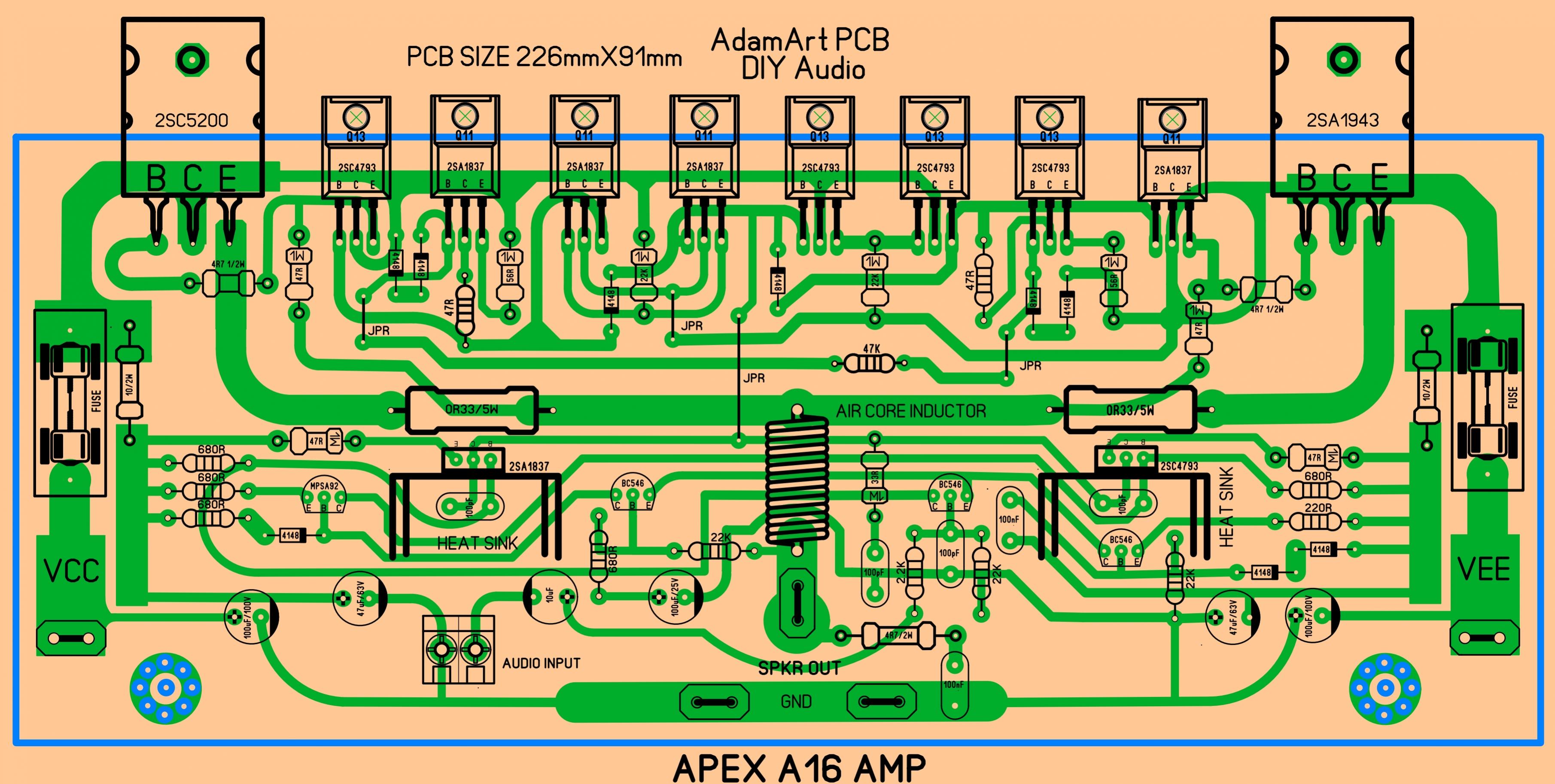

hi.. sir apex here is another one PCB size is 226mm by 91mm soon i will do work another version for thermally coupled as you mention BC546 thermally coupled
not good, at all ,wrong layout my friend ,input, low signal ,near strong currents , from output ,not acceptably
I agree with you...
One more thing, 100uF (220 or 470 uF even) rail decouple could well be placed above the fuses where its more useful.
+ no need to give too much importance to curves/ symmetry/beautification...some curves are totally unnecessary like B of 2SC...

x, that's implied in Alexmm's post... get the o/p as far away as physically possible from i/p...like my layout of Ranchu/AKSA 'Very Simple Quasi Comp Amp' or Apex AX-14 some pages ago... You should build it, its the star amp of this thread/ start amp of this thread "Ultimate Fidelity"Also magnetic fields from inductor should be kept away from input stage.
I think since Alex MM circled the one trace going by output terminal it may get lost that what is ended is to move everything like input transistors and their traces far from high current output traces and the coil, which is a big electromagnet. Much worse than the single straight track of the output spade. Your board does indeed do a good job of keeping the high current section away from input section for how small it is.

hello alex MM thanks for the correction of PCB and to everyone thank you to see my error soon that will be corrected sorry for my error im still learning and student of electronics
22k feedback resistor should be connected before inductor.
If possible remove inductor on your layout.
simple solutions to complex problems, nice suggestion.22k feedback resistor should be connected before inductor.
