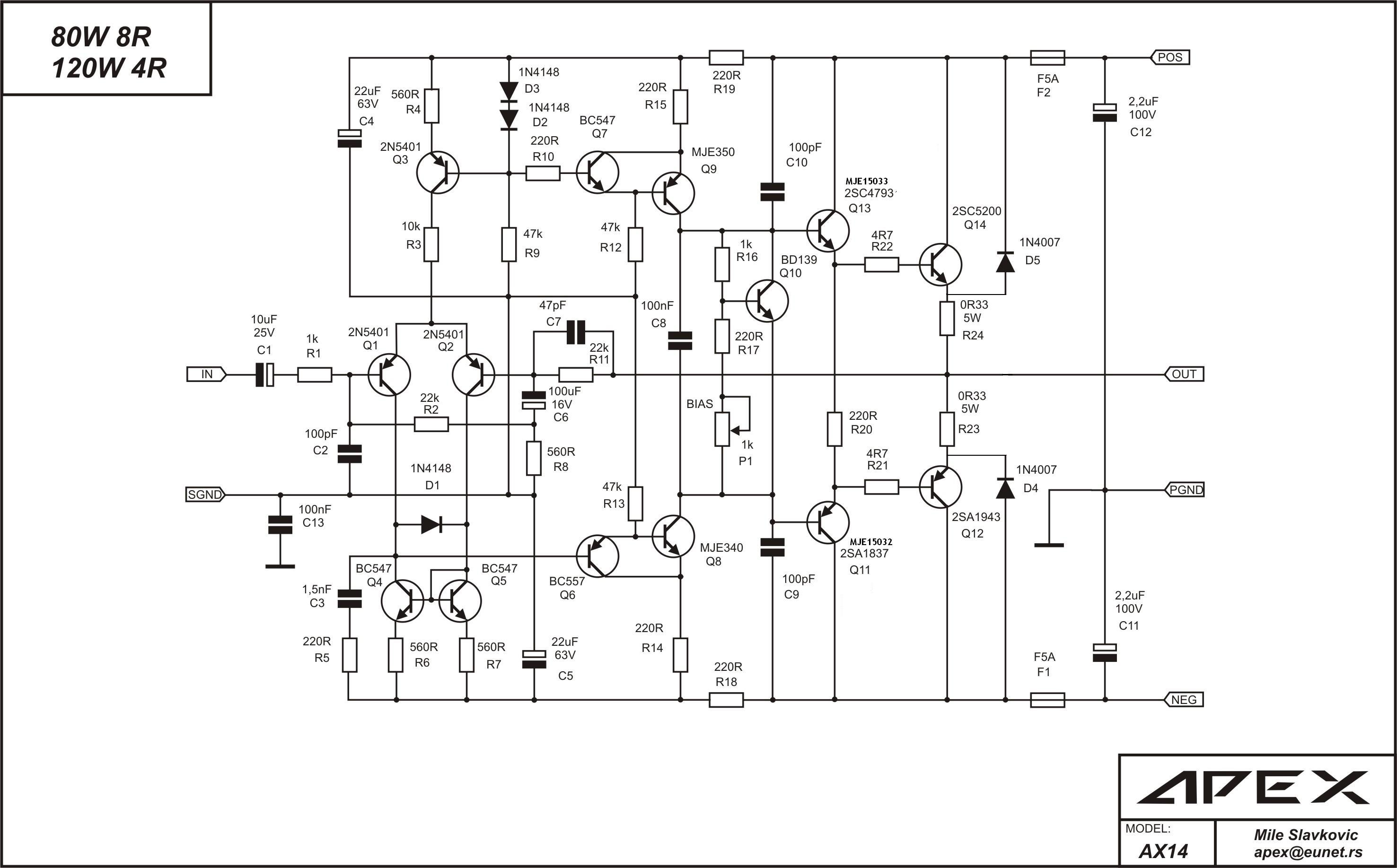

Hi APEX, i like you schematics. Thank you fr sharing!

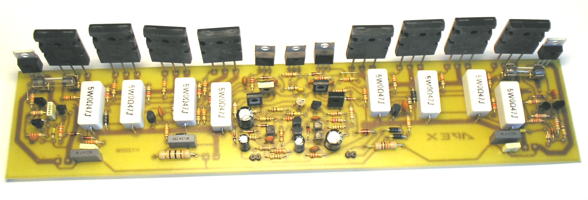

It looks to me nice and simple enough to try a a DIY ! I was reading all the thread :p, and I found it very interesting. Since I tried to understand it all, Can you explain me why you have C3-R5 (Wahab at beginning had some words) and why D1? Are they necessary ?
And then that R3, won´t be better to split it in two emitter resistors for the LTP? Look, I am sure 100% you design is OK, I am only trying to understand a little bit how it works.
Thanks- ATX

Hi apex,
Looking forward to build ax14,I want to build a stereo set.
I am having a pair of 2ski530-2sj201,2 pairs
2sc2922-2sa1216-2 pairs
mjl21193-21194-5 pairs
can you suggest if i can use these for ax14, And what would be the optimum voltage to be used.
Also if i use higher voltages than recommended what precautions should i take-will bigger heat sink be a good option
what would this amp be class -A or Class-B
Also i want suggestions as how to get 300 watts rms with this amp.
I need to for tower speaker which have 2, 8inchers in 1 tower and rated at 200 watts rms at 8 ohms per woofer, so 2 woofers mean 400 watss rms
i used to diy a long back, its been several years, so i would need your guidance.
VAS from AX-14 can work with +/-120V DC rail voltage without change, with output stage upgrade U can get 500W/8R. I also use MOSFETs for some versions...

I suggest U to build AX-14, it's 'The Best DIY Amp Ever'. If you realy want to build diy amp no need to planing, colecting schematics and parts... and wait a year or two, like most diyers on this forum, AX-14 U can build for fun over the weekend and enjoy... 100W is more than enough for home listening.
I have seen the reply on this post.
But I have a question on the same subject. Coud the amplifier work anyway, altough with a different (shaped) passband, WITHOUT those 3 components? It seems to me a very good design to build but I am afraid of what can happen in case of unwanted clipping.
effebi
effebi
AX-14 have perfect clipping behaviour (posts #52, #64... http://www.diyaudio.com/forums/solid-state/173094-diy-audio-popular-amps-simulations-6.html) , don't change anything just use latest schematics.
Regards
