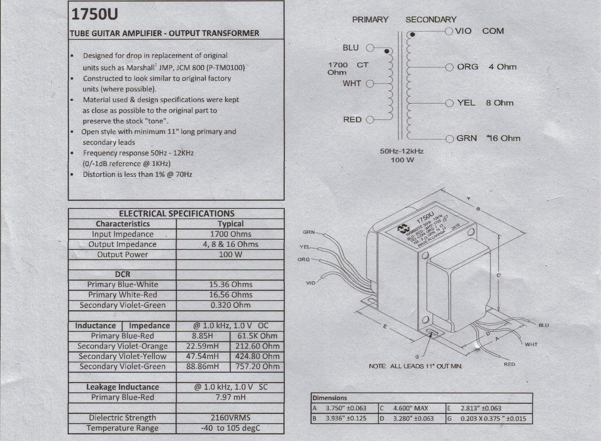

I Bought an amp that have just had the output transformer replaced. The owner said she used it once fine and then it started blowing fuses.
I set up a current limiter and everything started up fine after five minutes of playing without the limiter I got blue sparks through one of the power tubes and the slow blow fuse blew.

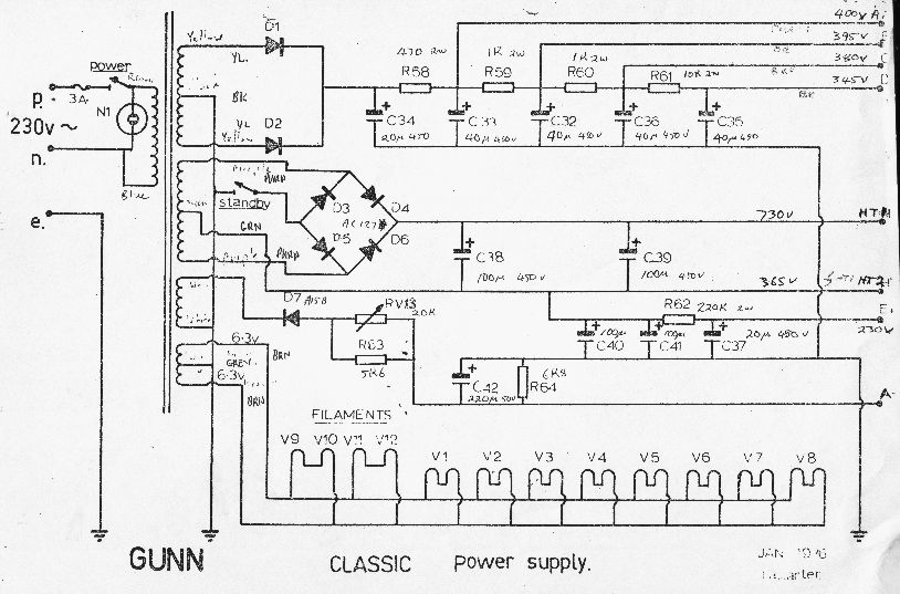

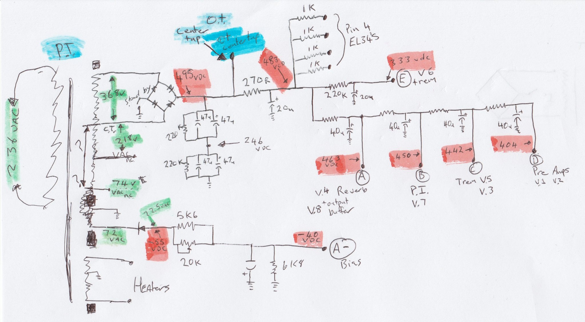

The PT and the OT are not original. I have sketch out the power supply So not sure of which windings are connected Because I haven’t disconnected.

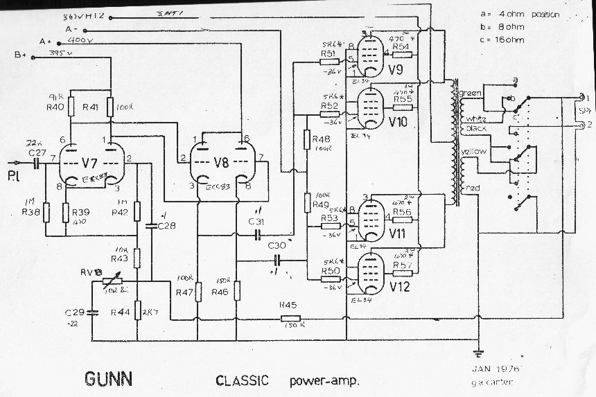

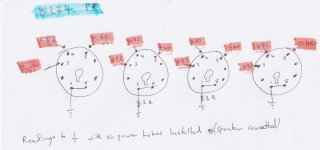

*I notice when taking readings with no power tubes pin3 Create scratching sound in speaker.
*I test for vac on bias circuit. noticed 22 vac On negative bias Circuit Close to diode Then no vac 10mm up circuit futher , Only the -40vdc negative dc bias.
*I question the power supply. original schem. has a lot higher voltage730v vs 495vdc to OT primary centre tap (ht1 on schematic) than amp has now.
*the two 220k resistors Jumping the filter caps straight after the rectifier.

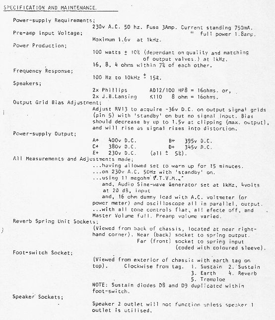

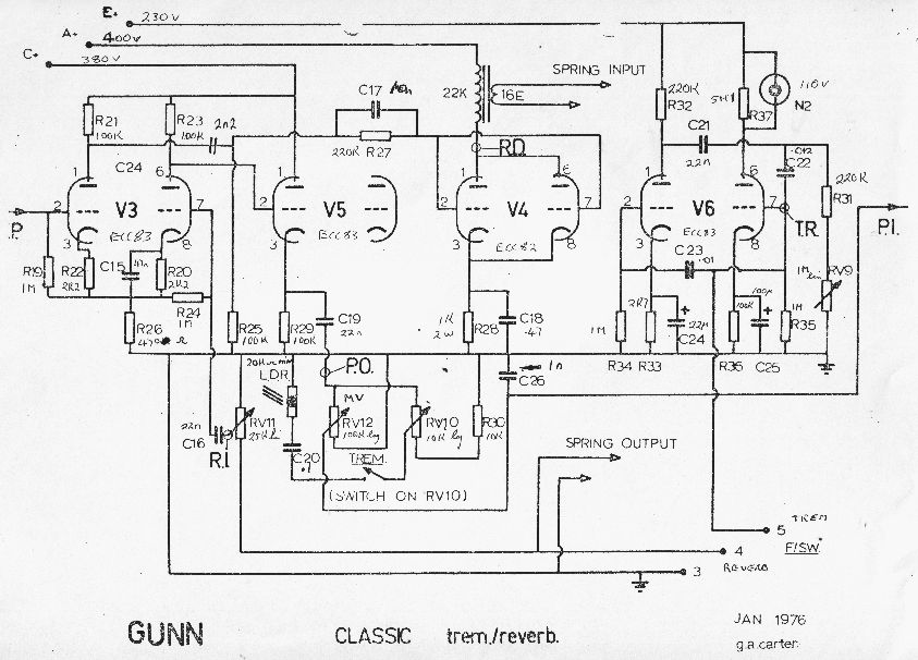

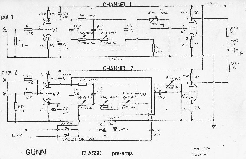

original schematics

If you have 730v on the anodes, (EL34 is happy up to 800v), -40v bias is not enough. Nearer -50v before the current is correct.
Check what you have available and of course, ensure the main smoothing capacitors are rated to a high enough voltage.

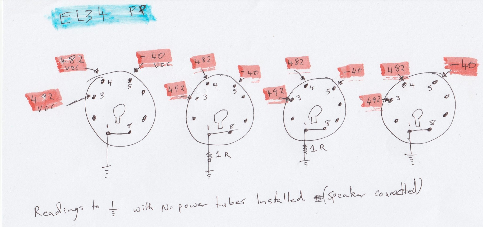

with the PT and ps design that is in the amp now I only have 492v pin3 at the anodes and 482v at screen pin 5.
I dont Know how long the Amp has had this different power supply in it.
I wonder because the original design has a larger voltage difference Between anode and Screen.
Is it likely to affect the Amp only having 10 V difference between the two?

Thank you the power supply and voltages and grid resistors checked out fine.
I think it may have been a bad tube and/or bias.
I rewired The series parallel Heater wire combinations So it would run at 50w with two power tubes at half output impedance and reset the bias. It is working fine now. I don’t want to put the other tube back in because I have no way of testing it and I think it may have been what originally took out the output transformer.
