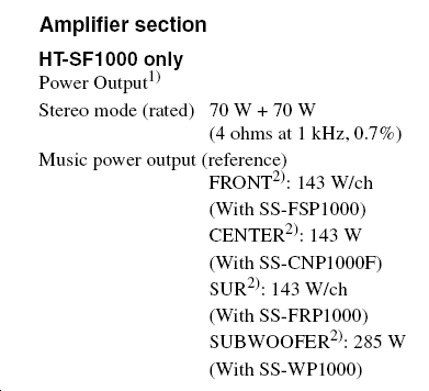

Does anyone know of an amplifier that can produce around 100watts into 1.3ohms.
It is for a sub-woofer I recently got of a friend, it is a SONY SS-WP1000.
The Specifications are attached go to page 57 on the PDF for more specs.

First off, the 100W is peak power, not RMS.
Two sections of the LM4780 chip-amps paralleled will drive it quite well. National Semiconductor recommends using a 0R1/3W resistor on the output of each section of the LM4780 for parallel operation. A paralleled LM4780 would be capable of 120W peak power. Application note at the link.
http://cache.national.com/ds/LM/LM4780.pdf
130W peak into 1R3 requires about 16V peak, or 12.4A peak. Looking at the data sheet we see that we are OK for two paralled sections.
You will need a transformer in the range of 24VCT~28VCT at 4A with a 25A bridge rectifier and a pair of about 15,000µF/25V caps.

Guys, this is a low-end driver from a 5.1 Sony package HT system. Originally, it was probably powered by a 70W chip. Specs list the system as 28-20,000Hz, which could be -3dB, -6dB or -10dB (international system of mystery :)).
Simply using your multimeter to see what the Re of the speaker is might give a bit more of an indication of what the speaker actually needs - I doubt it would be 1.3 ohms when you measure it. My guess is around 3.5 ohms.
