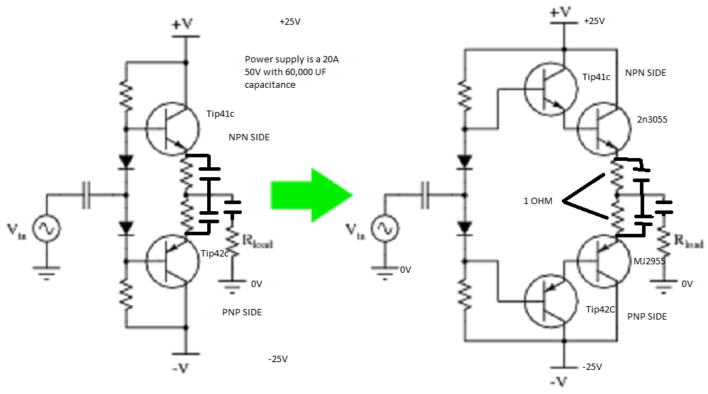

I have also built a Class AB push pull output stage with tip41c and tip42c complementary pairs so if you can suggest a good book for my skill level I would appreciate that. Yes you're right I'm pretty green at this, only been at it for 6 months or so as a part time hobby but so far really enjoying it! =)
For all reading this -
I do have a working class AB amplifier which will take line level signal and boost it to speaker level but I want more volume.
I realized after cranking up the voltage a little (Yep it got louder!) I got more volume from the amp but then my components were under rated in both terms of voltage and current so I decided to do the whole thing again but just make it bigger with 2n3055&MJ2955's instead of tip41c and tip42C (To-220 upgraded to To-3 package) Just incase there is anyone here that are unfamiliar with the transistors I have listed. Used higher voltage caps & bigger resistors and wires and a Huge transformer I found inside a powered sub woofer on the side of the road. I'm not sure what it's current handling capacity is but it's HEAVY! Torrodial type - I'll post a picture of that too.
SO yeah, I put all that together (Yes I realize the to3 transistors require heat sinks so I havn't even powered it up yet)
Before I start just randomly upping the voltage to get more current I thought perhaps all I need is more current gain?
So I'm playing with the idea of using a a complementary darlington pair for my output stage but I'm scared as last time I tried to make a darlington pair on a breadboard one of the transistors just overheated instantly.
I've done the maths & have it written down somewhere but I came to the conclusion that I will need SEVERELY limited base current going to the bases of the tip41c & tip42c's in order to get an acceptable idle current flowing through the collector emitter regions of the to-3 transistors. Am I right?
I'll post a schematic of what I intend to do.
Any input would be appreciated. Thanks in advance!

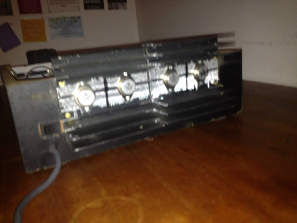

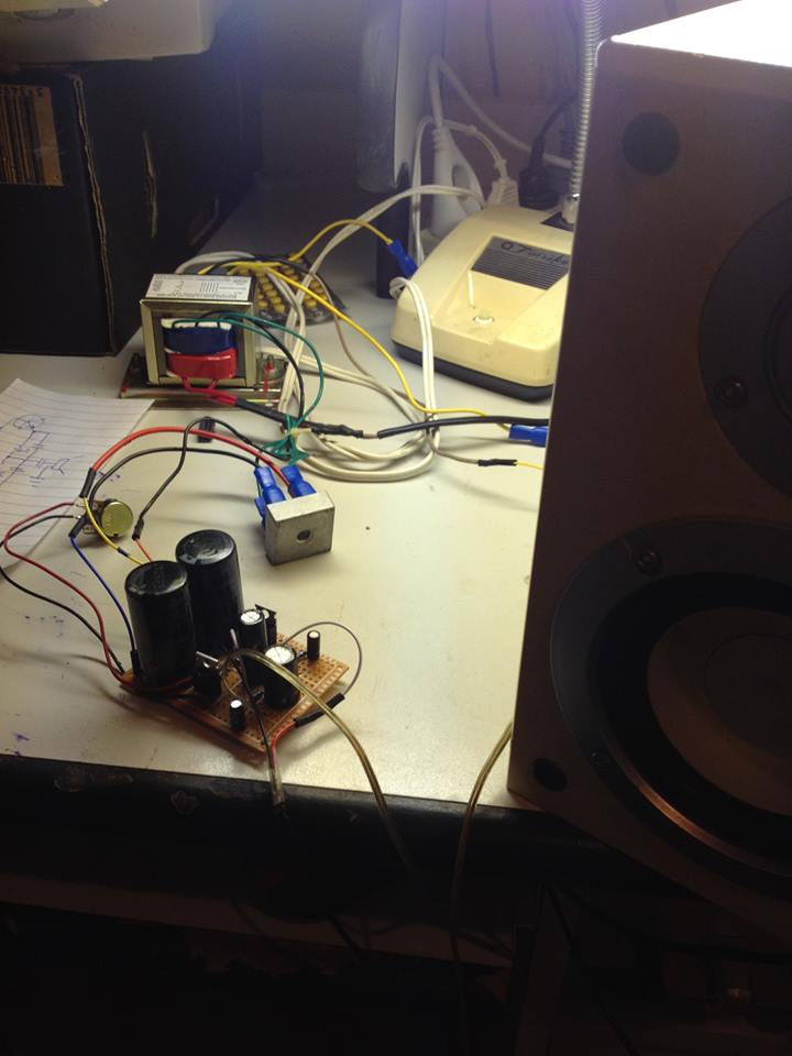

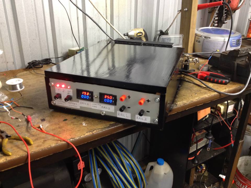

If you think that I am lacking fundamental knowledge I will go back and revise and I'll let you know if I come across any good books, everything I have learnt so far has been from web pages, forums, you-tube and experimentation.
I've completed a couple of projects - Duel DC variable power supply & the picture of the prot board is the class ab amp I mentioned earlier. (I'll post some pics) =)

Ok so nobody has replied but hopefully someone will soon.
I managed to get the darlington pair push pull output stage to work and it works really well!
Two things are annoying though -
I am using an NE5532 op amp before the output stages and unless I turn the gain all the way up (I assume this would be voltage gain?) using a 10k pot the amp is still pretty quiet. Since the NE5532 is a duel op amp I decided to run another gain stage through the other side of the chip. It works but unfortunately clips too early.
It's loud (almost too loud for the room I was in) but clipping when I don't want it to. I'm after volume without distortion so I'm guessing that the op amp is hitting it's supply rails which are -/+ 20v Or 40V peak to peak.
I thought I would get around this problem by changing my power supply to a larger transformer that is +/- 38V or 77v. But wait, the Ne5532 is only rated for +/- 22V Or 40v peak to peak max so I can't do this.
Should I just use an op amp that will handle a higher voltage? If I do - will it mean that I will get more voltage gain without it clipping too early?
If this is the answer then could someone suggest a suitable op amp that will handle 77V peak to peak please? I read somewhere that this problem could be avoided by simply adding in a couple of voltage dividers to give the op amp it's lower voltage but this does not solve the problem with the amp distorting at a low volume level.
Thanks in advance =)
