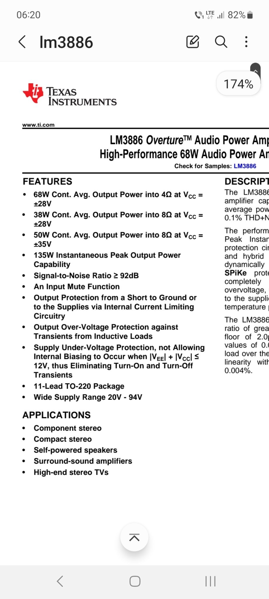

The transformer is undersized (I've seen recommendation of 1.5x expected output power) but what does "undersize" actually mean?
Is it undersized on high volume only or undersized for any volume level? (I believed if the amp is class A then I would expect to have problems)
Thank you.
eDIT1: or when there's a low frequency tune (lots of bass), it'll be undersized even at low volume?
EDit2: 2x 4A 25VAC (for a transformer rated 100VA) for the secondaries and using unregulated supply. (just a rectifier bridge + some capacitors)

It will be "undersized" at continuous high power.
See for yourself at normal listening levels if it gets to warm . what amperage is the transformer rated? what rail voltages ?.
@mrjayviper
datasheet suggest +-35 on 8 ohm loads. ( if you use 4 ohm speakers on that rail voltage use big heatsink maybe even a fan and don't push it to hard. Check how hot it gets . )
( I ran tda7294 100w ic on +-40v on 4ohm, would get very hot )
What impedance are your speakers?.
4a on 25vac is fine. You'll get around +- 35Vdc , 25 × 1.41 = 35.25v, in reality it will be less probably and rails will sag a bit under load.
You'll be fine for 2x 40w or so , either 4 or 8 ohm loads.
Go for it but check the transformer if it overheats.

It should be fine for normal domestic listening levels.
I've built many A/B amps with a 1:1 ratio and found the transformers barely warm up at all.
Undersized means the transformer will run too hot and the supply output voltage will sag causing the amp to clip.
The transfomer data sheet may have a spec for allowable temperature rise, which is usually in the 40C - 50C range for a toroid.
As long as it operates below that temp after running for an a hour or so at your levels, it will be fine.

@mrjayviper Yes on secondaries, one fuse on each rail , after bridge rectifier, caps.
if the amp outputs 50W on +- 35v rails, using ohm's law : ( P = V x I ( Power in W = V in voltage x I in current Amps ) , 50w / 35v =1.42A ) it will draw 0.7A on rail (0.71A to be exact) (25w + 25w ) , each rail being half of the waveform , assuming class AB 60-75% efficiency , 50W x 0.7 (70% efficiency) = 35W, another 35w wasted as heat, 17.5W per rail, 17.5w / 35 = 0.5A, 0.5A+ 0.71A = 1.21A.
So 1.21A per rail , if stereo , 2.4A per rail. But with more current draw on peaks, you can increase that value.
3A fuse per rail would be good.

1. Fuses in each DC rail between power supply output and the connections to the amp boards. Many commercial amps do not have these but they are good idea for DIY projects because accidents do happen. Fuse rating can be about 3 A, derived from 100W /35V = 2.86 A for one fuse feeding both channels, Or use two 1.5 A fuses with one for each channel. Fuse type here should be "fast acting".1. do you mean a fuse on the secondaries?
2. how would I determine the fuse rating?
2. Mains fuse rating is determined by 100 VA / 240 V* = .42 A. Practically speaking, I would round this up to 1 A and this fuse type should be a time delay or slow-blow.
* or your mains voltage.
