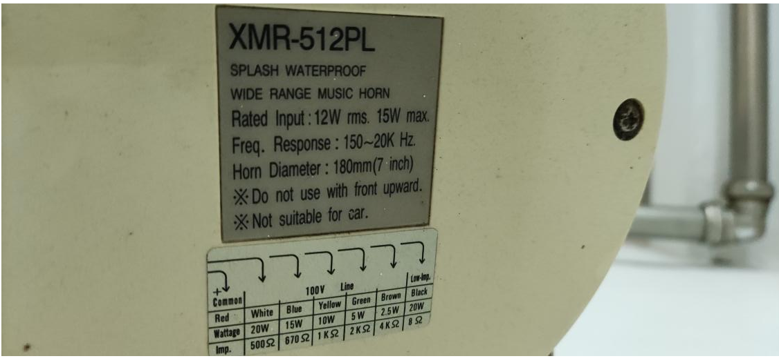

I took a peak at the speakers. XMR 512PL.

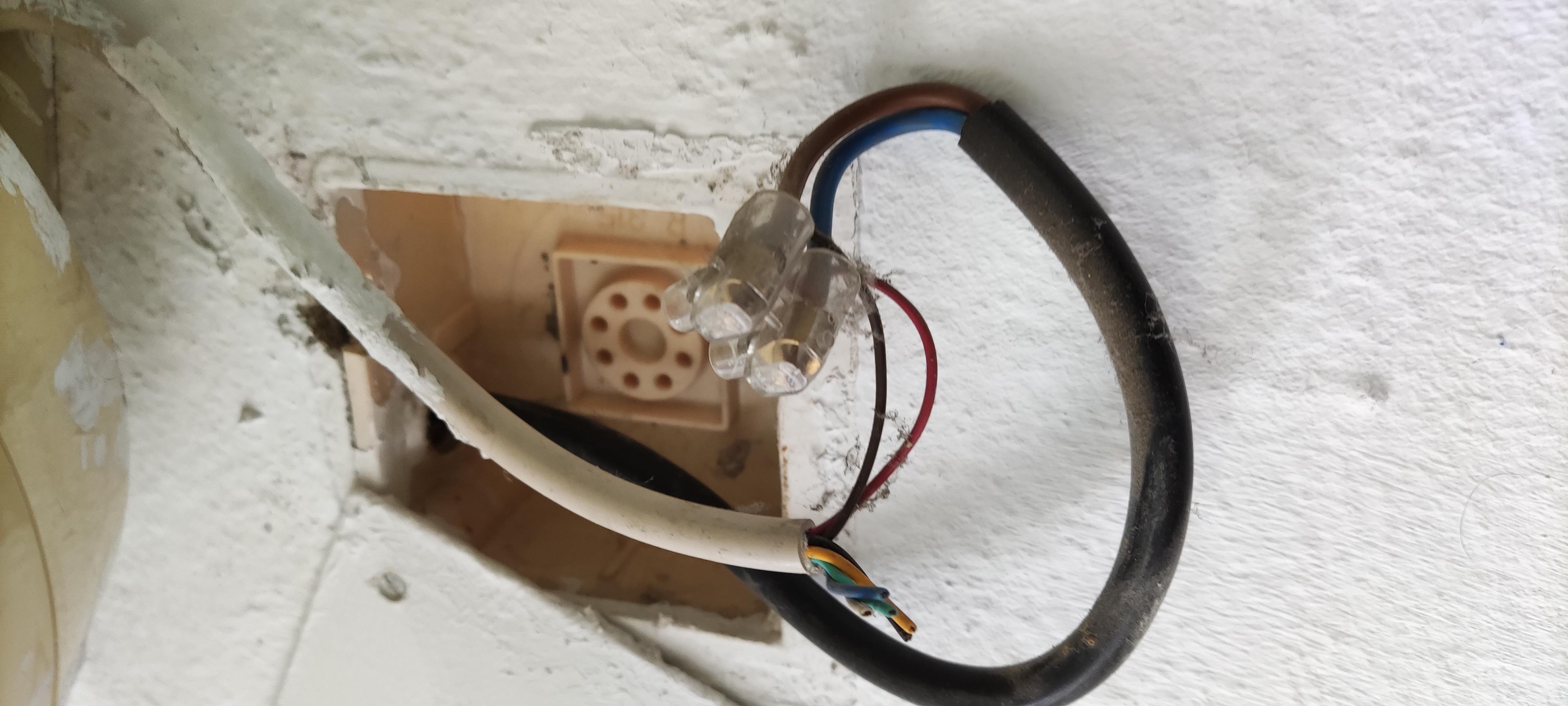

I fished for the cable (black one) and it went into 3 other speakers (4 in total in parallels).
All connected to the brown tap (2.5w) of the speaker for a total of 10w.
To test them I tapped them to black tap of the speaker transformer and pugged it to a mobile phone via AUX set up.
They work but very low volume. Understandable. I reverted them back to the brown tap and checked the old stuff they had stored.

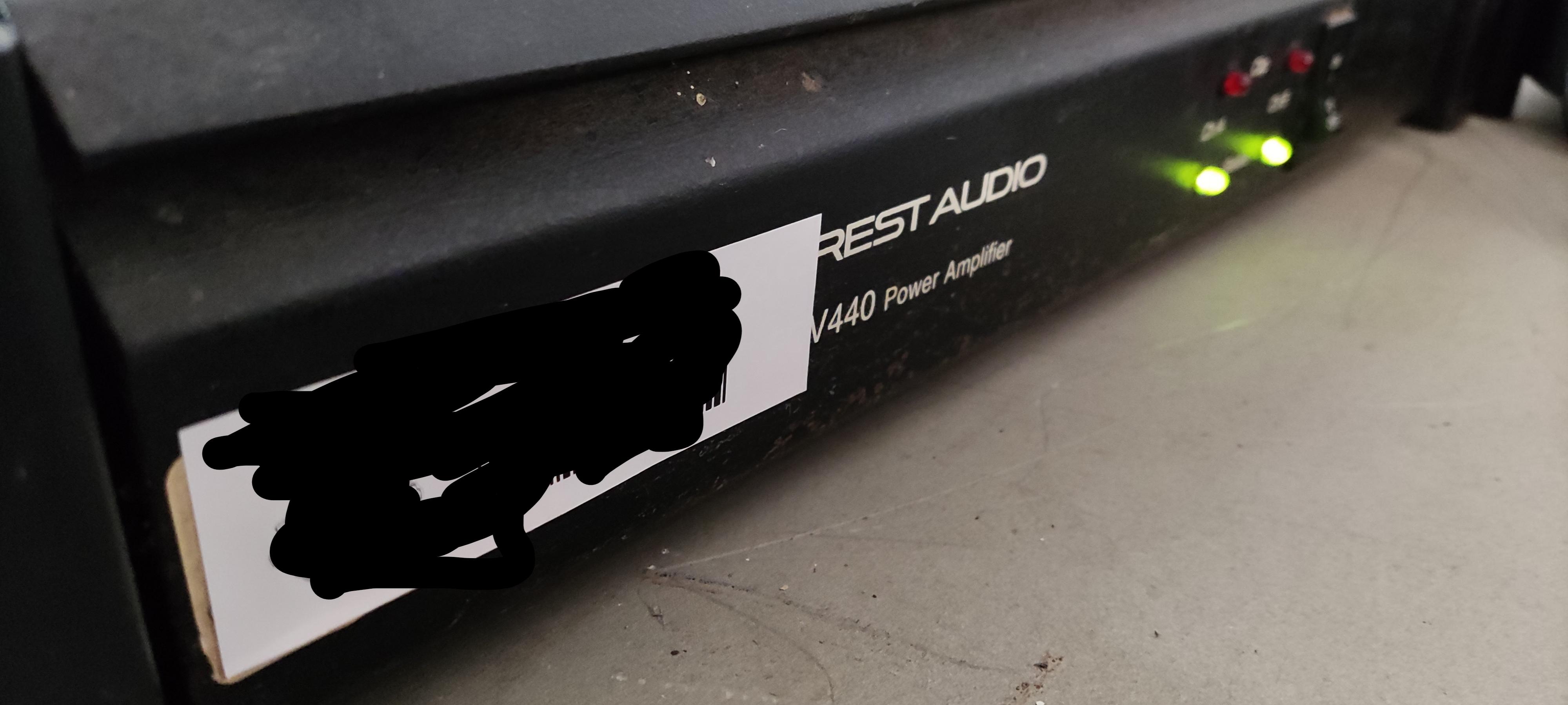

Crest audio FCV440 power amp.
Now this thing is a beast and it obviously drives these 4 speakers at 2.5w but its school property and its not something I want to risk malfunction when someone comes asking for it.

These distributed sound systems use transformers on the speakers and the amp to spread the output power of the amp evenly among all the speakers. In this case for example the amp produces 220w/ch so in theory it could power 11 of those speakers to 20w or 15 to about 15w. This system is by far the most economical way to get sound to that quantity of speakers, the wiring necessary is very modest compared to the low impedance option where cable losses have to be factored in which makes covering long distances impractical.
So it seems like this gear still works, you made a mistake with the wiring change and should have moved the speaker connection to one of the other transformer taps, you got low sound when you moved it to the black tap because there isn't a direct connection to that back at the amplifier when it is wired for 100v operation.

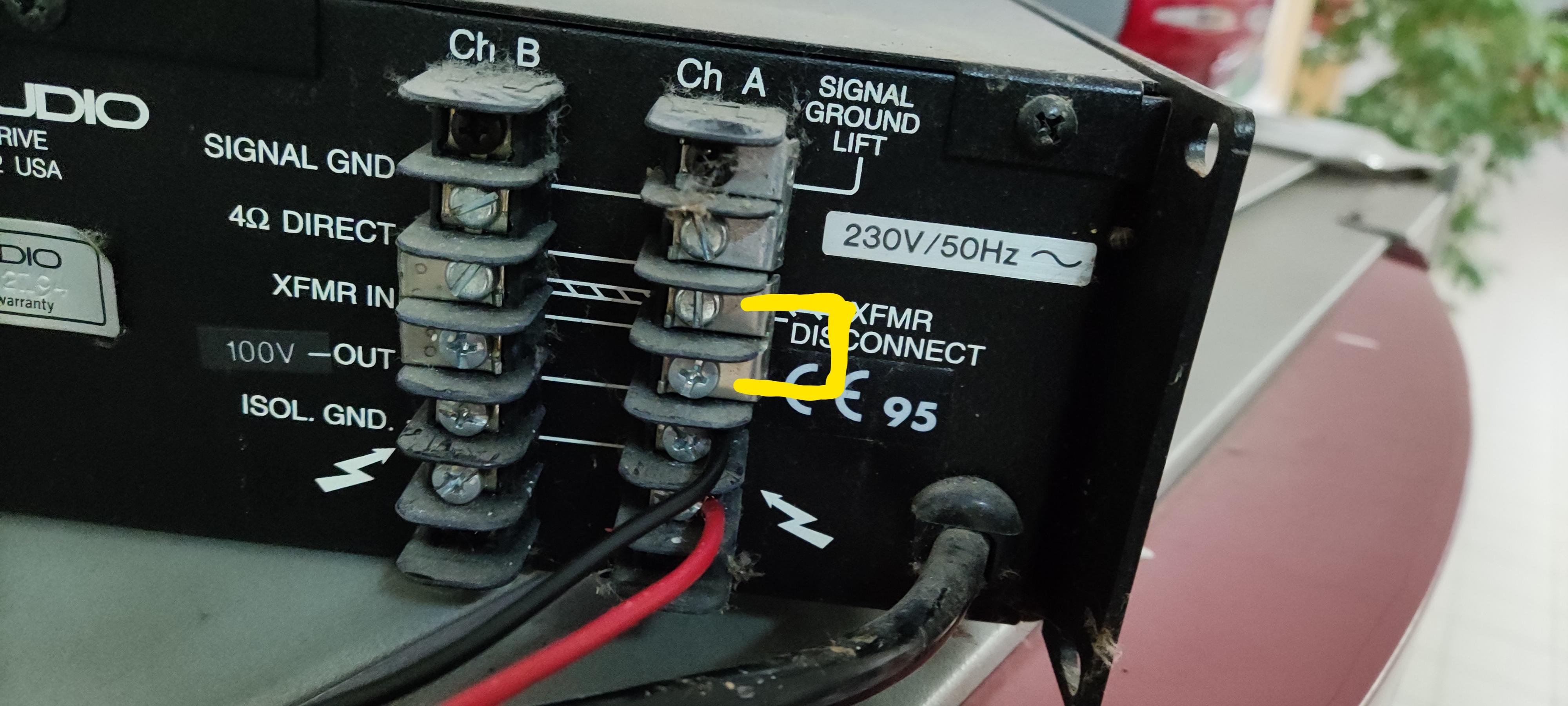

Can you post a picture of the wiring connections on the back of the amplifier?

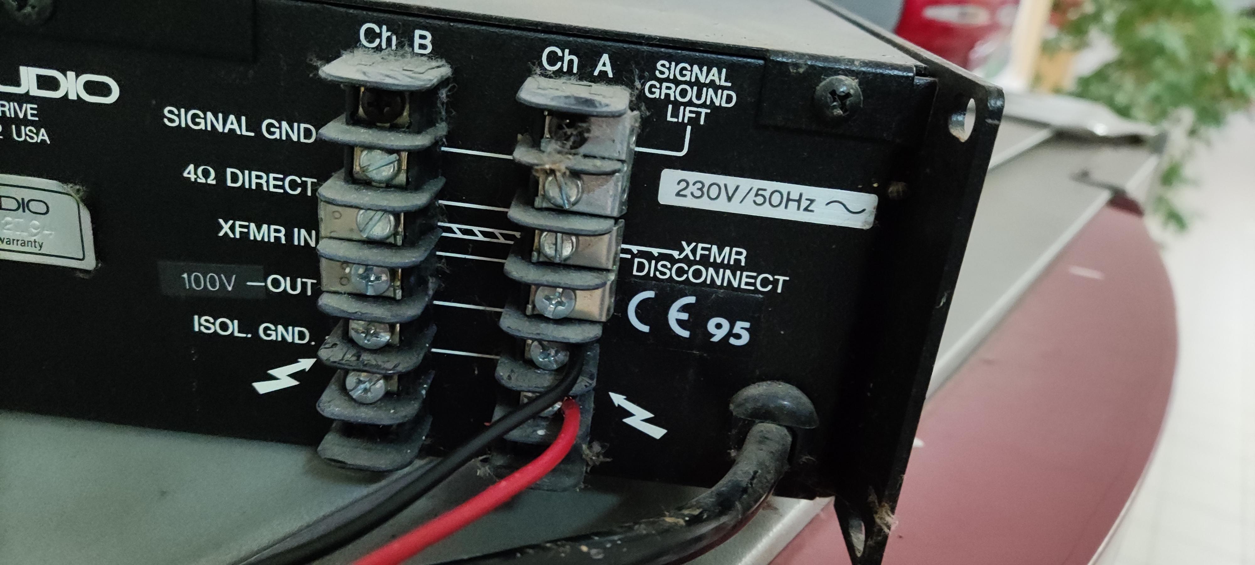

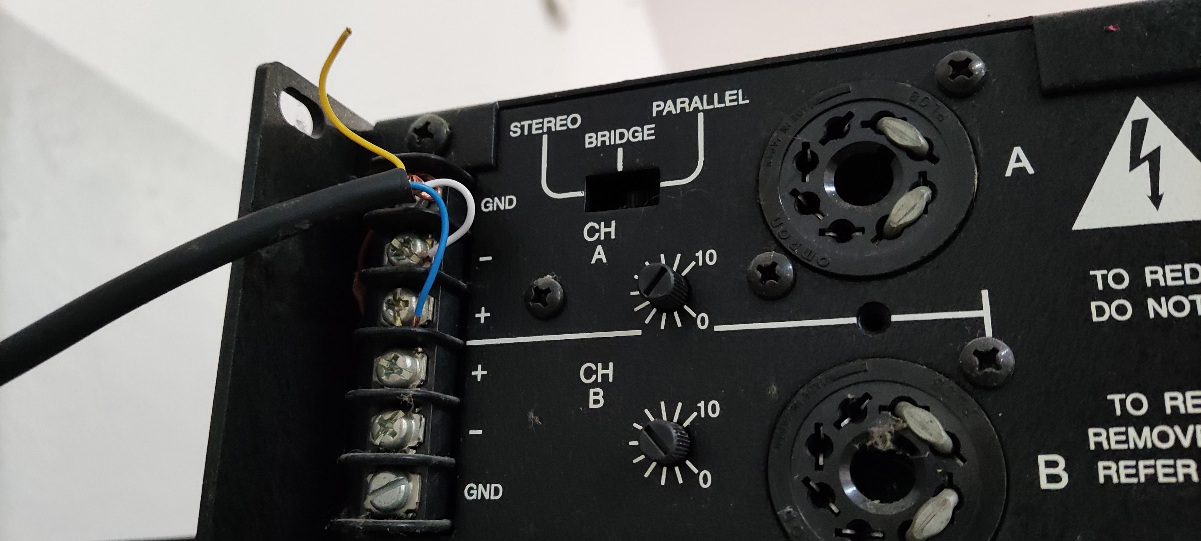

yes, this is how i tested the sound with the 100v line amp.
For input its an AUX cable connected to phone. Blue positive, White negative and ground is the shielding.
For output i wired it directly to speakers as it was originally set up to brown tap 2.5w each.

A couple things.
You should not connect a stereo signal to a balanced mono input because everything common on the stereo signal(usually all low frequencies and vocals) gets canceled. So you either need something between the source and amp to convert to mono or just use a single channel.. ie disconnect the - wire. For testing purposes this should work fine.
The output transformer is isolated so a small jumper has to be installed to get signal to it, so get a short piece of wire and install it between the 3rd and 4th screws on the output barrier strip labelled "4ohm Direct" and "XMFR IN"

oh i see, i will try conecting both.
I tried disconnecting the - signal, but the sound went dead. So i connected + to the + of channel A and - to the + of channel B. set it to stereo instead of parallel and it worked but it was humming so I disconnected it again.
I will try tomorrow with both lines on + channel A.
I do I put a jumper between - and ground ? or just leave ground disconnected ?
Thank you for the link, that is very helpful.
yes i did.
the manual says inputs are actively balanced.
for use with unbalanced source, tie the inverting (I assume the - ) input to ground, if left floating a 6db loss in gain will result.
With the input selector switch set to parallel the CH A input signal is sent to both output channels.
I don't mind this at all. Don't want to use bridge (no need) and I don't want stereo output.
