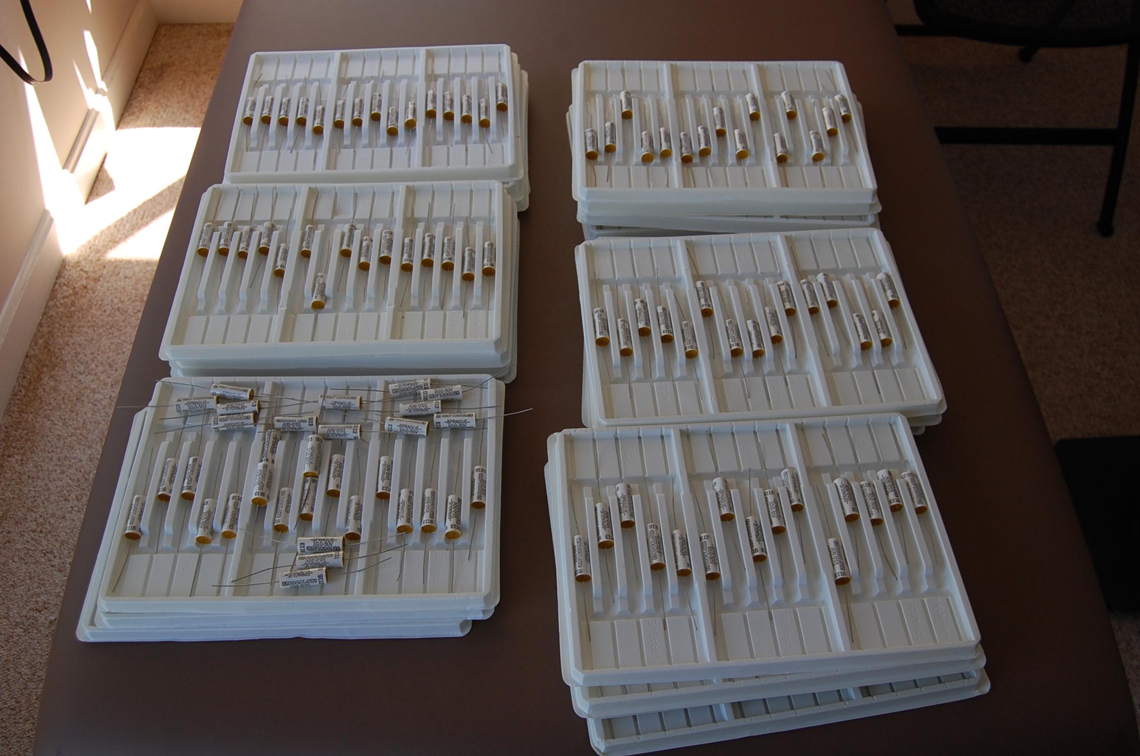

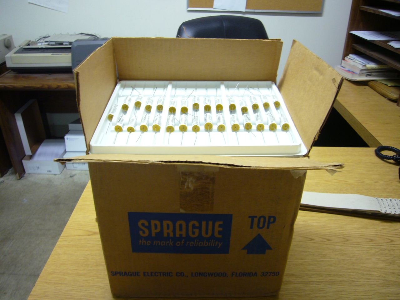

$100k worth of caps. Not as big a pile as you would think.
