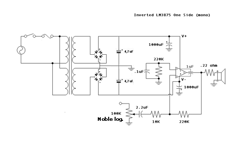

I'm building another GC using the below schematic.
I have a Noble 100K logarithmic pot, type 204.
I've seen that people recommend linear pots for GC's.
Can I compensate in some way using this logarithmic Noble? If possible, what should I do...?
By the way, why are logarithmic pots not recommended?
(Haven't soldered it in yet, so I haven't heard the amp in action with this Noble).
Thanks.

I'm very curious why they are not recommended? I used exactly the same pot in the same circuit and it works fine.
Wht is not recommended, is the 100k value. I'd rather go for 50K, but if not available 100k will work too. Actually, I tried linear pot in this location, and I prefer the action of the logarythmic one.

Thanks for your information, Peter. I didn't mean that Nobles were supposed to be not recommended.
However, in this schematic someone (?) recommends linear tapers: http://ampchipdiy.com/invertedLM3875_r2_1.gif
I will use this 100K Noble 'cause I have it already.
