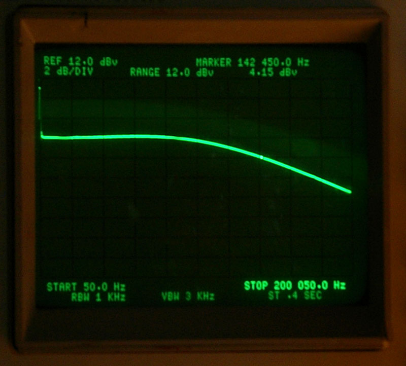

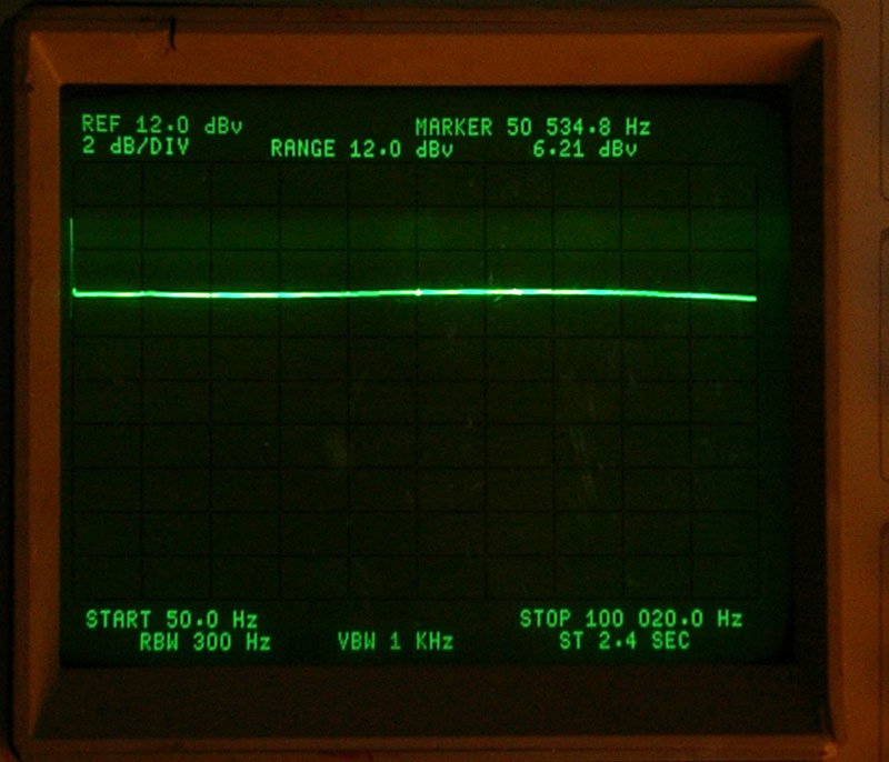

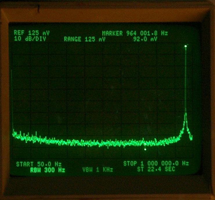

my MCD is running at 1mhz(900k~1.2M 500w version )
a picture , this is the idel output 10hz~1mhz
