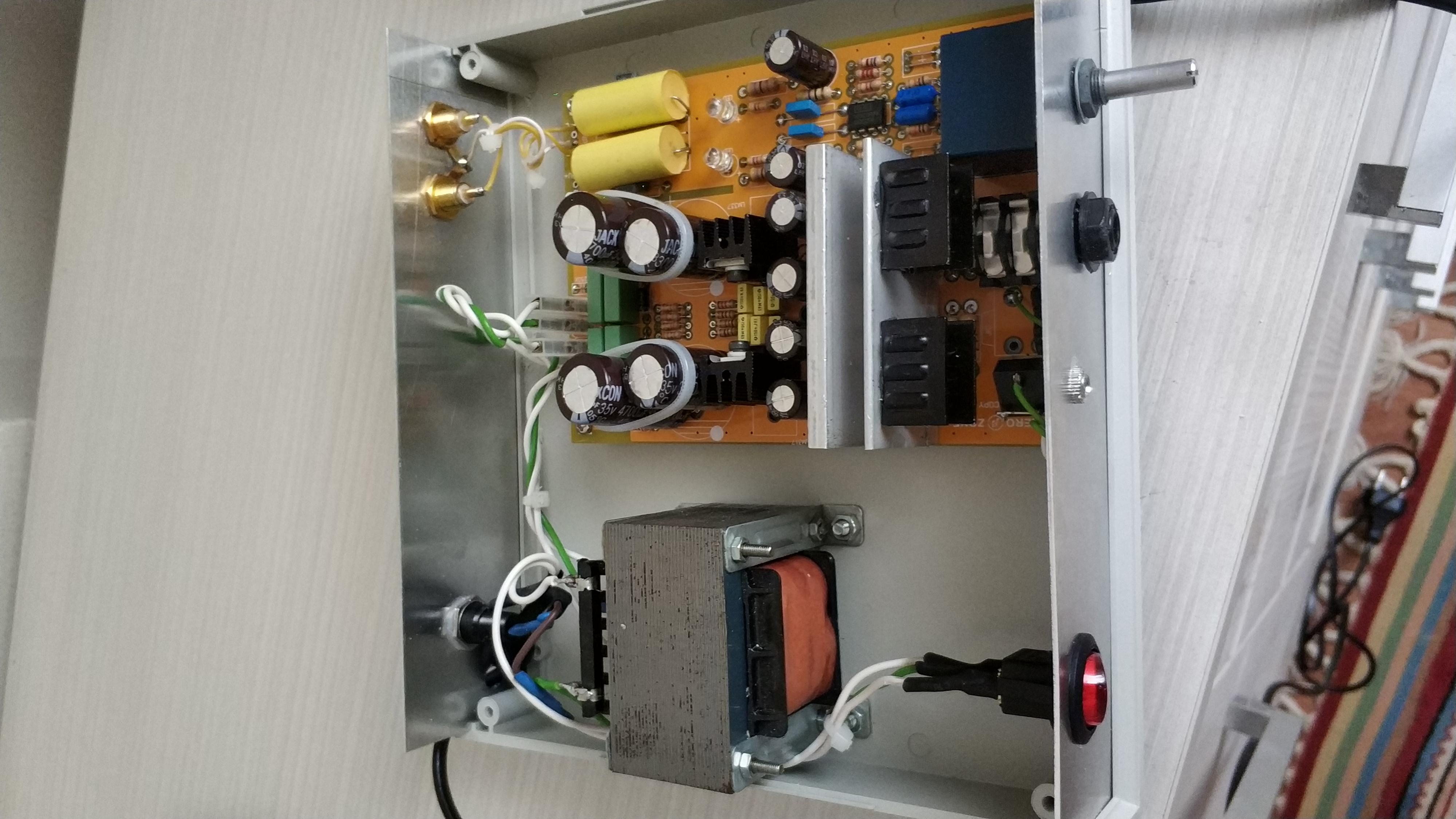

Hi, i have almost same hum noise wit my lehmann clone the only difference is that the hum is intermittent, some time it is there, sometime not.
İ think it is a transformer hum at 50Hz. İ wonder whether it can be solved with the same grounding operation or not

Here is the my L clone, generally the hum is gone at night hours, the amp working well and powerfull all the time, the hum is independent from the volme pot
Hum 50 Hz or 100 Hz?
I guess your transformer too close to PCB... 🙁
100Hz i think.. i compared it with the 100Hz sound from tone generator
I suppose that it's pcb with buggy ground.

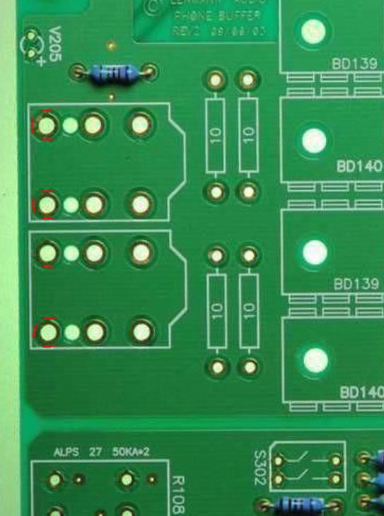

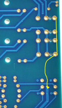

Very old thread, But I'm gonna chip in:
All the ground optimizations in this thread are good to do, but the most important, and smallest i believe is cutting off the ground loop on output jacks. They form a huge ground loop from the output right to the power supply part.
See attachments:
First of all, gotta remove the jacks. Then cut off traces along red lines. Check with multimeter if none of the points conduct to ground anymore. Then, checking the other screenshot, connect the ground points along yellow line to the trace between potentiometer's legs - it goes straight to opamp decoupling caps.
This changed got rid of the ground loop completely.
You are free to do other changes too though - looks like this pcb is a crap fest of ground loops so every fix here has a potential to improve sound.
