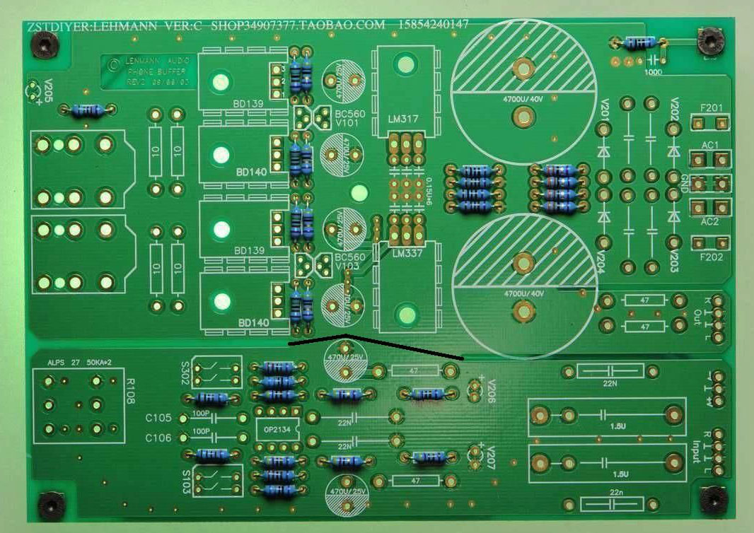

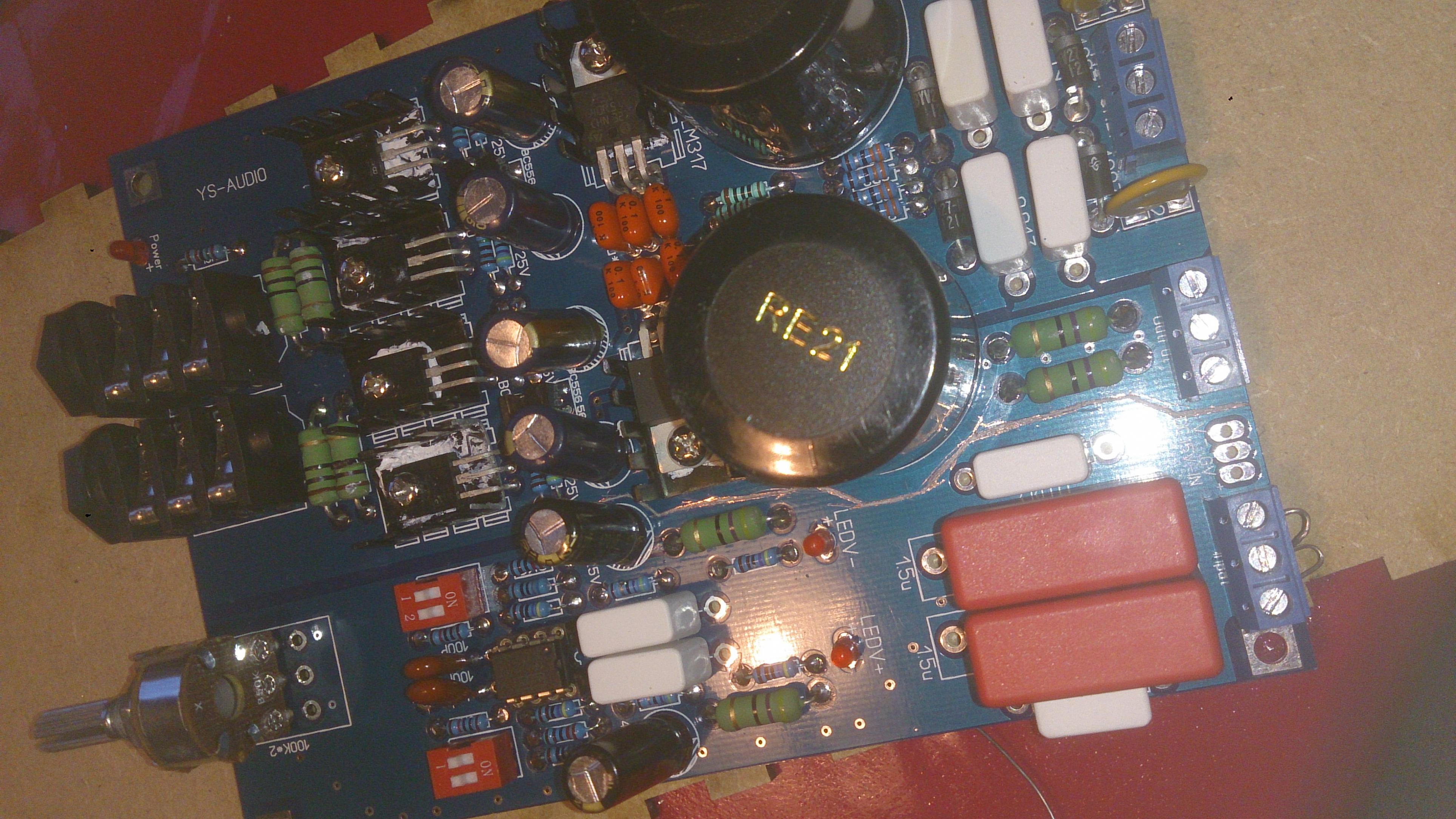

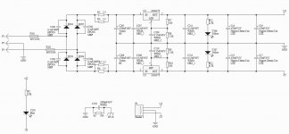

I have a 100Hz hum in my Lehmann linear clone.
It is constant, the volume knob does not affect it. I am certain it is NOT a 50Hz hum.
The hum stops when i pull the plug (the music goes on for a few seconds because of the large supply caps). So i am certain it is rectifier-related.
It is barely audible with my most efficient headphones. But it should not be audible at all.
Does somebody have any experience with this problem? Especially Lehmann Linear clone owners (Lovely Cube etc)?
The board is a cheap board from aliexpress, but I have replaced all the semiconductors in case they were counterfeit. I used output transistors with about the same hFe (BD-139-16 and BD140-16, the 16 indicates the hFe group). The driver transistors were upgraded to their low-noise variants.
I also upgraded all but the largest electrolytics to Panasonic FC.
Input caps were changed too. All other components were measured and tested OK.
The diodes (1N4007) were replaced with something I had laying around: BYV-27. Those are ultra-fast recovery diodes (for SMPS), not really meant for audio applications. Can those be a problem?

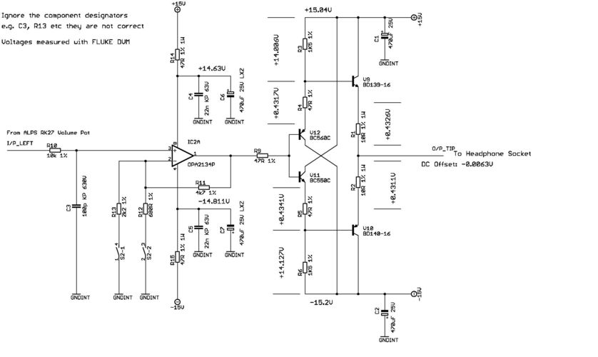

I measured about -20mV DC offset on both outputs. Isn't that a little too much for a headphone amplifier? Inbalance in the output stage might explain the hum. How can I correct for this?
I cannot measure 100Hz hum on the output with my scope, it is not sensitive enough. The only signal I can measure is the DC offset, and a 10mV RMS 100Mhz signal (Radio interference?).

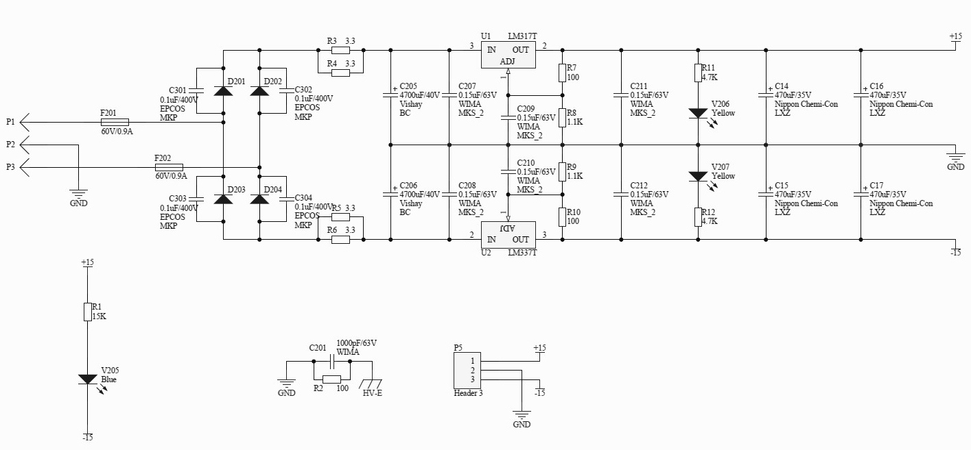

Any ideas? I included the schematic.

dissconnect the transformer centre tap P2 from ground and connect it directly to the junction of C205 and C206 so that the charging pulses go straight back to the transformer and not through ground .

Thanks for the advice.
However, I tried it and it does not help :/. Signal ground and power ground is seperate, btw.
What do you mean by that... two connections to the chassis? Then you have a ground loop. All ground connections eventually go to one point... safety earth.Signal ground and power ground is seperate, btw.

No no, only one connection to the chassis, but it's not a direct connection, there is a resistor in between (power ground =/= signal ground).
It's not a ground loop (that would be 50Hz i think).
I found out something else: Changing the gain setting on the preamp makes the hum louder or softer. So the opamp in the preamp reacts to this.
I tried replacing the opamp (an OPA2134) with a spare NE5532 i had lying around, but unfortunately, on of the pins was bent and I didn't see it. All I heard was a loud 'pop' and now my headphones are dead, so probably big DC on the output.
I can't test it anymore, because I don't have a spare pair of crappy headphones lying around...
By the way, maybe the preamp reacts to ripple on the power supply or large current spikes from the big power caps charging. This might be because I replaced the preamp's 470uF capacitors by 1500uF Panasonic FC (I only had these lying around). They also have very small ESR so big charging currents...

100Hz or double the mains frequency points to issues with your power supply at the secondary, mainly your caps but can be a bad regulator too.
Double the frequency due to AC to DC retification.
Or if it's 100Hz fundamental but with higher order components (e.g. a chirp that happens 100 times a second) I would suspect rectifier. A scope with FFT comes in useful, or a sound card and you can download either ARTA or Audacity to do the FFT.
Does your rectifier have all sorts of fancy snubber caps attached and are you using some fancy fast or low dropout diodes. How is your ground routing? And how symmetric are your + and - rails and what is the impedance of +/- and ground? All to consider when troubleshooting.
The main supply caps are cheap and chinese 'Nover' caps. I have tested them for capacitance (they test ok) but I can't test them for ESR.100Hz or double the mains frequency points to issues with your power supply at the secondary, mainly your caps but can be a bad regulator too.
I have a scope, but it does not have FFT capabilities. The signal is so weak I cannot see any form of 100Hz signal in it on my scope. I can see mainly the DC offset, some 100Mhz interference and some other noise.Or if it's 100Hz fundamental but with higher order components (e.g. a chirp that happens 100 times a second) I would suspect rectifier. A scope with FFT comes in useful, or a sound card and you can download either ARTA or Audacity to do the FFT.
There are just some small caps over the diodes. The diodes are indeed fancy fast diodes, I can swap them for 1N4007's and see the problem is still there.Does your rectifier have all sorts of fancy snubber caps attached and are you using some fancy fast or low dropout diodes.
I'm gonna check on that.
FFT is useful in that you're unlikely to visually see a component of a signal that is 100x smaller than the main signal (or noise), but with FFT it will show up as a -40dB which is noticeably high.
If you suspect high ESR, spam more CRC filtering. Especially the R part, since it sounds like you have lots of spare capacitance.

First of all I would check whether the regulators are doing their job properly. Did you replace those as well?
The regulators have been replaced and they are genuine.

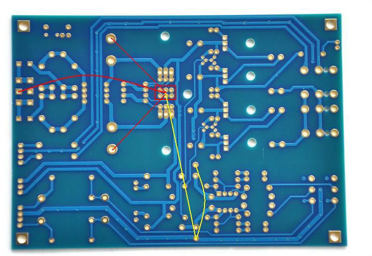

which version is your clone? I've read lots of problems like this in china's forum,
there's a solution if you really don't know what to do. make sure the version is the same though. i've never tried clone one.
Step1.
connect the 3 red lines with cable, the red square in the middle is actually same point.
this should reduce the hum to barely audible. u can stop here if you want.
step2.
cut through the black line to separate ground.
step3. connect the yellow line.
That's it. just translated for you. if you really don't know what to do next.

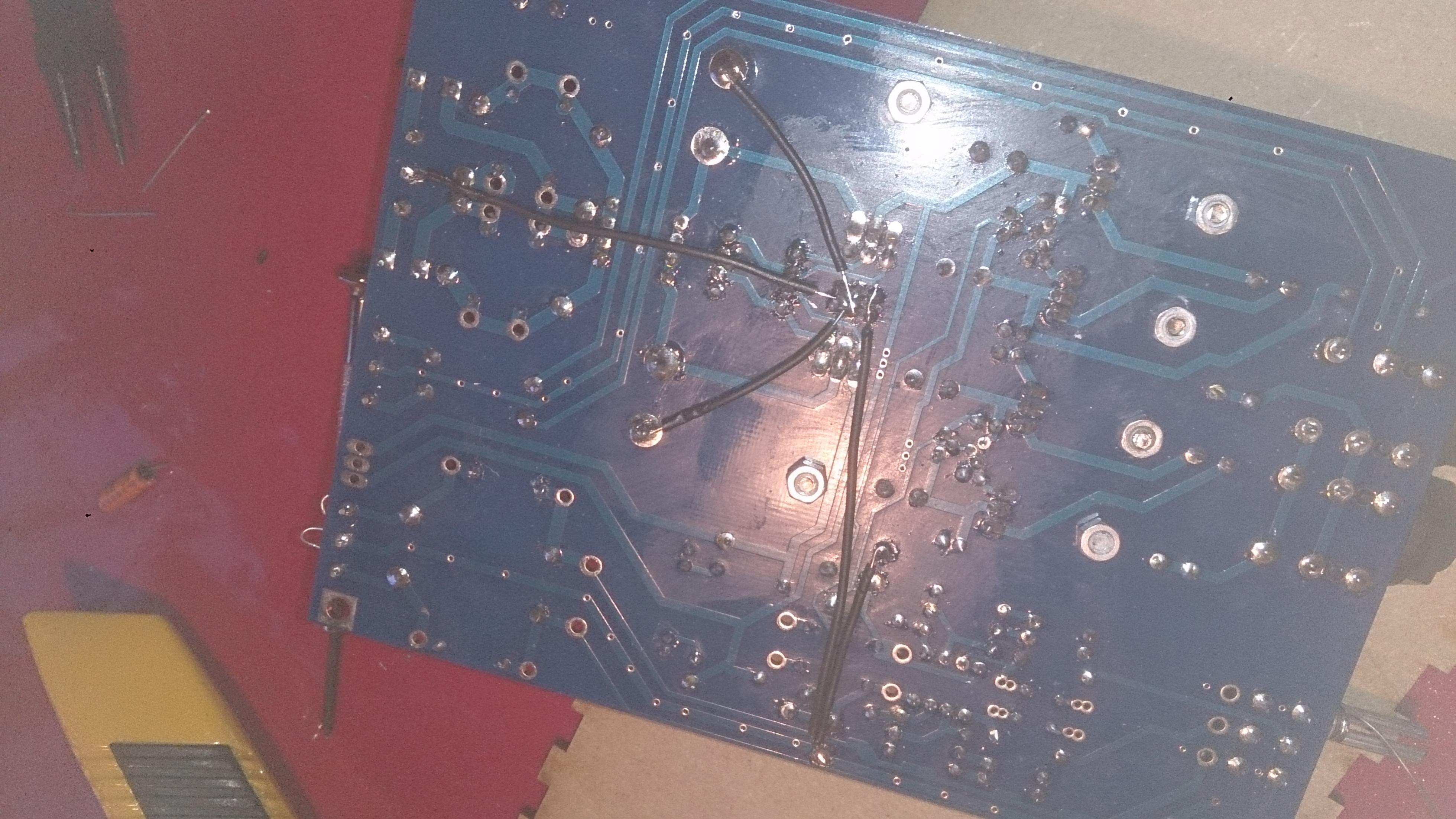

Hi, thanks all!
I measured again with the bandwidth limit on, that is indeed much better, thanks!
I measured the power supply ripple:
Main capacitors: 140mV ptp . That is almost 10% ripple and to me, that's a lot.
After regulators: 2.5mV ptp . Almost below measuring threshold, so very good.
Everything else seemed to be in order, so I tried something else: grounding the inputs to different ground points, and listening.
The "regular" input ground has a bit of hum, this was my starting point.
I then grounded the inputs to the main supply caps ground: the same hum, but much louder. I could definitely hear the charging currents in the ground path.
Then, I tried grounding the input to the - vcc opamp decoupling cap : the same hum, but almost completely quiet. Then, the opamp +vcc capacitor: completely quiet.
It definitely seems like a ground routing problem.
Flying fish, thank you very much! This is indeed my board, and it seems to be a solution to a grounding problem too... Maybe I can find another solution that does not require to cut traces.

I'm no designer, so please correct me if I'm wrong, but looking at the modifications flyingfishtw posted, I'd say the designer of that pcb put in one big groundplane and thought he/she could use it as some sort of star ground. The proposed cutting across the black line and connecting the red and yellow lines with wire brings a real star into the design.
Your experiments seem to show that that big groundplane indeed doesn't act as a real star ground. Cutting that trace is IMHO something to consider after all.
Don't worry too much about the amount of ripple on the unregulated side. As long as the regulators can stay in regulation (i.e. the ripple dips do not drop below the minimum required Vin-Vout difference for the regulator to work correctly), there's no problem. Putting in bigger caps arbitrarily in the hope to "cure" the ripple may actually lead to other undesired phenomena, as already mentioned.
That 2.5 mVpp ripple sounds very good to me (esp. if you did use the clip on earth lead of the probe). It might in reality be even less.
Even industry quality laboratory power supplies starting at € 500 will hardly do better.

I convinced myself to cut the ground plane and connect the wires as shown on the picture that flyingfish posted.
Result: no more hum. It doesn't look very good, but the hum is gone and that's the most important thing. Thanks again!
I am now running some endurance tests before I hook up my expensive Ultrasones. It seems like the output transistors are running really hot. That's not surprising, since it is biased very hot. But still, I'm a bit worried. How hot is 'too hot'?
