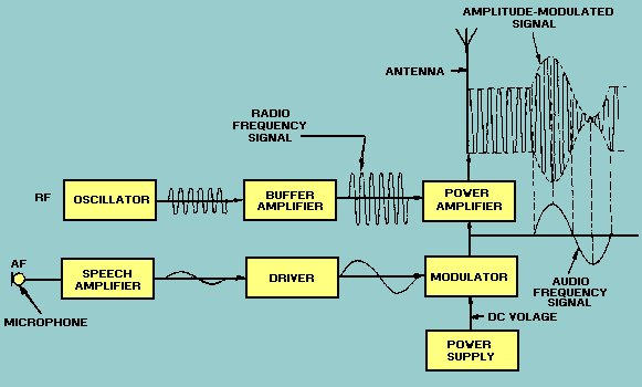

That figure probably refers to using this tube to drive the modulator stage of an RF transmitter. To drive an AM transmitter of 1kW you need an audio amp of 500W (if my memory serves me correctly).

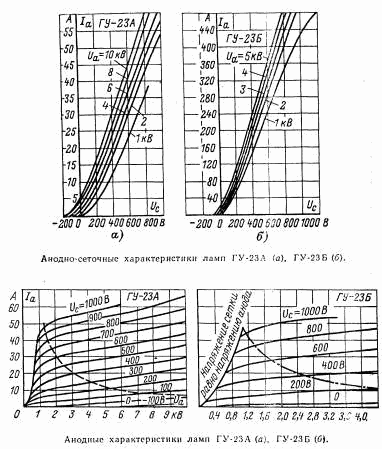

Nice small signal triode there Waveborne
A piffling 60KW anode (plate) dissipation... not in the same league
I always wandered, why do they waste so nice curves to heat steel on plants?
Something like 2.5 KV / 25A would be a nice SE idle point.
I would love to see the 10 and 20 KW versions!
