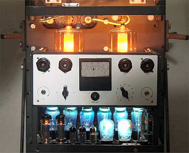

1000W tube amplifier

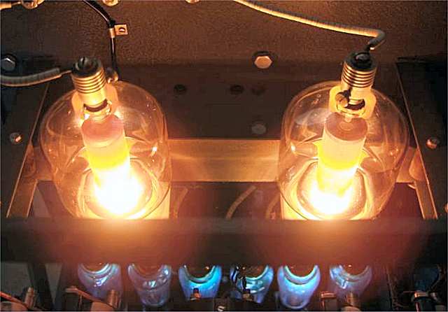

Philips EL6471 with QB3.5 750 as end tube. This a cool amp😎
YouTube - 1000W Amplifier Philips EL6471 at full power
YouTube - Philips EL6471 playing stereo part 3
power test glow QB3.5
YouTube - Philips EL6471 3,2 Kv on 250 Ma
more music
YouTube - 1kW Philips EL6471 Tube Amplifier from 1955 demonstrates its original sound - listen!
Enjoy

Heaters at 5V at 14A! Might be a task for an old PC power supply?
I have a couple of these tubes if anyone wants one for experimentation, nice bottles in Pyrex glass (I think) and lovely solid graphite anode.

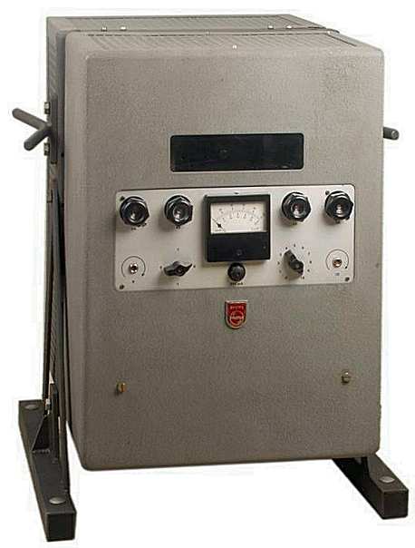

This Philips EL6471 Power Amp is the smallest one , there is another two model with 10 and 20 KW of out. power .
Found in Philips EL6471 design two characteristic typical solution :
1) Use of three phase PSU ,which is typical for professional Audio power amps when input power consumption exceed 1 KW .
2) Use of two EL34 (triode strapped) DC coupled drivers for two QB3,5/750 output power tubes to obtain the best audio performance,output power efficiency and rock solid output power stage stability .

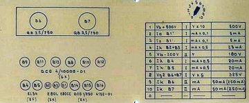

Hi Sansuii !
My hat down for your Gu81 Amp ! :up:
I never made really serious schematic analysis of this Philips Power Amp but I guess that -3 value is about - 240v , but not 100 % sure since the -3 Voltage network include strartup/protection 60sek. thermorelay B16 .Any way schematic Nr. 2 (with SS HV rectifier ) in that pdf file is more accurate than schematic Nr.1 since the secondary S4 is shorted over SS rectifier via S4 CT in schematic Nr.1 ( error in drawing ) .
All the Best !

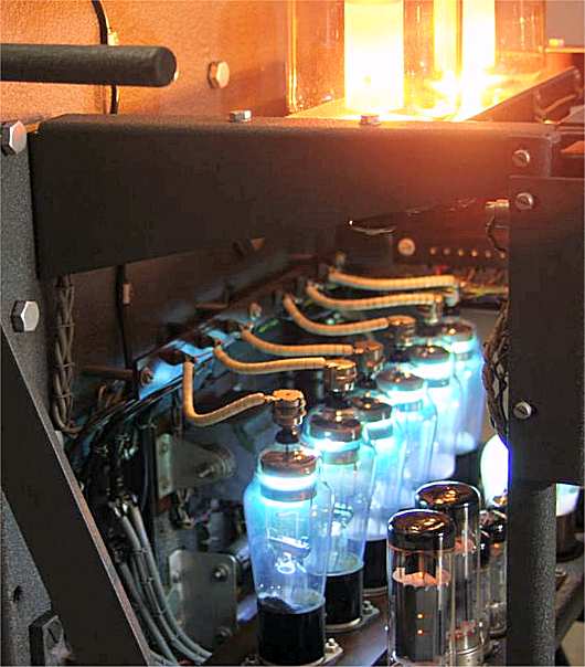

Sorry but until yet I have nothing else except the few more picture of Philips EL 6471 1Kw Power Amp .
Best Regards
