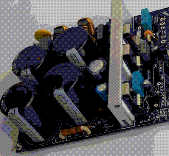

Specs
Input voltage 110 or 240 / selectable
Output voltages:-
+- 53, +-64, +-78, +-93, +-104. (Unregulated)
AUX1: +-15VDC (Regulated)
AUX2: +-24VDC (Unregulated)
AUX3: +18VDC(Regulated)
ALL AUX voltages can be changed.
FAN output +16VDC
Power: 1000W cont, 1800W PEAK
Size 12.2CMx 26CM
Protection: UVLO, Thermal, Over Current, Short Circuit.
Samples are available.
Any other information is available on request..

1. Of the 1455 different fans that Digi-key has in stock...none are 16V... ????????
2. How much current is available for each of the supplies...kind of important information.
3. How "unregulated" is the unregulated supplies?
Just curious.
Just curious.
Just curious.
1- You can use 12V fan, because there is a resistor in series. or use the third AUX 12.8VDC.
2- 16 ~ 18A for the high voltage outputs
3- google it and you will know, because I dont know 😉
