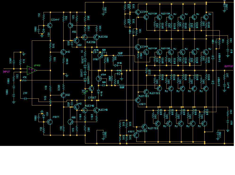

Seeing as you are inviting opinions 😉I've found this schematic and I think it is awesome design. It is very popular project in Balkan region. The design is by boro.
What do you think about it?
As has been mentioned, there is no way this amp would stick out 1KW 4ohm clean even with a fully regulated supply. I must admit i like the idea of all N channel mosfet amplifiers but they lose out on efficiency due to fair sized voltage drops on both positive & negative rails. This is due to the gate voltage of the power mosfets.
It's simple to cure the problem on the positive rail, simply use a higher rail voltage for the drivers. Try sussing out a way of doing it on the negative rail though 😀
Taking the positive rail, this beast first of all drops 0.7V via the diode feeding the front end & Vas, then another 1.4V accross the Vas constant current. Another 0.7V accross the driver & at least 4 - 6V or more driving the mosfet gates (more nearer the positive rail) & then drops accross the source resistors.
It's a fair design, pity about the MJE340/50 though... I'm sure there must be better than transistors than those for Vas duty, why not use the MJE transistors that are used as drivers - they are miles faster.
Then how can I make 5000W amplifier?

The design is very good.
VAS could be a faster device, sure. Small potatoes.
Split drivers is a sensible and common practice in very high power amps. It does not create any matching issues; bipolar Vbe differences are much less than Vgs variations in the mosfets they are driving anyway.
Compensation looks to be very well sorted.
Should measure quite well and would definitely sound very good with a small excess of even harmonics over odd.
Agree it may not do 1000W. Let's just say it will easily do 700W. That's almost one horsepower, should be enough for all but heavy metal vampires?
Give the design some credit guys, instead of picking minor faults. High power amps are extremely difficult to stabilise for all loads, and Dr Bora has done a really good, textbook job here.
Congratulations, Dr Bora!

If anyone is even considering that amp (it would work with some effort and refinement) build this instead. It *does* work - I have three of them.

"You all people just talk about every design that it is not possible to deliver that amount of power "
I think we know how to figure out what is real, and what is fiction.
Do you?
I can think of several amplifiers rated in 'Euro-watts' that are somewhat real, if you do a short tone-burst at 1Khz. They might be rated at 2KW/2R with ±115V rails. In reality they deliver 50V RMS into 2R (over frequency).

I don't think the OP is really interested in generating a new design pro amp. The realities of professional sound require the ability to squeeze major power output from often goofy line quality and it needs to be light, so switching topologies in every power circuit are a practical must. But if you are instead looking for pro amp power in a more hi-fi scenaro that will rarely move around there are definitely some things that can be done. Anyone willing to spend for building linear amplifiers around 1000W output single channel might see decent sense in installing a 50A 220 service in their listening room.
+/-126, I mentioned that earlier. Drops to +/-88 with 2 ohms at low frequency (where it matters) and put out about 1500W. Those chassis contain one channel. Compare to the Crest 7001, which puts out 1400W into the same equivalent load (2 channels 4 ohms each) with similar rail voltage. We're all up against the same laws of physics. It's just about the most you're going to get off one AC socket anyway. I also have one unit which runs two channels of the same three trafos. It measures just short of 800 w/ch at 4 ohms.

well, it is a "500watt amp" if you consider the usual 8 ohm rating...
As you drop load impedance the losses through the resistors in series with the Mosfets start to look bigger, fwiw...
