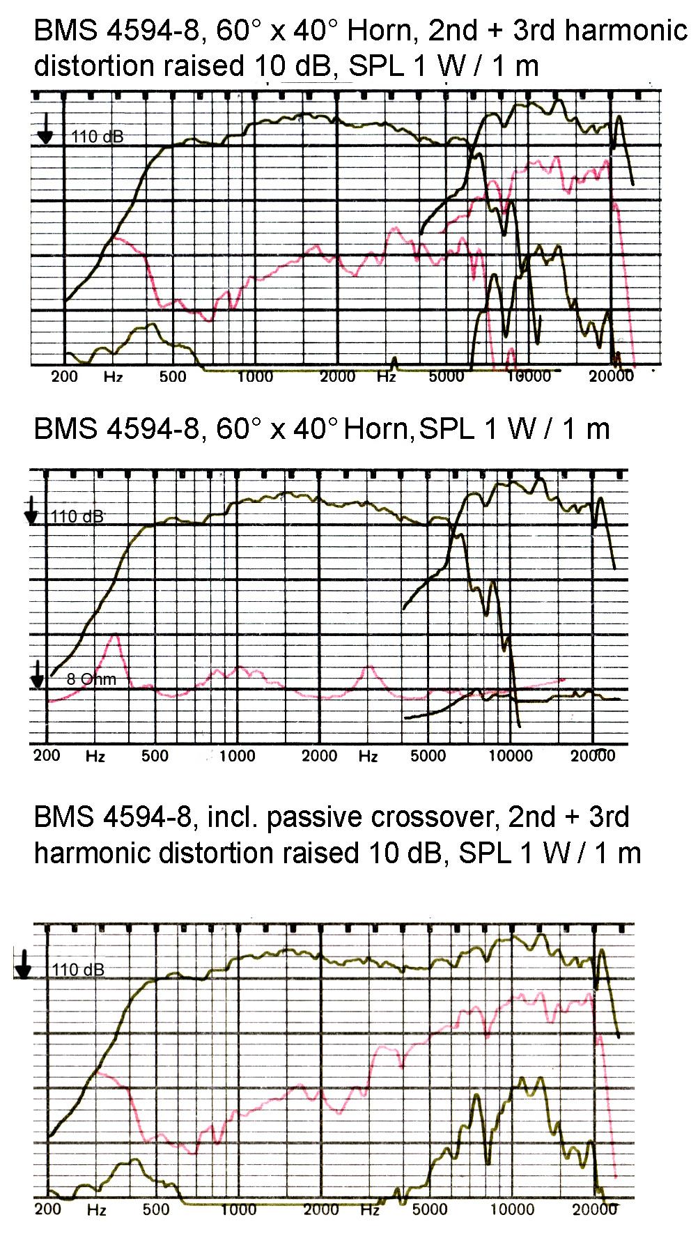

A question for you guys..
Can we do some adjustment to l20se to make it better suit for high frequency reproduction because in my case 2 of them should drive coaxial compression driver with double diaphragm,one for HF 150w(3.5" voice coil) 700-5000Hz and one for top end 80w(1.75" voice coil) 6000-20000Hz.. active crossover would be used to drive amps too.

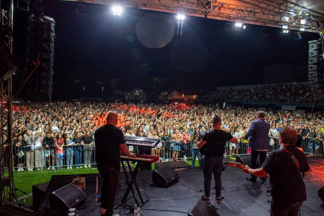

Its not 1/8 I will test woofer, but I have tested RCF hdl30 that specifies 300w power input and it consumes max 350w with limiter blinking at full, without limiter around 200w they say it has 1100W rms of amp power and 2200w peak. Its loud box, we have done stadiums with 5-10000 people with 8 of these per side and 8x those rcf 9007 woofers , hdl uses nd940 compression driver and 2x 10" per cabinet.
Will test woofer soon also..
