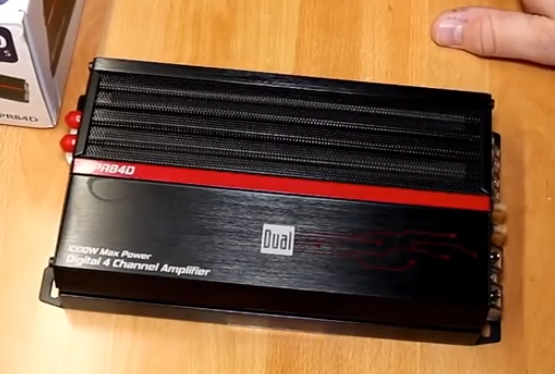

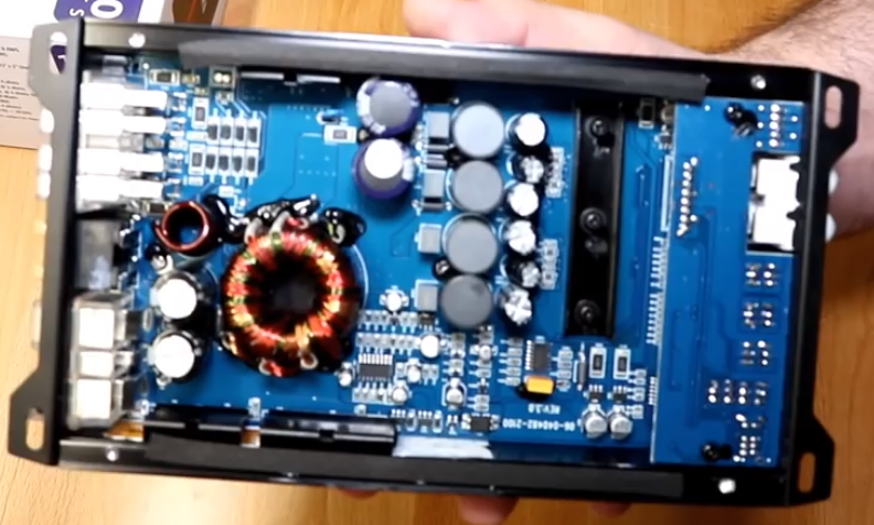

I have a DUAL XPR84D 1000 watt amplifier (4 channel amplifier to hook up 4 speakers)
running it in stereo with two speakers. not bridged.
speakers are 4 ohms
amplifier rated 80W RMS at 4 ohms per channel. 120 watts RMS at 2 ohms per channel. and 240 watts RMS at 4 ohms bridged
my old amplifier had slight distortion/buzzing at low volume with my computer volume set high. unless I turned the amplifier to 100% and my computer volume low.
so I decided to use the bigger amplifier which doesnt have that problem.
but i want to know if its ok to hook up to the larger amplifier. no bass boost. full range. the speakers are rated 40 watts RMS each and 80 watts peak

80 watts should be a good match as long as speaker isn't over driven/heated by the program material. (the woofer voice coil may be 3/4" - 1" diameter) What are you using for the power supply?
its 1" diameter
im using 1000 watt 12v constant current constant voltage power supply 84 amps set to 14.4v with super capacitor bank hooked up.
I dont turn it up past the point of audible distortion though. just room listening volume or a little louder if I want some more bass
with the speakers at maximum excursion with no audible distortion they are only getting around 12 watts RMS each.
