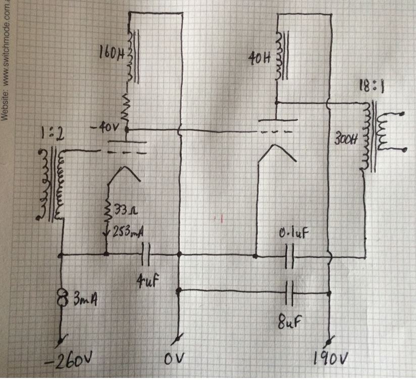

If you want to really build an oldish amplifier I would suggest the 71A tube. Still around at modest prices!
Agree, but use UX-171 or CX-371 thoriated tungsten version with type 112 as driver, all introduced in 1925.
As it happens, I am currently building this amplifier, see attached (re-size 0.1uF accordingly).

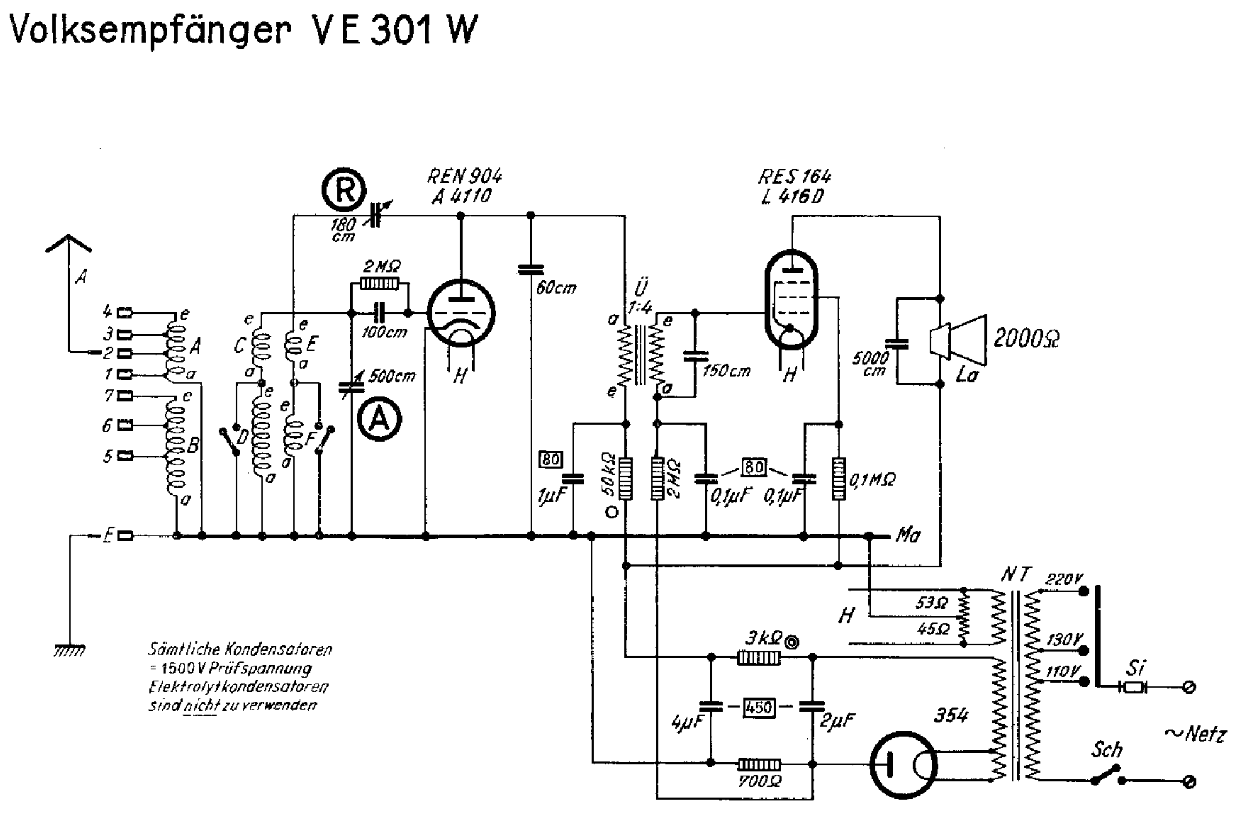

I still don't have the UK wartime civilian receiver on my collection, but I once tried to use my 1933 VE301W Volksempfanger as computer speaker. The audio quality is suprisingly good, for a device of this kind and age. There is a very noticeable hum, and high frequencies are muffled, but music reproduction is markedly better than the average compact inexpensive portable bluetooth speakers of today. Maybe even marginally better than the built-in speaker of some TV sets. This is a bit sad, in a sense.
Hooking up the VE301W to a standard audio source is very easy and totally reversible. Just remove the RF tube REN904 and connect the audio source on the tube socket with standard mini banana plugs. A 630V capacitor must be connected in series with the audio signal. This cheap radio has a true power transformer, so the chassis is safe to touch. It does even have a mains fuse: a far more safe design compared to USA midget radios of the same period.
The first Volksempfanger is collectible also because the cabinet was the work of a industrial designer; it was very modern and the shape is still peculiar and interesting. The radio part instead was old fashioned and low performing - this was probably a deliberate decision. I am unable to receive any radio on my specimen despite a 3m wire as antenna. The VE301W was followed after a few years by a smaller and cheaper version with dynamic speaker. This smaller later type is the most common one.

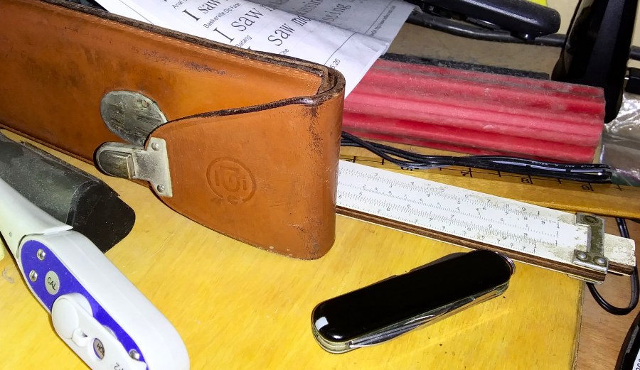

Slide rule still used here. Attached picture taken today.
The filthy Acu-Design (Chavez-Roos) is a bit wobbly but fine for electronics. The leather-holstered Dietzgen was a fine stick but someone broke it and glued a face on WRONG. And is really more stick than I need.

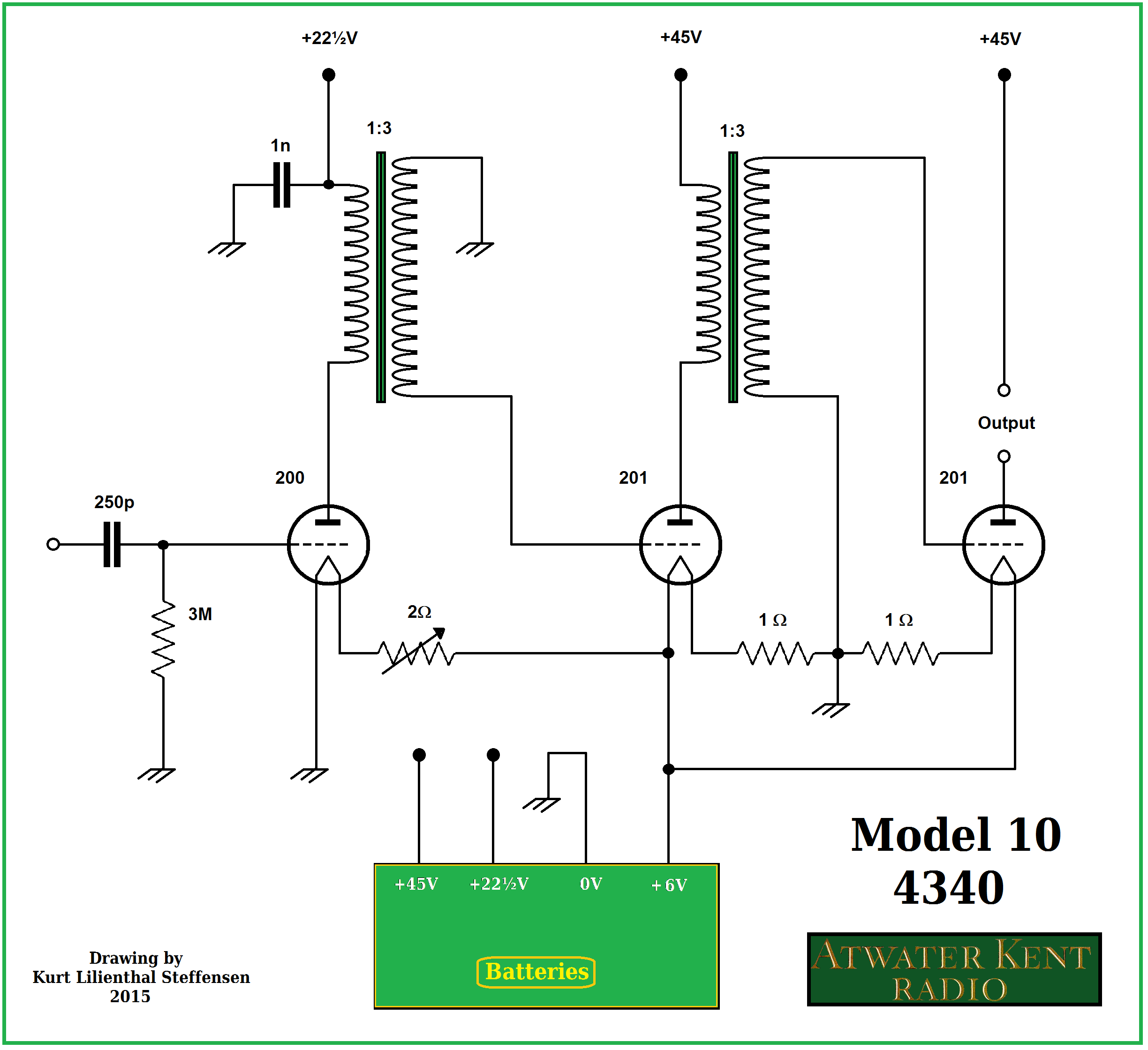

I found this schematic of one of the first commercial amps on the market in the 1920s. I would be interest to hear some comments on how this amp may sound / function. It looks like it would be expensive to build based on the inter-stage transformers. There really isn't much to it.
Much of the signal gain is being done by the transformers? It looks like they were designed for gain as well as coupling? This has to be a very expensive high end transformer for a modern hifi response curve. i Realize this was not a design consideration 100 years ago. This is no longer done because caps are much cheaper and tubes are better today? I have seen some very high end schematics where they boast no caps in the signal path, same simple 100 year old design basically. Usually with 2A3 or 300B, but when I look up the transformers used they are VERY expensive.
