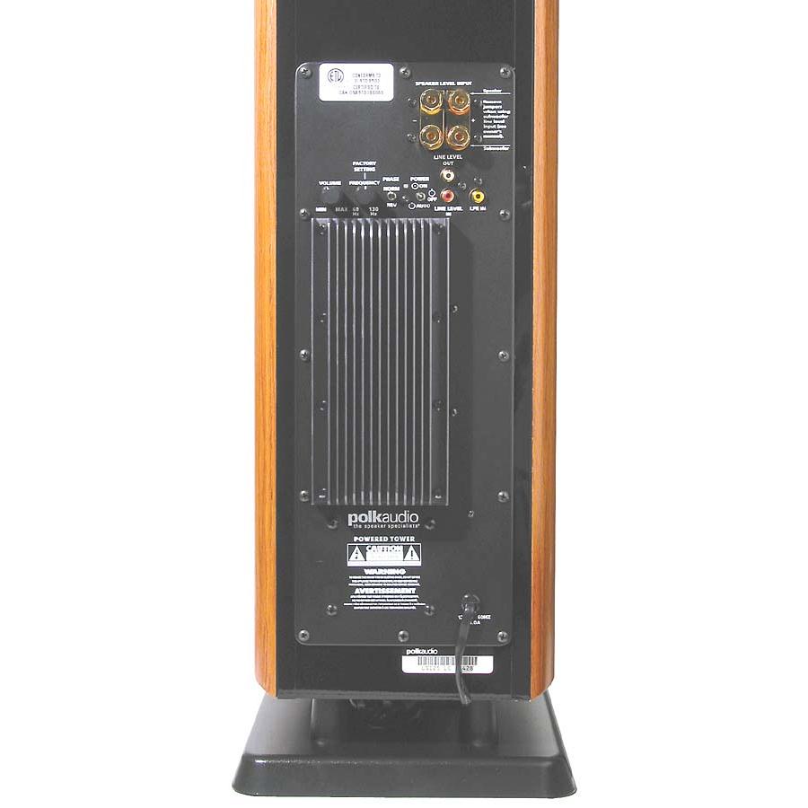

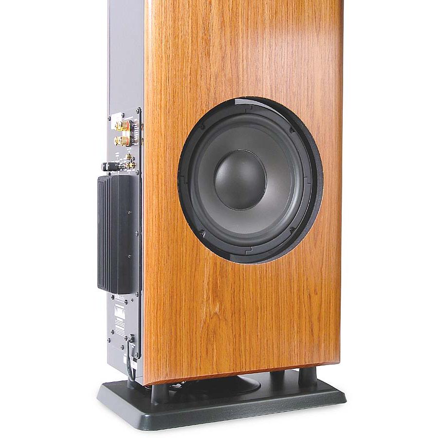

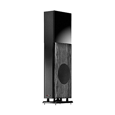

Thinking of woofers pairs...
Polk Audio LSi25 😀

And side firing woofers goes to trash w/higher crossover point.It looks like the 2 driver combo wins.
