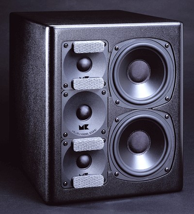

Getting back on tract maybe crossing to a 10" woofer around 1200hz might be better accomplished with a small array of tweeters. Say 3.
Think I saw an M&K monitor once that did this. Might power taper the outside 2 tweeters and lowpass them so they were helping more with the upper mid range, sort of an MTM using tweeters?
I think 3 relatively inexpensve tweeters might work then for the 1200hz crossover.
Not at 1.2KHz!... and if done properly at 1.7KHz or so, would require complex Xover circuitry. IMO adding more cheaper tweeters makes issues much worse.
What is your expectation for a 10" 2 way other than desired Xover point? Are you going to do the Xover design for your creation?
