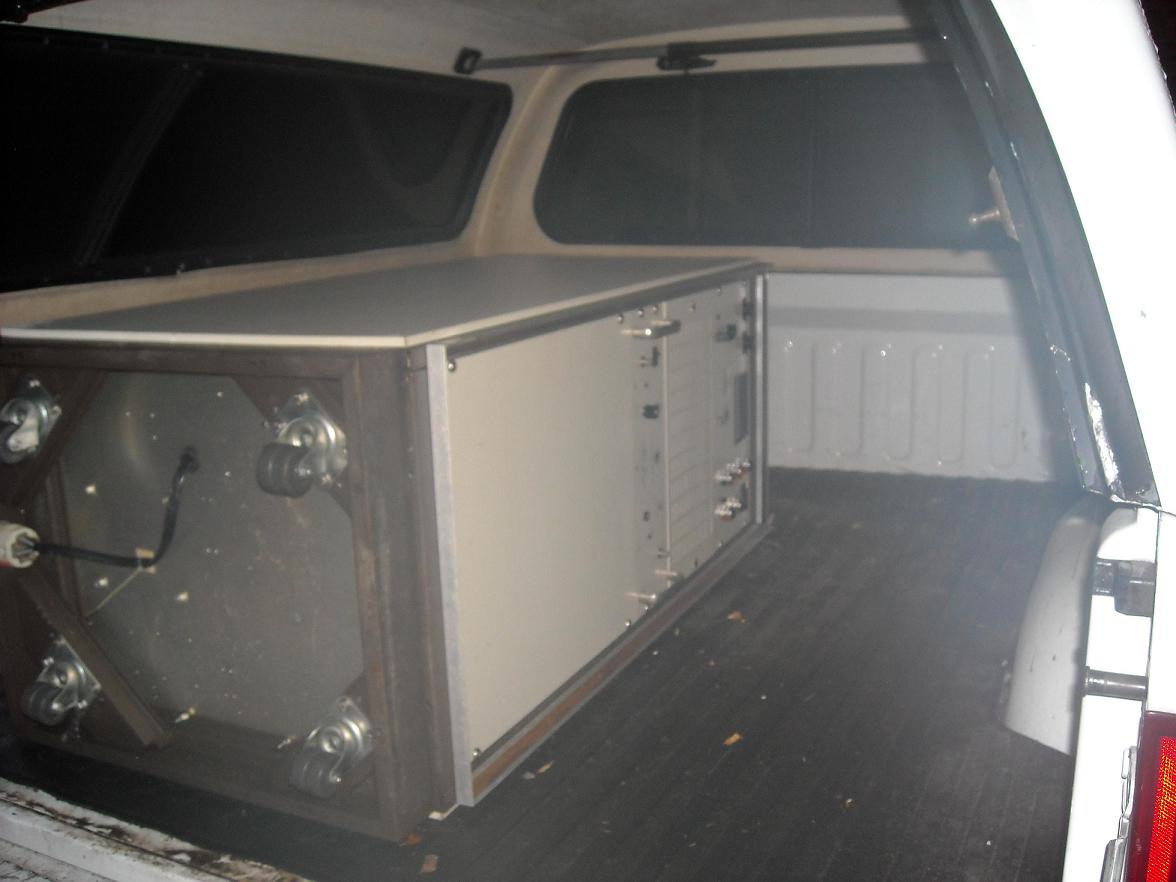

For a change of pace I picked up this behemoth today for free, well three of us almost busted our guts putting it in my truck if that counts as payment.
DC to Light with 2GW output .....
Ok, I lied.
Only 0.015 to 250MHz at up to 200W with 6 tubes in the output. I have no Idea why I got it other than it was to save it from the landfill.

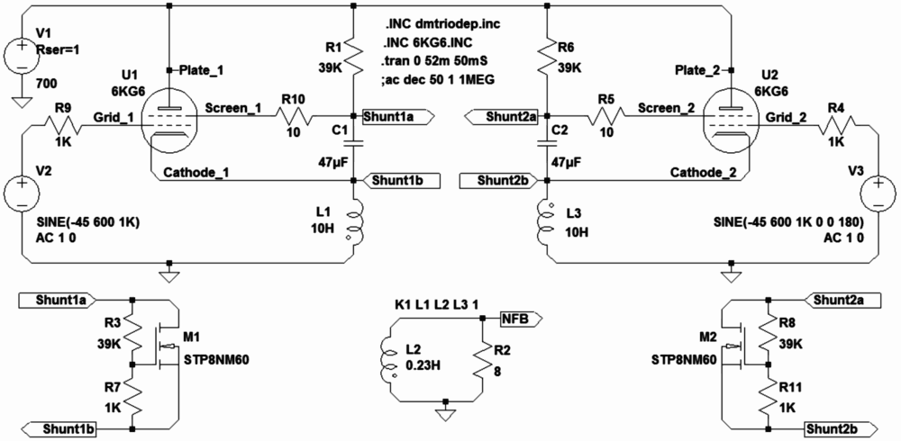

Latest deceased and undesisted horsefloggery:
You might notice the shunts doing *nothing* ???
But thats only at full signal. At lower volume the
idle current would climb insanely high without...
Still this is like 70What?s idle plate dissipation!
Tubelab's drawing crossed plates at 84W...
Don't even want to think bout 980W at peak,
and nothing about peak figure been changed.
Screen bootstrap swings about 80V over the rail.
Min cap value empirically chosen by running sim
20Hz and see what keeps crossing glitch at bay.
G1 drive now totally in A1 with -10V to spare...
G2 currents about 60% what they used to be.
Not sure how G2 got more efficient?
So, is this follower "augmented" at the screens?
Or does pure pentode mode not count?
