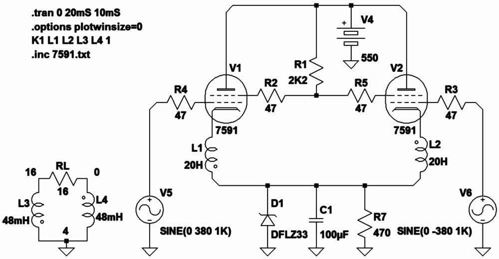

Regarding the 10 pounder: Do you think those extra 6.8V windings
could handle dancing to the tune of push pull cathode followers?
Roughly along these lines? I'm not yet sayin its practical to drive.
Just asking if heaters to cathodes is manageable problem or no?
No center tap on two out of three. Resistors???
Do you think those extra 6.8V windings could handle dancing to the tune of push pull cathode followers?
Only testing will tell. I built a P-P cathode follower. It works and has some serious bass. I used an Antek toroid for heater power and simply tied one end of each winding (one heater pin) to the cathode.
Yes it was drive voltage limited, but this is a case where you can run a chip amp into a backwards OPT (resistor load about 15K) and get zillions of volts since no drive current is needed.
You can use a technique to keep the voltage across the tube constant to really reduce the distortion. See simulation. You can also build a full up "augmented cathode follower" which can be configured to have gain. A voltage gain of about two was about the max I could get before instability comes up.

I have several sims on my computer that all show that this is a viable idea. Yes I got carried away with the supply and drive voltages on some of them. It is too easy to build a killowatt plus amplifier in the simulator. The smoke doesn't smell bad, and the parts are free. The sound sucks though.
I built real working hardware about three years ago. I don't have the schematic here at work but the output tubes were 6336's (triodes) and the top device does indeed take its input from the cathode of the bottom device. I have used mosfets, triodes, pentodes, and agile SMPS's for the top device.
These were all experiments leading up to the Minitron amplifier design where the augie mosfet was replaced by a Microchip dsPIC based agile SMPS. The SMPS is modulated by the audio signal such that the plate to cathode voltage of the output tube remains constant, but the total heat dissipation is greatly reduced.
Well you could look at the design as a mosfet source follower with a tube in series with its output, or you could see it as a cathode follower with a noisy plate supply. The cathode follower has a high PSRR, so I believe it is the controlling device here. Keeping the plate voltage constant across the output tube removes its voltage variant parameter induced distortions from the audio signal.
MacDonald envisioned the augmented cathode follower circuit as a nearly perfect voltage amplifier and his applications were at low power levels. I built a few complete power amps with his circuits and they do sound pretty nice. All were SE designs, and I could not get any of them to simulate right. I still have one working amp. It's circuit doesn't match any of my sims though.
