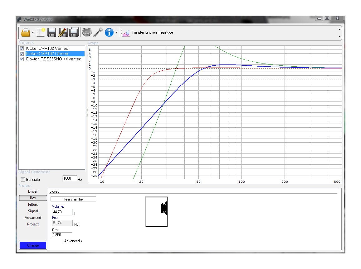

Here is a sim using WinISD.
I'm always a little concerned when companies do not give all thiel-small parameters ..... with kicker we a re missing a ot of information for a really good sim. No information on the coil Re, and therefore no sim of excurtion and SPL.
The driver is made for car audio, and with the two different suggested tunings; vented 70 liter/44Hz (green) or closed 44 liter (blue) you'll see that especially in the vented version you'll get a lot of output around 50 Hz, but not much else ..... will sound impressive, but very "one note" .....
For comparrison the new Dayton 10" RSS265HO-44 DVC (140 USD) in a 50 liter vented box ..... now this is much more subwoofer like. With 350 W input you will get impressive 107,5 db @ 25 Hz.
But in the vented 70 l box with the Kicker you'll probably get a lot more output around 50 Hz .... but nothing in the sub region.
It's all about use and taste.

That winISD looks like a great tool. I will look into downloading it in a little bit. Thank you for doing a simulation Baldin. That's strange the sub is only going to sound good around one frequency... Are there ways through different box building styles to change this? Because I just purchased the driver I want to use it but if it no good I guess I will need to try something else out.
