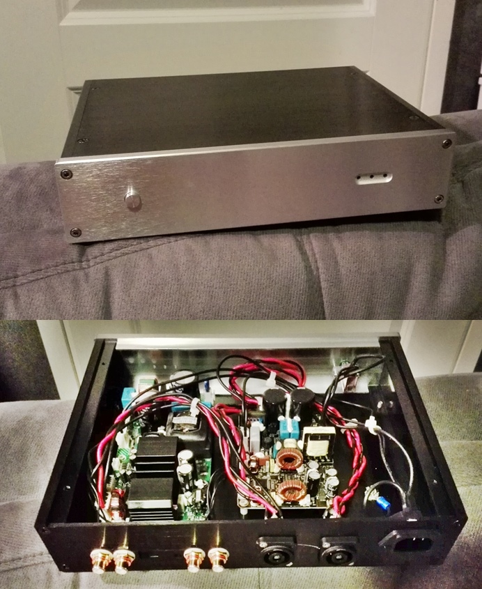

Heat buildup might become a problem with so many modules. Take care of good ventilation, or install a fan. I have 125+50 in a small closed aluminium case. Surface stays at 40C.
When power is switched on, capacitors suck lots of current, but after that ower consumption is steady and moderate. 3-stage sequential switch might be sufficient.

Thanks for the response, my speakers are over 100db efficient so I am assuming heat should stay low, but I will def be checking to see how warm the case gets. The case I have has vents on the bottom, and top, but I am thinking of having a plexi top made with more ventilation if needed. The case is a Chinese Krell ksa50 case, and has a lot of room inside...a shame that I cannot use the massive heat sinks to help keep it real cool. The rack is an open air design, so air can flow all around the equipment with the amps, and preamp having at least 2" above them, and open front, rear, and sides all open.

ICEpower modules don't make much heat unless they get driven close to max W, normal use is same temp as idle. I keep my boxes powered practically 24/7, now for 5 years without problems.
