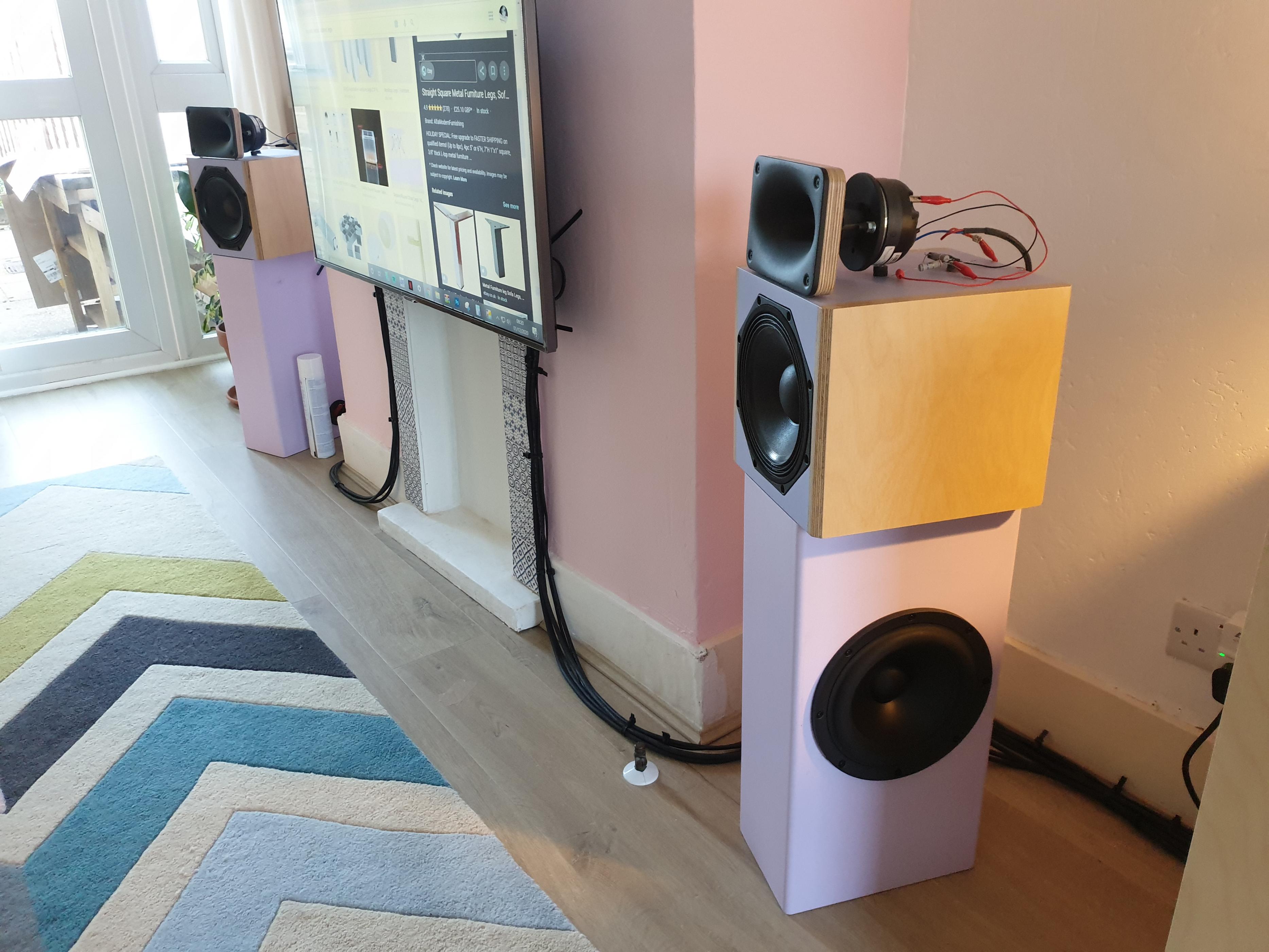

Hope you're all keeping well!? It feels like an eternity since I made some speakers (a year, in fact) so it's time to upgrade my system.
I'd like to try a 10" mid-bass and CD/horn as a step up from my current 8" mid-bass and CD/horn. I could potentially go to a 12" but I would have to be careful with WAF.

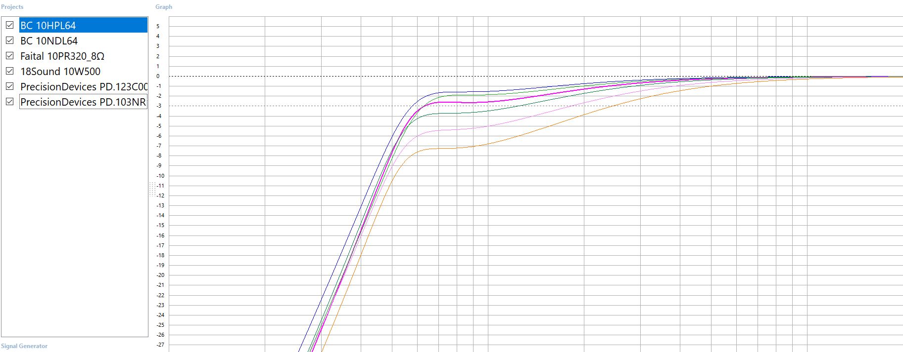

Rough sims attached. All tuned to around 55hz with 23-30L vented cabinets.

Attached is mid bass sims and a pic of my current setup where the subs have been switched off for the last 9 months.

Remind us please, what's the 8" that's in current use ?
Cheers mate, I'll do some comparisons. The set up is Peerless DFM-2535R00-08, Faital 8PR200 and STH100 Horn. Sounds really good but would like to try constant directivity with slightly wider directivity as my wife and I sit on opposite sides of the sofa so something that doesn't dull the top end on my side would be great.

well, for this kind of project I think the Faital 10PR320 8R is the better one compared to the 10FH520, they have a flatter response up high and get to 50Hz F3 in the right case. But Faital in general is a good choice for this kind of projects i think.
Yep, the lower Fs should help it reach lower frequencies, albeit in a larger box. The upper range looks easier to work, too, depending on the intended crossover point.

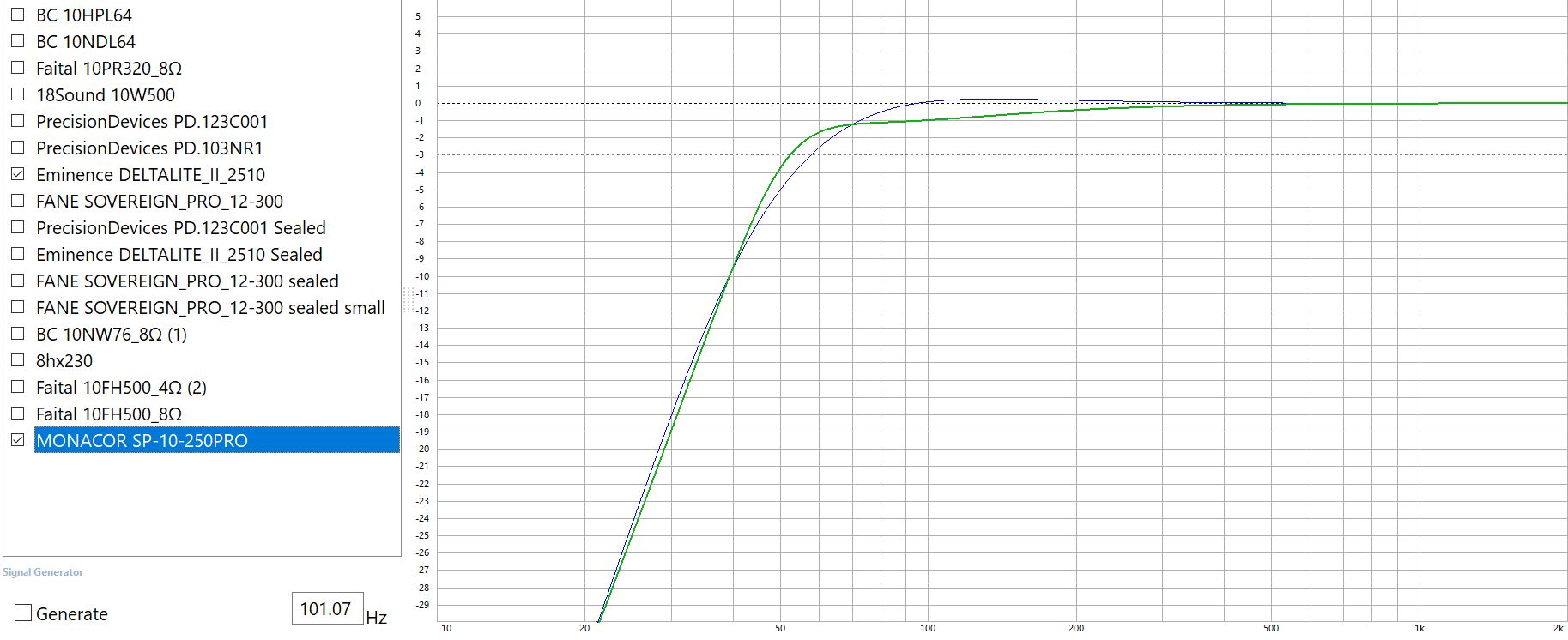

A couple of additions in 30l cabinets:
Eminence Deltalite II 2510 (Blue) - a nice curve but I don't think it'll get me lower than my current setup.
Monacor SP10-250PRO (green) - same as the rest really, nice EBS alignment but I can't find an awful amount on these drivers plus they are just as expensive as the more common drivers.
