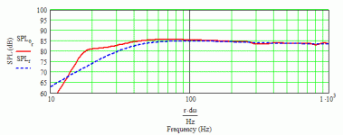

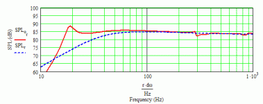

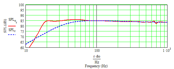

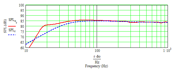

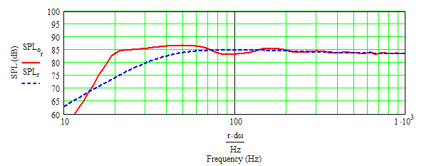

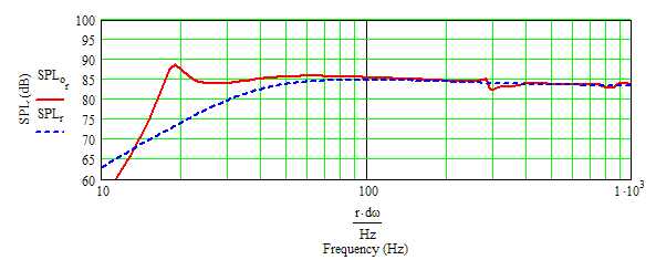

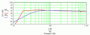

Regardless, I only know what the published specs imply, which is it theoretically should go down to a ~18-20 Hz Fb with decent performance overall in a MLTL whereas a simple reflex of a similar net Vb will ideally need a very long, well damped vent that will negate at least some of the large cab's LF gain BW in the process.
1st sim is an end loaded ~93” path-length [48” o.d. high] MLTL, 2nd sim is same with offset driver, vent. 3rd sim is same net Vb, tuning in a golden ratio reflex. All these sims use the same stuffing density. 4th sim is heavily damped reflex.
Of the four, the end loaded MLTL is somewhat better damped than the damped reflex and other MLTL and ~ an order of magnitude better than the reflex, so would be my choice on principle, though no clue how audible any differences may be, if any, once any driver specs variance combined with the XO and in room acoustical conditions are accounted for.
Note that some would argue that the 4th sim is probably the best for a typical room’s gain curve, but personally, I like to have as much acoustical gain as practical and attenuate if need be, lowering any potentially audible distortion rather than boosting/increasing it, or worse, running out of dynamic headroom.
You can probably attenuate the reflex’s peak with digital EQ, but it’s not the same as doing it acoustically, though down this low it may not matter, but then I’m a believer in acoustical solutions for acoustical problems, so prefer to ‘err on the side of caution’ just in case.
GM
Well that disagree with the simulation, which actually shows an elevate peak at tuning with a 20hz tune in that cabinet. Dont forget that the larger cabinet is much more efficient and needs less power, which plays into this drivers hands a bit as its more suited to that design.
See my 3rd and 4th sims, neither are flat to 20 Hz as you claimed and the 3rd sim is pretty much useless IME, so we for sure disagree.

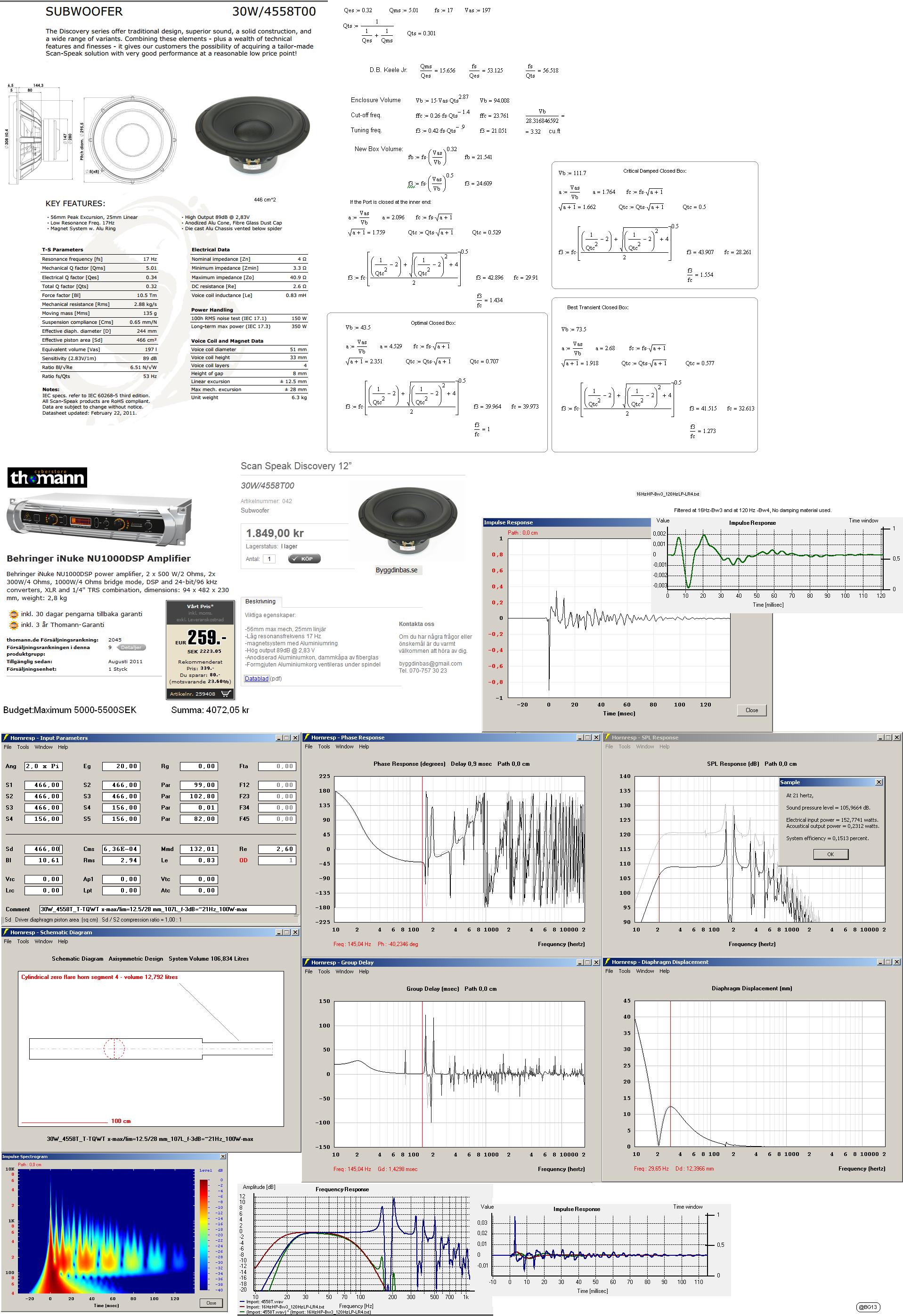

If keeping my current woofers is a horribly bad idea, then what else would you recommend?
I found the Dayton DVC385-88 for $309 with would fit well in a ~100l sealed box. -3dB at ~37Hz but since it has quite a lot of xmax I can EQ it down to 30Hz without problems.
Maxspl at 30Hz is 108dB.
If I manage to sell my current woofers for $150, buy the dayton for ~$320 including shipping, a Behringer iNuke3000 for $360 and a MiniDSP for $180. Cabinet material another $150 and it's a total cost of $860 which is... Quite much for me actually.

If I was in your shoes, I would assemble a single, isobaric, 6th order bandpass box, incorporating both of your existing drivers.
Front chamber 15l, tuned to 40 hz. Port = 1.5" x 4.4"
Rear chamber, 45l, tuned to 20 hz. Port = 2" x 11.6"
You could use one of your existing 45l enclosures for the rear chamber and then just build around it.
This would give you a rising FR arch starting at -3db at 62hz, up to +5db at 30hz, rolling down to +2db at 20hz, with an f10 of 15hz.
The only questions I can't answer are; can you fit one driver and the port into the 15l front chamber, and can you hit desired SPL without rocking the excursion?
It would cost next to nothing to try it, and it would be fun.
I can post the WinISD graph a bit later.

It looks like it would give me quite poor maxspl though, and group delay seems high too.
