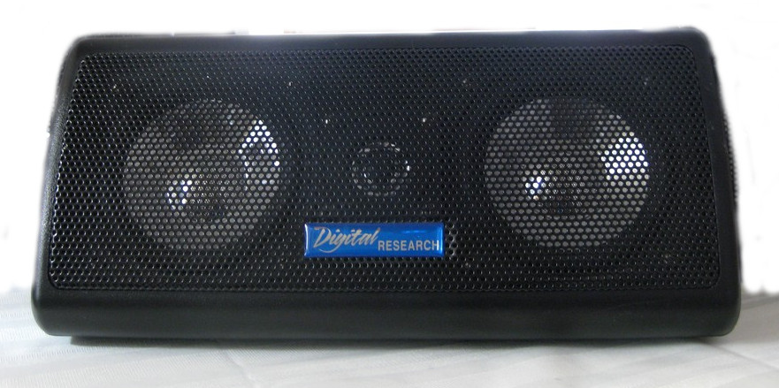

My most recently acquired cheap speaker is a loaf-of-bread sized Digital Research thingy, with a pair of roughly 4" aluminium-cone speakers and a tweeter in a D'Appolito (aka MTM) layout. It cost a whopping $5 at a local thrift store, and last night I found out that it makes a quite passable small guitar amp when connected to a cheap class-D power amp board with a Danelectro Fab chorus as a preamp.
I might hook up a 20-volt cordless tool battery and package the lot up as a grab-n-go portable guitar amp.
Never heard of Digital Research? Do an Internet search for "white van speaker scam", and you'll quickly learn more about the antecedents of this, err, world-famous luxury brand. 😀
Wikipedia even has an article on the "white van speaker scam": White van speaker scam - Wikipedia
-Gnobuddy
Five dollars. And it works. Everything I have (mostly) came from a thrift store or garage sale, so yeah: that's a pretty pig!
