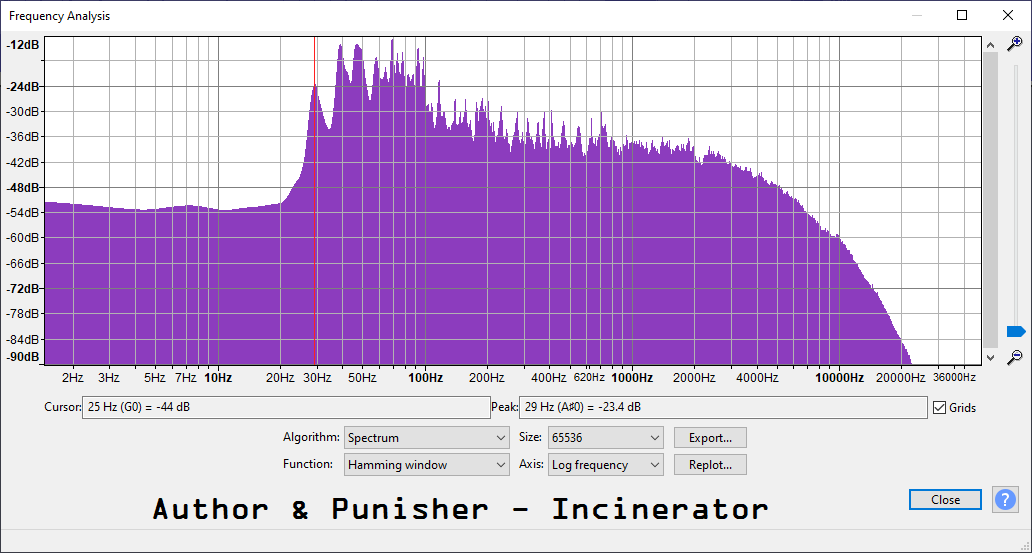

Here's my first attempt - very crude, not really seeking to prove anything other than satisfying my own curiousity.If I ever had the time...
Mainly using music that I've previously purchased on Bandcamp, downloading the .wav files and dropping them in Audacity.
Any feedback on the method used is welcome:
Author & Punisher - Incinerator
Peaks under 50Hz are: 47hz -14.3db, 39hz -14.0db, 29hz -23.4db and 25hz is -42db

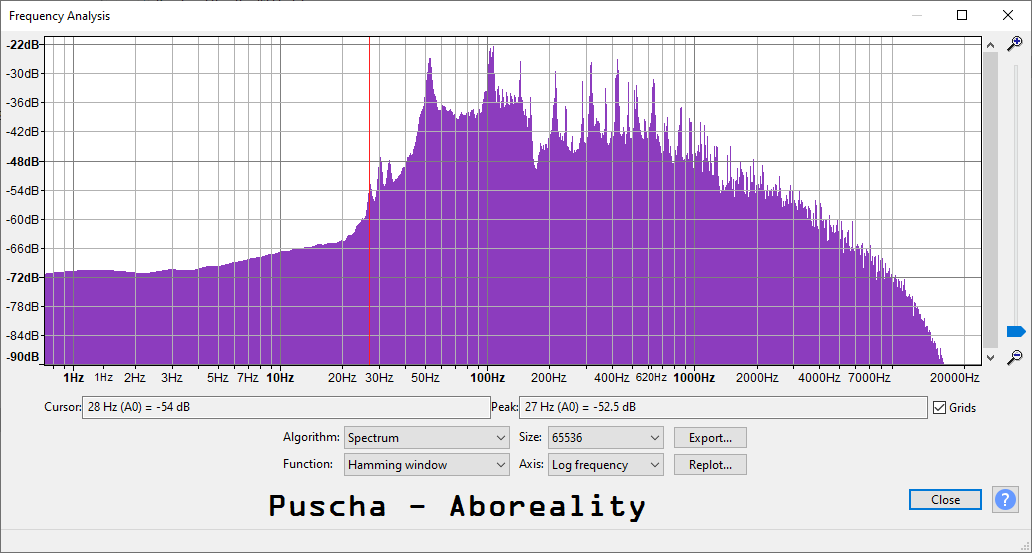

Puscha - Aboreality
Peak at 53hz is -26.6, 30hz is -47.1 and 27hz is -52.5

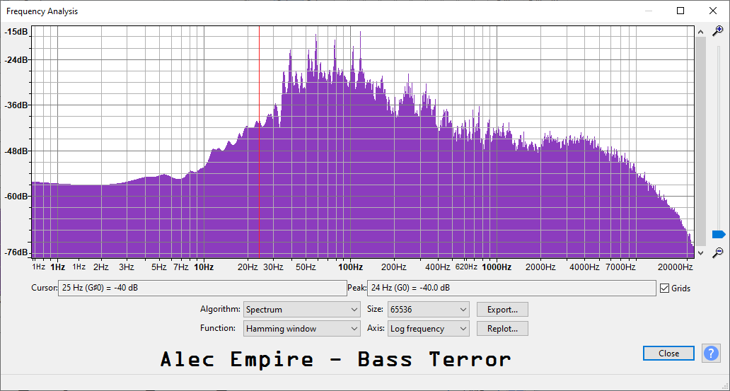

Alec Empire - Bass Terror (tbh I didn't expect much bass from this rough 1993 recording)
39hz is -21.4, 31hz is -35.6, 23hz is -40

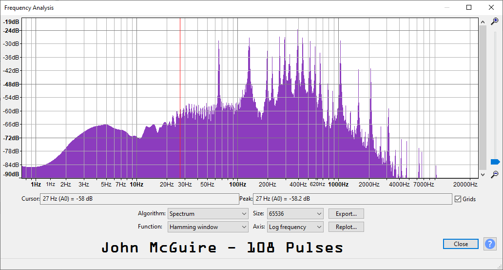

John McGuire - 108 Pulses (1975)
Peak at 65hz is -27.6, 33hz is -56.1 and 25hz is -59.8

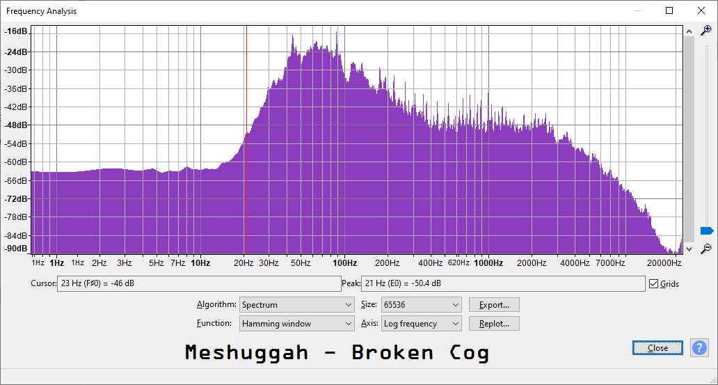

Meshuggah - Broken Cog (purchased this single track only from qobuz)
44hz is -21.9, 31hz is -34.6 and 25hz is -45

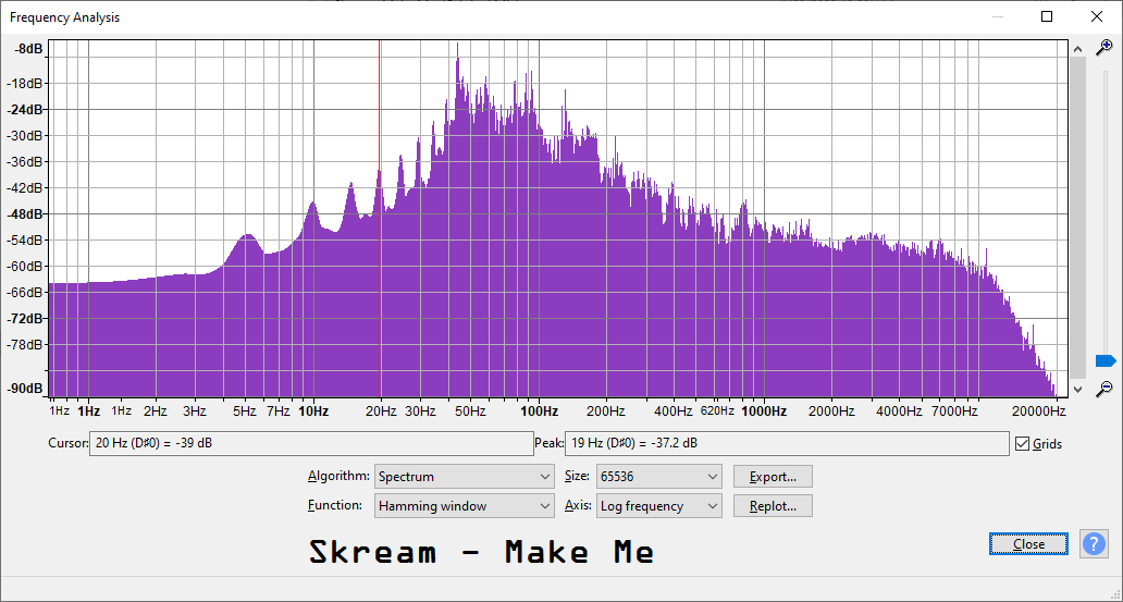

Skream - Make Me (purchased from Beatport)
44hz is -8.2, 29hz is -30.5 and 19 hz is -37.2
