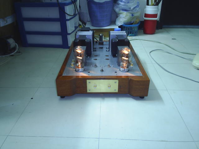

i build 10y preamp with intersatge but hummmmm how can i do
my circuit is
b+350v
r cathod 1.2k
tango its 10k
thak you
DAY
The 10 tube's filament supply is 7.5V 1.25A. You probably need two 12V car batteries and DC regulator to get it down to 7.5V.
I think it is just impractical having two big batteries next to the line amp. Also, you need to recharge them everytime after use.
If you use regulated DC supply for the filament, it should not cause too much of hum. The hum probably from either B+ or induced from the magnetic leakage of the power transformer and choke. It's much better to have a separate power supply for the line amp.
Johnny
Hi Day,
Are you using IC regulator for the filament circuit? If not, you need to be very careful on the filament voltage. Probably you need to put an RC filter for the filament for limit the voltage to the correct value and it will provide better filtering for the filament.
Johnny
