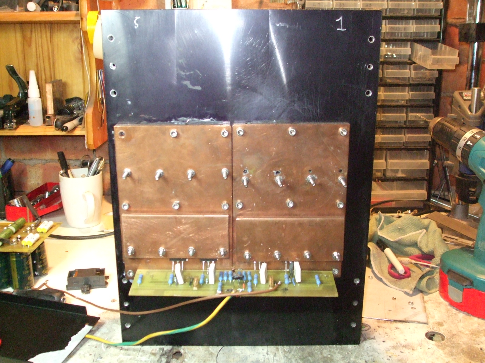

Hi tinitus
I had mine 12 X 16 machined after the extrusion as is normal that the surface is not flat after the extrusion
To get the heat spreaders to match the surface of the sink is not that difficult it just takes loads of time patience and elbow grease
Just get the spreaders as flat as you can starting with coarse emery cloth stuck on a flat surface and then down to 600 grain then polish the lot so is like a mirror and then start rubbing the heath spreaders on the heath sinks with carbide paste then paint scratch remover and at last bicarb of soda.
Once is all done and really clean the heath spreader stick to the heats sink as if it was magnetised (obviously as you making a vacuum as copper and aluminium magnets do not exist in this continuum).
Say about 10 hours work.
Graphite thermal paste when you bolt the 2 together.

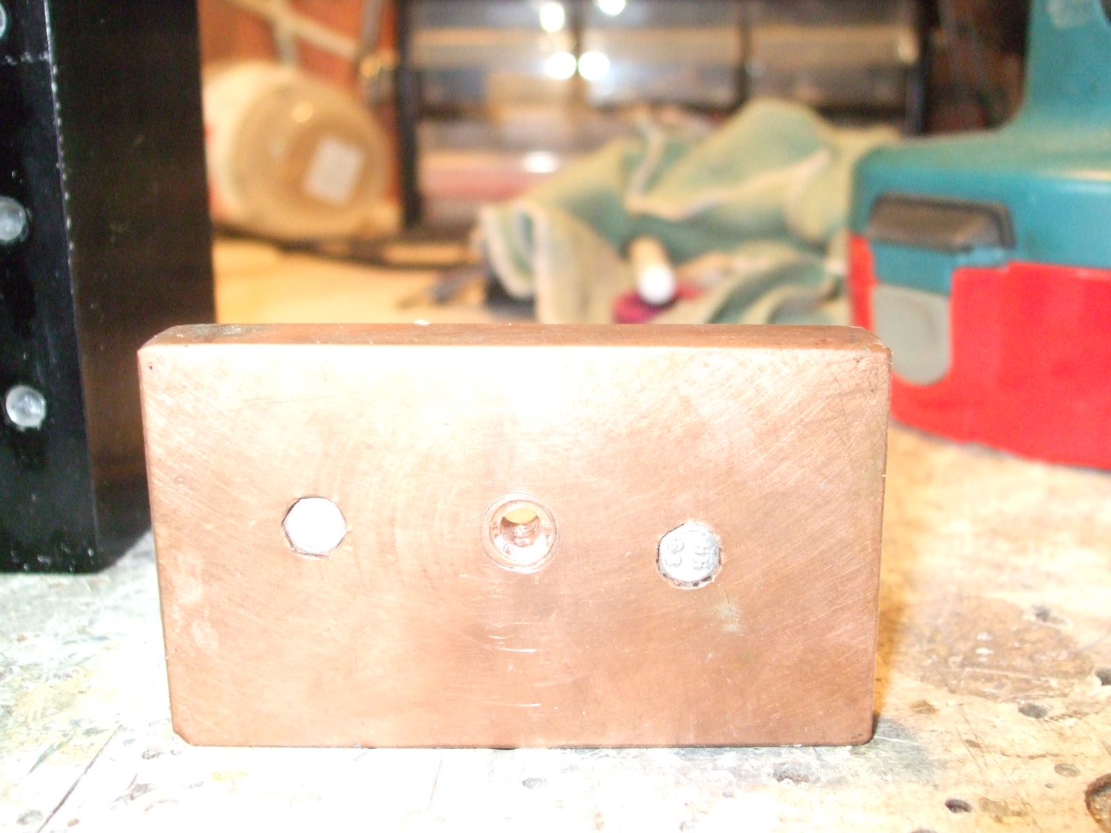

Main advantage is that I can use trough bolts with the heads buried in the cooper spreaders and clamp the mosfets with those
Gives far beter torque on the nuts securing them than if you where using the single screw and if you strip a tread just knock out the bolt and refit.
I am using Kerafoll and from the graphs in the data sheet the thermal resistance drop with increased pressure.
With about 200 W thermal load on the sinks they run at about 42 C with the mosfets at about 60 / 62 C on the top of the case.
Picture 1 of heat sink & fitted spreaders and 2 of details on how bolt are fitted
