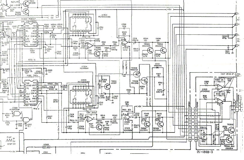

...Denon's DCD-920 has a 100uF elco used as output coupling cap.
That's C318 and C319 in the attached schematic.
Your player should not be too much different.
(100uF non-electrolytics are out of reach, but I think you can try to replace it with 10uF, or several in parallel. That would raise the cutoff frequency by one order of magnitude. If it is from 2Hz to 20Hz, would it be audible? but phase is impacted too... up to you)
By the way, the schematic shows some 200pF too (eg C310).

Thanks for the tip with the DIY Loudspeaker store, they have 10uF MKPs, I will get one there and try it... it really seems to be the decoupling cap, but where to get 200p MKPs or FKPs ...
maybe the electronics pharmacy has some left, or ill take 2x100 in paralell.

Modding is done, i exchanged all mentioned caps to MKP Types, but when I power it up and put a CD inside, it spins up as usual but displays 00 00:00:00 and it seems that it cant read no CDs at all anymore
Has anyone a solution where i can start looking for the failure?

...ooops, sorry to hear this.
It is quite strange that working on the output stage causes this.
Did you really only modify things "after" ("downstream") the DACs?
(edit: sorry to add this, just in case: the DACs are the chips marked "PCM61"...)
I would investigate first of all the following:
--> Forgotten/incorrect re-plugging of cables when you reassembled the different pieces (you may have disassembled the player to gain access to the board where you modded).
--> Something wrong done to power supplies. Some short circuit that prevents some supply to work properly (check with a voltmeter that you have the expected output from the regulators, most probably 78Xx / 79xx types). Or check at pins 8 and 4 of the opamps, respectively positive and negative supply.
Do you observe anything else worth mentioning?
Components unusually hot (transistors, ICs)?
ICs that are "unusually" cold? (the PCM61 and the opamps should warm up a little bit, if not they're not-powered/dead).
Not easy to do a remote troubleshooting...

It seems like a failed fuse because of a little solder blob between two components (shame on me), the slide servo isnt transporting the Laser anymore and on the -5v control point i get +0.74V ... so there must be something wrong and one of the "ic protectors" is non conducting, guess ill rip that out and replace it with a fast blowing fuse and see what happens next, i will keep you updated.
working again
Thanks for your help Pilli,
everything is up and running again, it was a blown fuse and the CDP sounds quite nice know, I used intertechnik Q4 to replace the 10uf elcos and serveral other types of caps ( styroflex, and some ancient wimas ... i think they are mks) to replace the ceramic ones.
