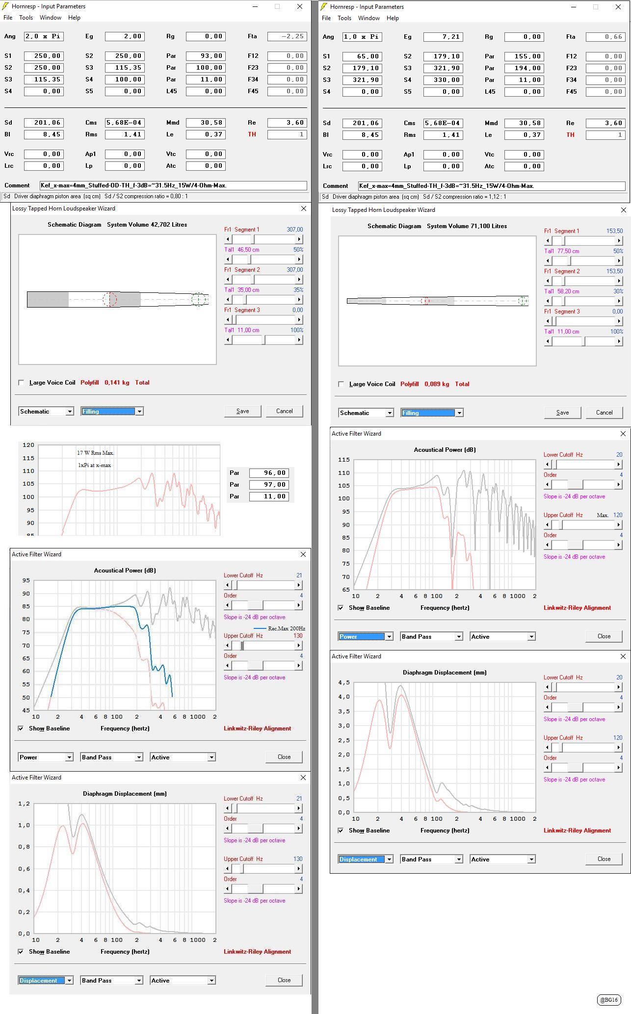

You can try fiddling around with the sliders and change all aspects of the horn to see if you can get that spike smaller or at least narrower (the narrower it is the less it will show up in a measurement, as most of it gets eaten up by box losses in the real world if it's really narrow).
There's two other options that will definitely work though. The first option is stuffing. That will eat that spike right up, and Hornresp can sim stuffing. In one of the first tapped horns I made I put very light fiberglass stuffing in the first few feet and that spike is completely missing in the measurement - it would be nice if I could remove some of the stuffing as I now have a dip instead of a spike but it's inaccessible. Stuffing is a net loss though, so avoid it if possible.
The other option is to make the horn larger. As the horn gets exponentially larger (and still tuned at the same frequency) the spike will stay ~ the same size but the spl response over the entire passband will rise up to the level of the spike. This is a great way to go if you don't mind a massive box.
Other than that it's just playing with the sliders and seeing what happens.

As previously pointed out, it's much lower in reality and considering the number of folks who've successfully used/EQ'd THs, just not much of an issue in reality; but if you must, then do like Tom did with his first [and only] TH and use band stop filters [Helmholtz resonators made from plastic pipe in this app] to 'hammer' them down: https://www.google.com/search?q=dts...hWE4yYKHV6HDmoQ_AUIBygC#imgrc=9y2Uautj0VZYcM:
Note too, that selective damping in the right places helps to smooth out this out of BW, HF 'hash', which FWIW is the only actual horn loaded BW.
Bottom line, this is a ~two octave 6th order BP, so the XO should ideally be < ~131 Hz and preferably at least 4th order.
That actually hasn't been the case for the last three POCs that I built, when I compared their measured FR to the HornResp sim. Lower, yes. Much lower? No.
I think TD found other means to reduce the out of band spikes, so he no longer needed to use the tube resonators.
Best approach IMO is to go with a design that ensures that the first major spike occurs about an octave or so above where you plan to LP the TH, and then deal with it using the methods previously discussed. Partly stuffing the TH and modifying the alignment accordingly would probably be my first choice. Or maybe convert some of the volume @ S1 in a SS15 fold to be a resonating chamber tuned to the first spike's frequency...
The spike is only much lower in real life if it's narrow. If it's relatively wide it maintains most of it's amplitude.
IIRC the DTS20 also used a 4mh series inductor and stuffing (lining) so even his big pipe filters were not completely effective.
Ivan Beaver says the inductor is doing exactly the opposite of what you would expect it to, but I seriously doubt it, the effect of inductors is no big mystery. Danley DTS20
Yes, yours weren't reduced much, but then IIRC they weren't very well designed either if my understanding of how to design them is near enough as good as TD's. Regardless, there's been quite a few builds published here and on other forums that were pretty well damped before internal damping, DSP corrected was applied.
Bottom line of course is build it and see or do something else, but 'throwing away' this much BW? Better to just build BRs.

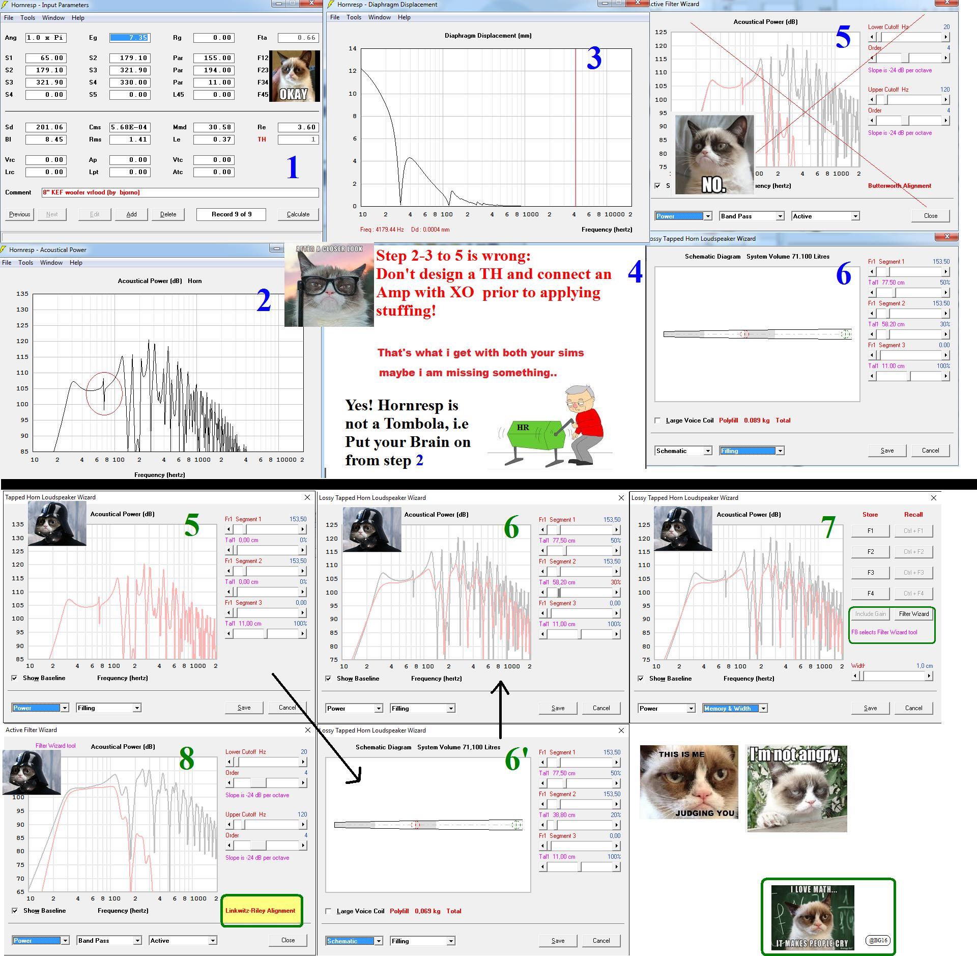

This really looks good, but for some reason I can't reproduce your results in my sim; did everything you've done and here's what it looks like:
That looks weird to me; I don't think it is supposed to be there.. What am I missing? 🙂
I think the combination of line level high pass filter and the amp's low-pass XO as well as some stuffing will do it. That's what I ultimately plan to use, at least for now.

Hi vrfood,
Grumpy Cat findings 😡
As usual here at diyAudio: A posted(TH) SQ disaster again:
IMO: All Quarter Wave TH HR plots should incorporate the use of Damping Materials 😎 if ever sent to 'Subwoofers', especially if in real life folded more than once.
b🙂
Hi vrfood,
b🙂
I like how you used the memes, LOL 🙂 But, can you please post the picture with better resolution? I can not see anything. Also you could post the Hornresp import file, so I can take a look. Thanks in advance
vrfood;4613414.. can you please post the picture with better resolution? I can not see anything...[/QUOTE said:Not needed: Just click on the expansion Cross at the lower left Corner of the Picture.
b🙂
b🙂
Thanks. That worked 🙂
